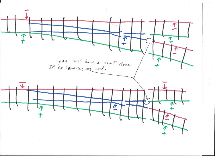

I did have a similar problem with Pico switches. On some of them the two inner rails past the frog are electricly common to the frog. When the switch points make contact to the stock rails, they will pic up power from them by way of little wipers that attach to the bottom of the rail. This passes on power to the frog and the two inner rails of the switch that I mentioned earlier. So depending on the position of the switch the points, frog, and inner rails will be eather positive or negative. Insulators must be used on the two inner rails of the switch just past the frog . If they are not used the switch will cause a short where the track and switch meet in the opposite path that the switch is lined for. I hope this is not too confusing, I can draw up a diagram to post if it would help explain this. If you still have the old switch and a multi-metter you can test this for yourself.

Please don't make fun of my drawing skills,,I am much better at building trains. I drew a turnout with the points in each direction to show you where the short will happen.

e-paw Wrote:Please don't make fun of my drawing skills,,I am much better at building trains. I drew a turnout with the points in each direction to show you where the short will happen.[ATTACHMENT NOT FOUND]
Those are actually very clear & helpful diagrams! I might tinker with some track work later. I'm thinking of installing another siding and don't want the same problem to happen again.
