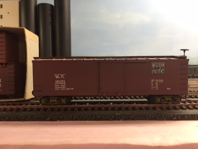

I bought some old Train Miniatures/Walthers Boxcars, and some bare bodies were thrown in:
They look to be Double Sheath Wood cars. Would a fishbelly frame be correct for these cars? I tried an Accurail frame in one of the bodies. It was long, but I think I could shorten it a bit. I could also try a Tichy frame. Also, were brake wheels really that big?

Thanks for the advice, gentlemen. Very impressive work, Doctorwayne. It looks like every car has different trucks, too. The WP car I got seems to have arch bar trucks with real springs, and it looks like some of yours do, too.
I'm looking to get some cheap, '30s era rolling stock, so I will get some Accurail fishbellies and start there. These cars have wood ends and wood doors. I'm not certain if these cars are accurate or not, but they look ok, other than the claw on the door. I suppose I could replace the doors easily enough.

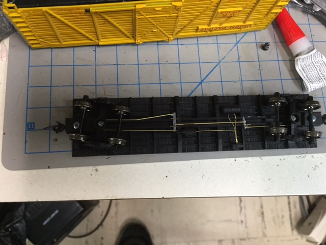

I tried a Tichy Reefer Fishbelly underframe, and got Tichy Andrews trucks and a K-brake set:
I had lots of trouble dropping (and losing) small parts, getting the brake wire in place, and then I can barely see it Wallbang
I was going to try the USRA SS underframe on the other car, but it's a bit narrow. I'll see if I can make it work.

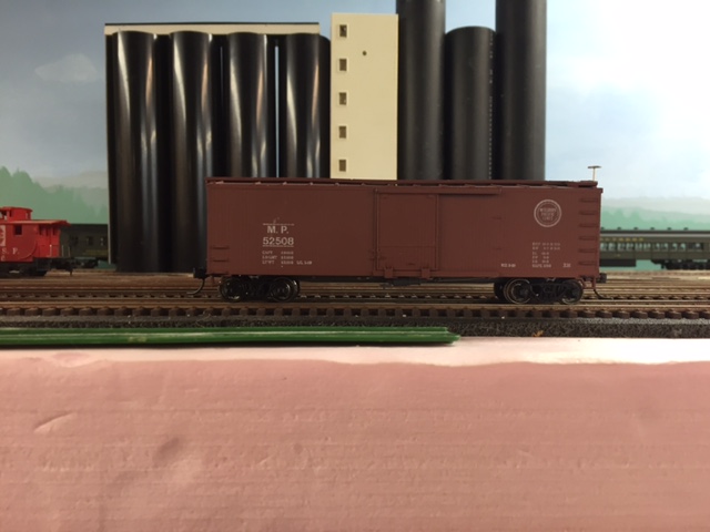

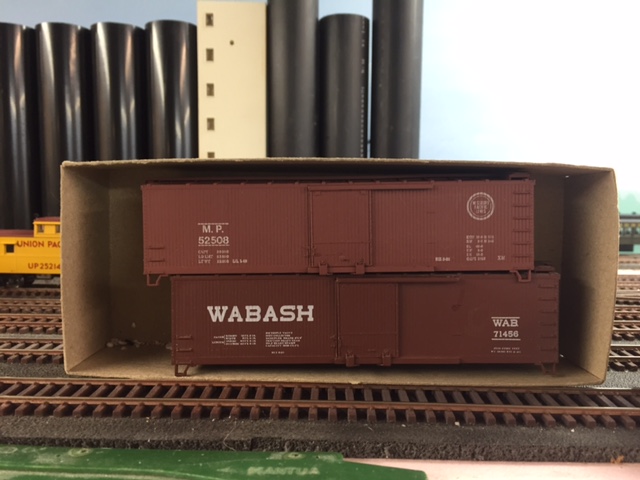

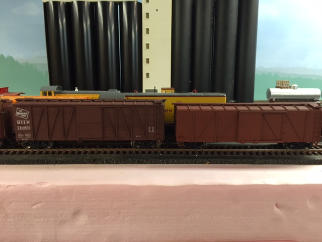

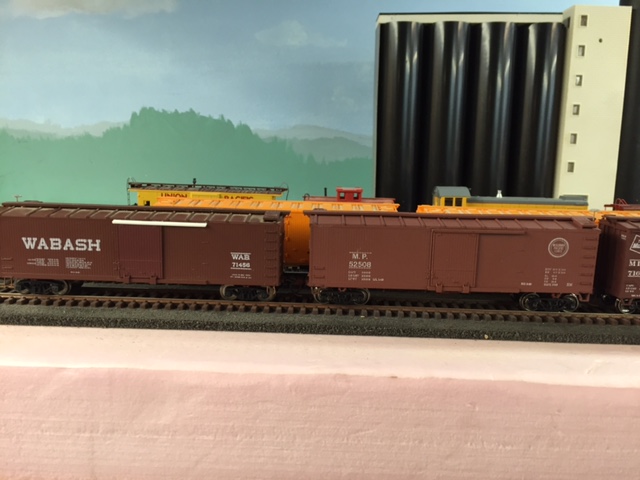

I neglected to post a followup to this topic. I have the cars mostly finished, just some touch up painting left, and I built some Accurail cars and TM cars, too:
I had broken stirrups and door guide on the Wabash car, so I replaced with brass stirrups and some styrene channel.
I need decals for the TM car:

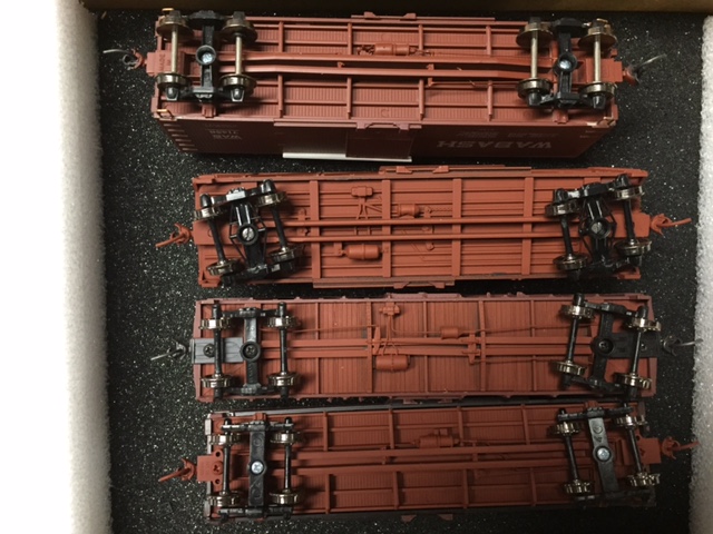

Underframes:

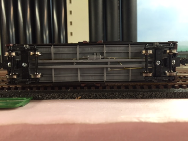

I also added brake detail to a Accurail steel car:
I (mostly) enjoy doing the brake rigging on these cars.
I bought some used cars and kits from some acquaintances who are downsizing or changing their focus, so I will start separate threads on those topics.
