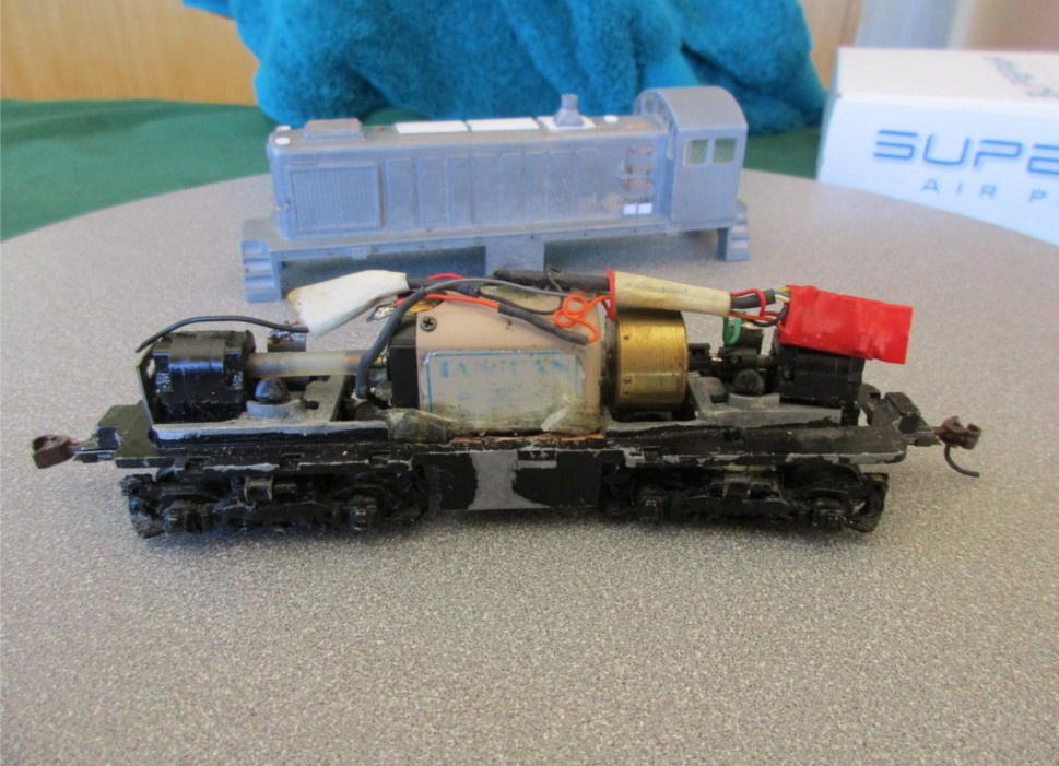

Glen, the FM shell mounts the same way, thank you. seeing I bought the shell second hand I didn't know about the two brass tabs, I will have to make a set when the time comes.

Bear I appreciate the photo of the drivetrain, it will come in Handy
Andy, I'm glad I was able to help you out.
