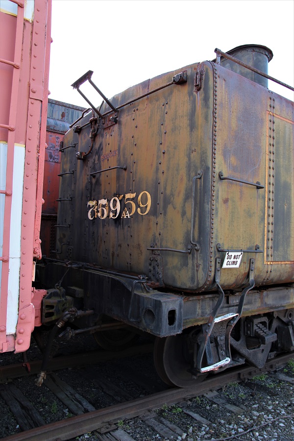

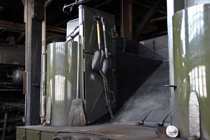

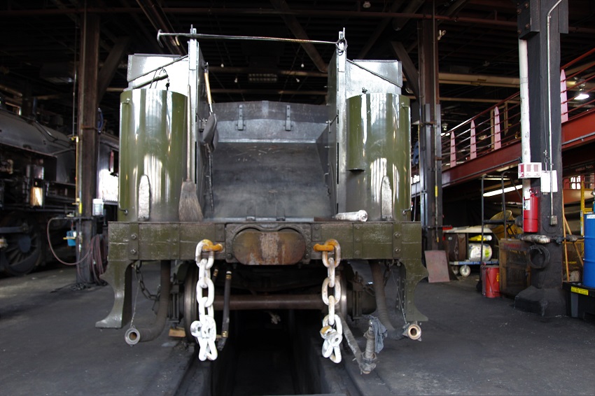

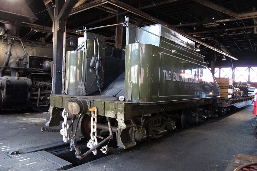

So to start it off here are a few shots of a survivor. This little slope back from the city of brotherly love has been newly refurbished and currently in excursion service in Scranton PA. She is resting in the roundhouse, and as I type this is being readied for this summers outings.
Yeah, it's tuesday, Tender Tuesday!

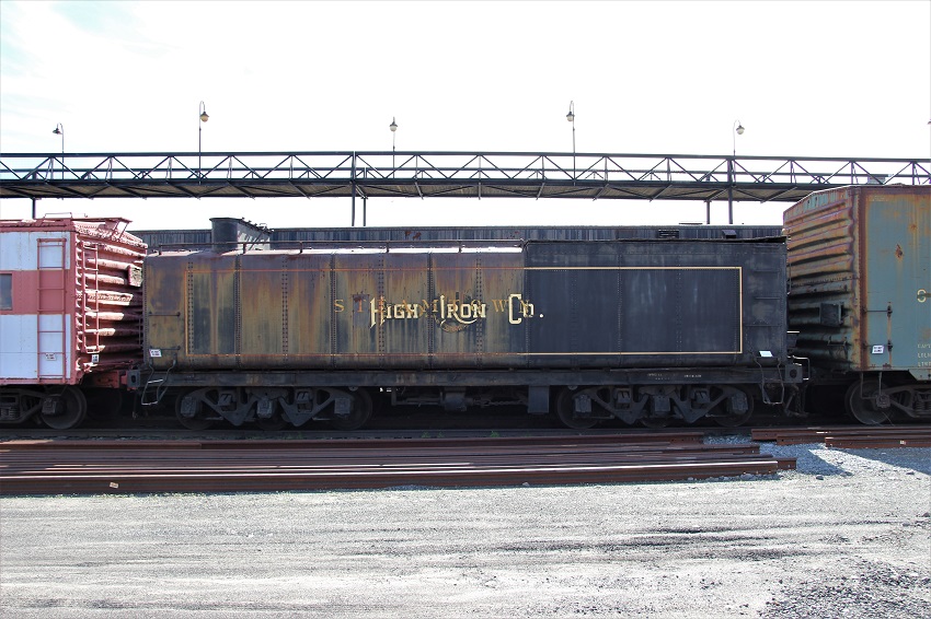

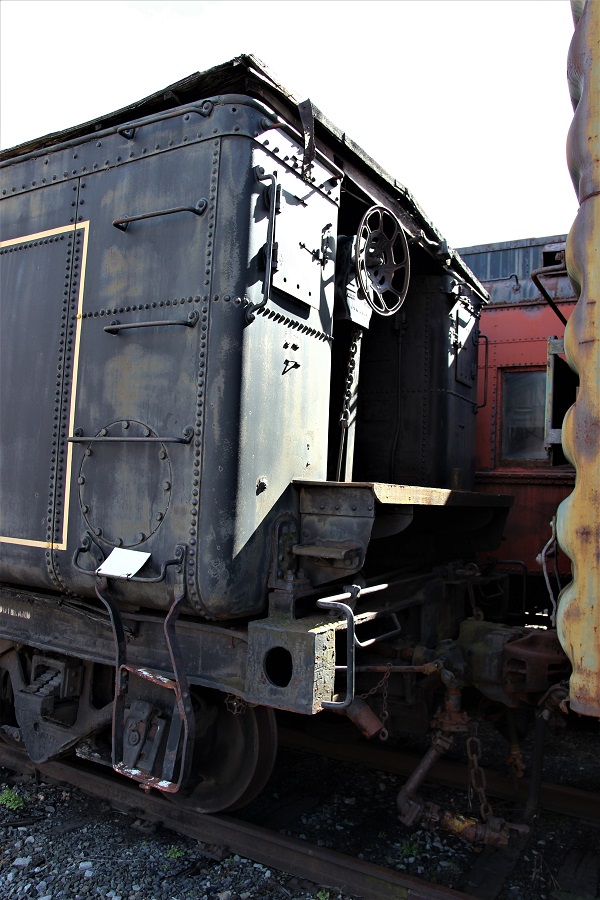

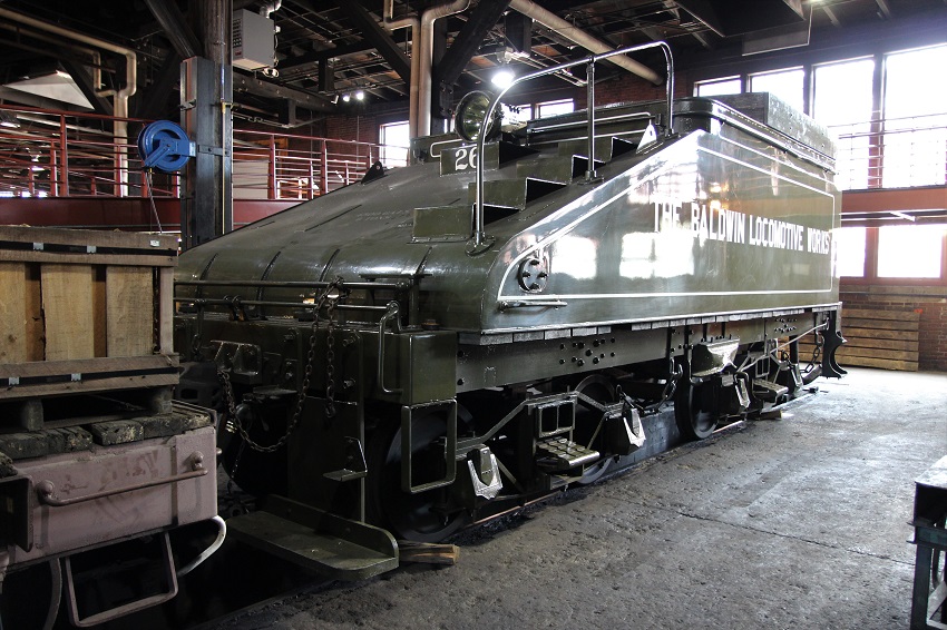

For this week I have a few shots of the High Iron companies A-tank, 759. She was converted from a N&W tender, most likely an older 2-6-6-2 that was surplus. She saw many miles riding behind NKP 759 in excursion service, but interior rust has sidelined her unless a new cistern is construction. This tank also saw service as a water source for a steam crane before it's time with the big Berk. Just another example of the usefulness of the often overlooked tender. She now rests in the yard of Steamtown at Scranton PA.
Next week I'll have to highlight some tender modeling.

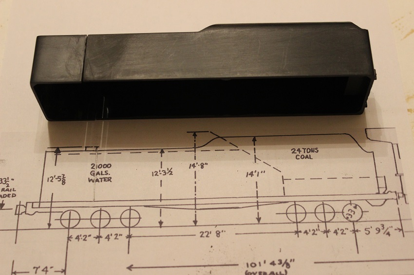

today I would like to post a quick review of probably the most extensive tender project that I have tackled. CNJ's 21,000 gallon - 24 ton long haul tender.
My first interest in this tender showed up in this thread.
<!-- l --><a class="postlink-local" href="http://www.bigbluetrains.com/forum/viewtopic.php?f=3&t=7097">viewtopic.php?f=3&t=7097</a><!-- l -->
For a more in-depth look at this build check out my 2-8-2 build, check here.
<!-- l --><a class="postlink-local" href="http://www.bigbluetrains.com/forum/viewtopic.php?f=17&t=7657">viewtopic.php?f=17&t=7657</a><!-- l -->
Most of the early pics from this thread have disappeared into Big Blue purgatory during a server change, but I am reposting the pics here.

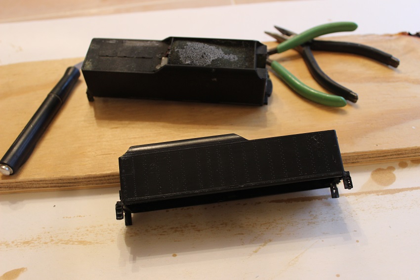

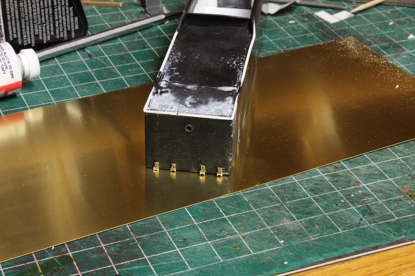

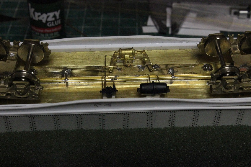

It took the combining of two tenders to pull this one off.
Rear details.

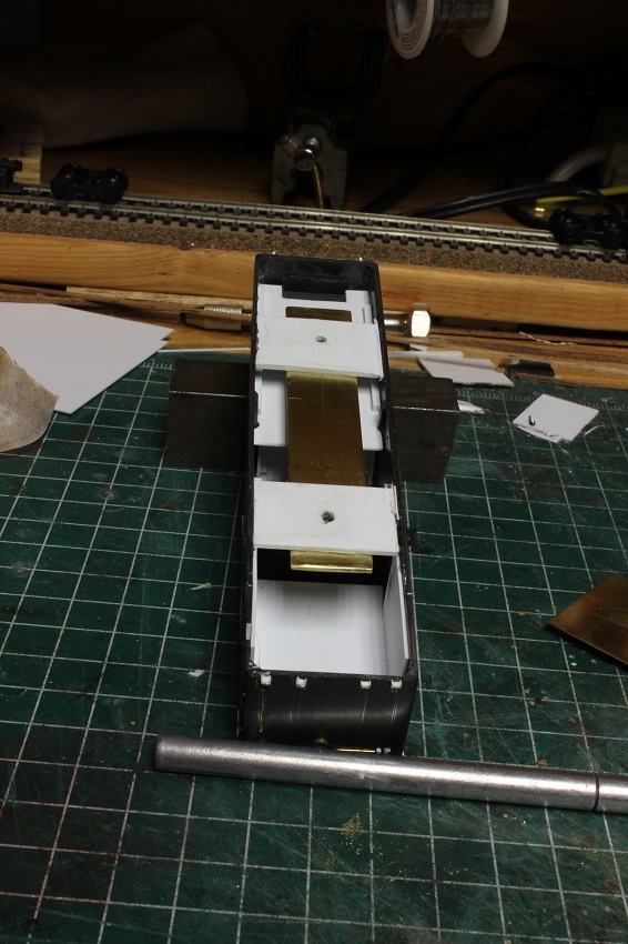

Interior bracing.
Under side details that were a best guess from another Lima tender that I was able to climb under and get a few picks of.

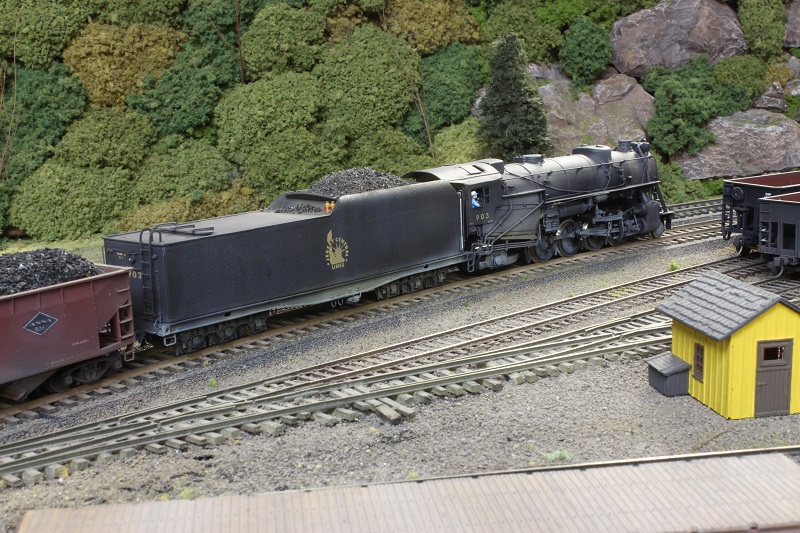

A shot of the finished product of my CNJ long haul tender.
One of these tenders survived into Conrail as a fire car. The CNJ and Conrail both numbered it as B-1. RMC did an article on this car just before they closed up shop and were bought up by another publisher.

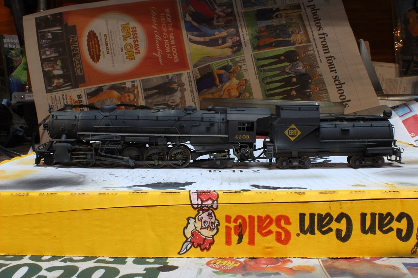

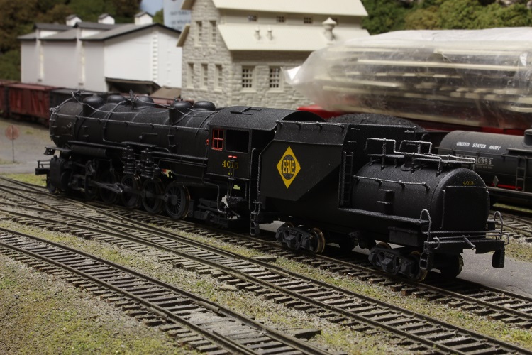

A brass Vandy tender that I painted for Toptrain last September. She is riding behind a Erie R-1.
A reworked Vandy that I did for my Erie R-3.
And after weathering.

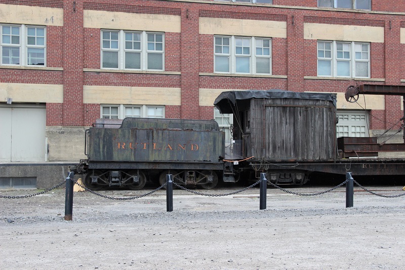

Afternoon Gentlemen, and welcome to another addition of "Tender Tuesday".

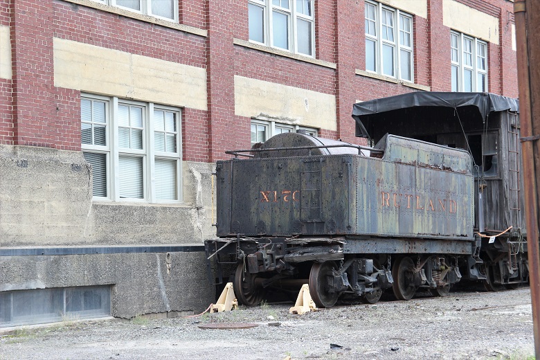

This week I would like to post a pic or two of a tender that doesn't even belong to a steam engine. In this case it a Rutland pile driver car. She was built at the Rutland shops way back in 19?? Crazy ( really don't know when) and now resides in Scranton PA. I felt this is a tender that deserves recognition as it's in a spot that is not easily viewed by the public. I like the rounded tank incorporated into the design. It's general shape lends it to something that could have pulled behind a camelback.
Neat little tender, and you can see why they put the tank into her rather than use the existing cistern. I like those Simplex archbar trucks, too.
