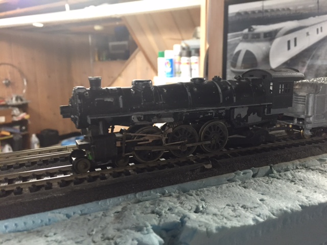

Lately, old steamers are finding their way to me. To go along with my Big Boy, I just acquired this old Mantua Pacific:
The paint is peeling, the seams were never filed off, the pilot is missing, and it sounds like a blender, but it runs strong. A little cleaning and lube should help it out. It also came with a brass tender.

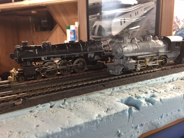

I also got this Bowser H-9 mechanism. I had an old junky shell, which I think is an IHC:
I modified the mounting areas, drilled holes for mounting, and put lead in the boiler. It's a little loud as well, but quieted down with just a few minutes of running.

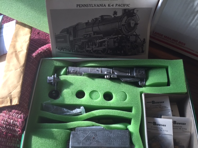

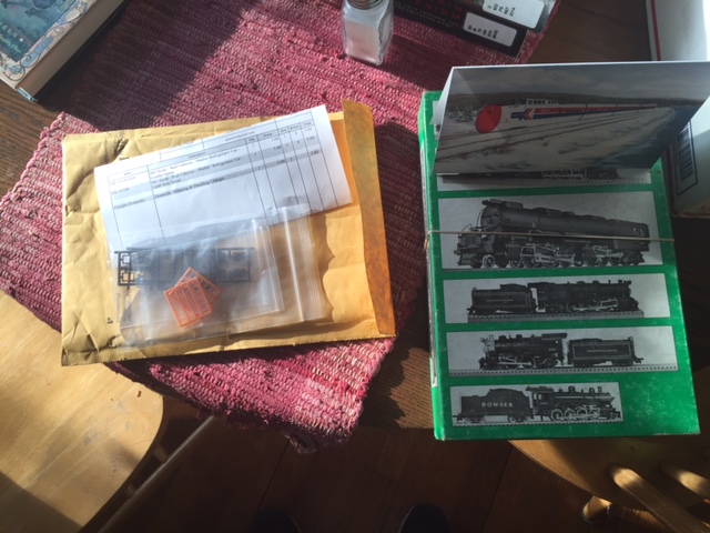

Finally, I enjoyed building my Bowser Casey Jones so much, I've been looking for other Bowser kits at shows and on eBay. I finally won a Pennsy K4 on eBay, and it arrived today, along with my ladders and grabs from Intermountain (see Reefer Madness):

Finally, the K4 has a Belpaire firebox. I don't model PRR, so is it possible to grind off the square box? Does it resemble any other Pacifics without the Belpaire?

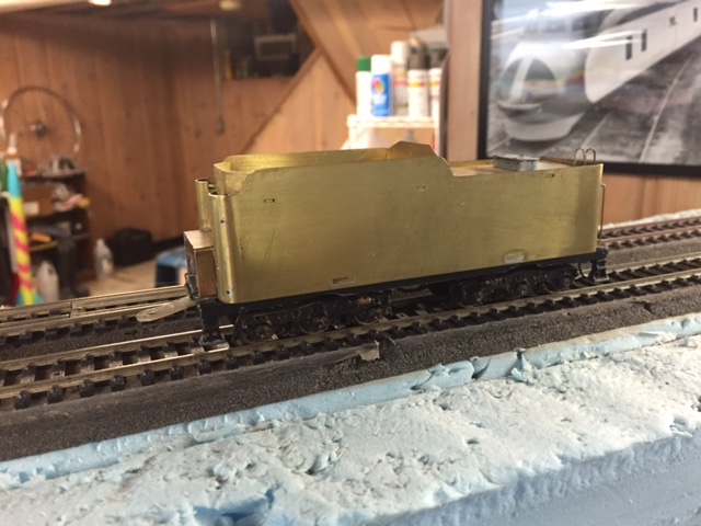

Here's the brass tender:

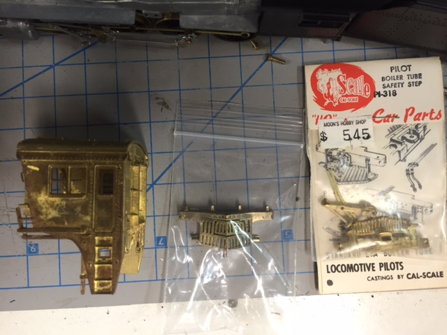

It doesn't have any rivet detail, so I wonder if it was a kit or even scratchbuilt. Along with the loco and tender, I also got a brass cab and some brass pilots:
I like the pilot in the middle--it has a coupler that swings out--so I need to get some sheet brass and start cutting and soldering. Not sure if I want to put an all-weather cab on it, though.

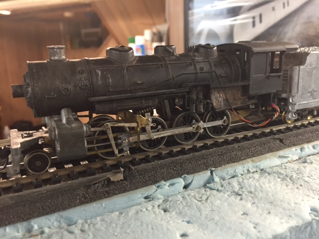

The project for tonight, though, was to work on an MDC Harriman consolidation kit:
I have been tinkering with this one for years. I bought the kit and built it per the instructions, and it ran ok. Then I put a decoder in the tender, and it stalled alot, so I added pickups on all the wheels of the tender, and it ran really well. I added a generic Soundtraxx steam decoder in the tender, and it sounds pretty good. What it was missing was valve gear. Someone once on a forum told me Bowser H-9 valve gear would work just fine, and lo and behold, a guy at a show was selling H-9 leftovers, including valve gear, side rods, and cylinders, so I bought them. I have been trying to put the two together, on and (mostly) off, for the last couple of years. Finally I figured out a way of screwing the Bowser gear to the third driver by drilling and tapping some small bits of styrene and CA-ing them to the back of the drivers. I needed longer 0-80 hex head screws, but I got them last night and cut them down. It worked! Tears of joy!
I have a Cal-Scale detail kit for this loco, so I guess I've got my work cut out for me...

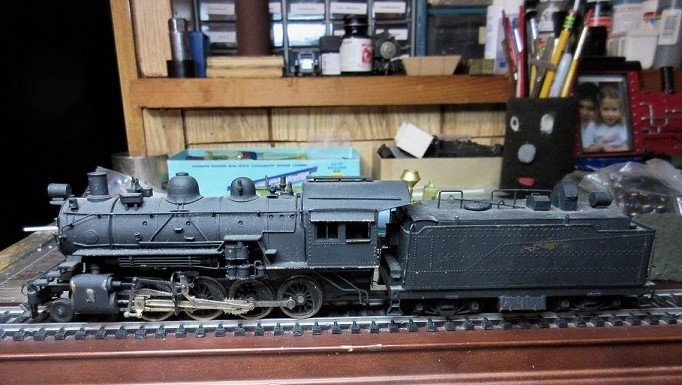

Well here is a old United Santa-Fe consolidation. You should be seeing it sometime after E-paw redoes it. It is his now. Can't wait to see how it comes out.
POP
" It's a Heck of a Day " !!!!
Nice...there is a lot of potential in those old locos. Thumbsup
toptrain Wrote:.... Can't wait to see how it comes out.
I'm guessin' maybe as a camelback? Thumbsup

I don't really like the way the Mantua pilots look, though I do like the ladders. I'm not sure I want to put the all-weather cab on, either, so I soldered the pilot to a piece of .030" brass, drilled a hole, and mounted it. Looks good to me. Still playing around with cabs.
Noticed the valve gear wasn't quite right on the connie and fixed it, too.
