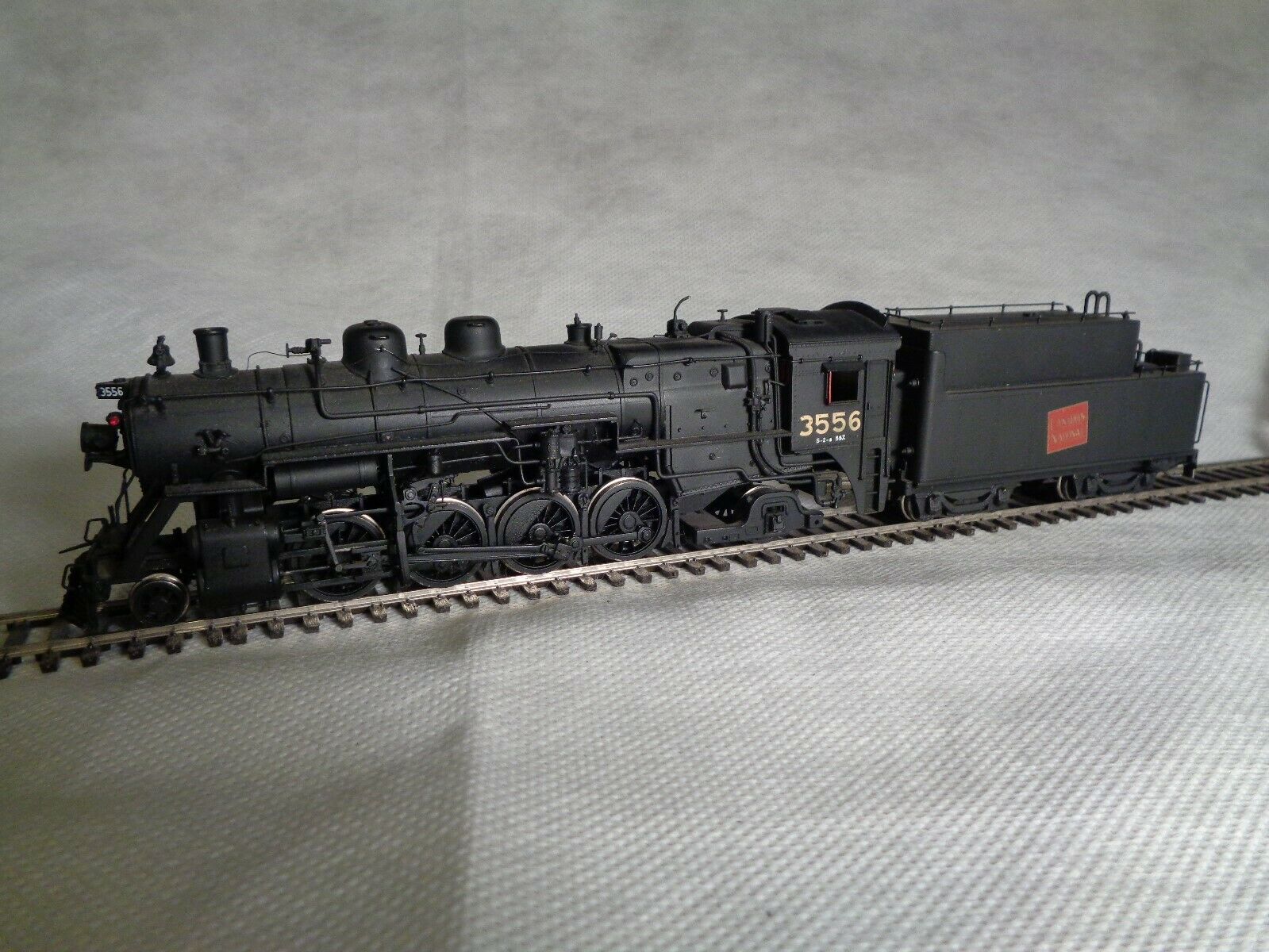

        Hello,
I am eagerly anticipating the arrival of a well loved and cared for Brass Samhongsa CNR painted 2-8-2 S-2 Mikado.
The previous owner has said that after approximately 15 years in storage the motor is working in forward and reverse but the locomotive will not move. He suggest it could be drive chain linkage has become disconnected or that the coupler has dried up.
This is a lovely looking engine and I would like to see if we have any other owners of this type of brass locomotive that could make some suggestions?

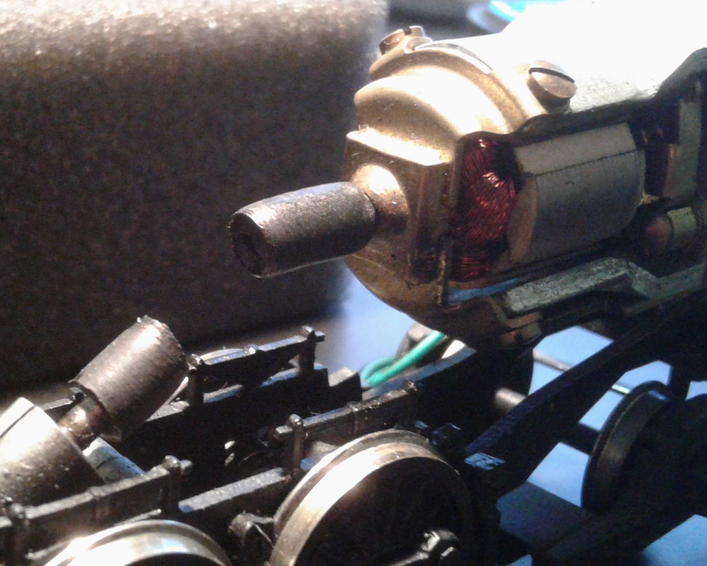

After painfully slowly learning how to remove the boiler and cab I have some photos. Even before removing the boiler and cab I noticed on the bottom there was a gear box which was able to rock back and forth through maybe 50 degrees showing no link to the drive shaft.
Once the chassis was opened up I could see no link between the motor and the gear.
I have to say its one of the scarier maintenance projects working on a brass loco.
Probably rubber tubing as a driveshaft - not uncommon, but it hardens with age, and then often crumbles.
Model airplane fuel-line tubing is a good choice for a replacement, but you'll need to either measure the diameters of both the motor shaft and the worm shaft, or take the loco along if you can find a nearby model airplane shop.

(05-27-2020, 09:28 PM)doctorwayne Wrote: Probably rubber tubing as a driveshaft - not uncommon, but it hardens with age, and then often crumbles.
If you don't have a supplier for model airplane stuff, contact me via PM.
