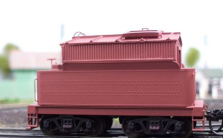

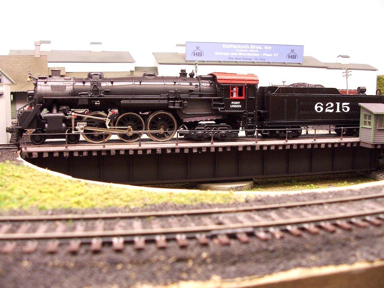

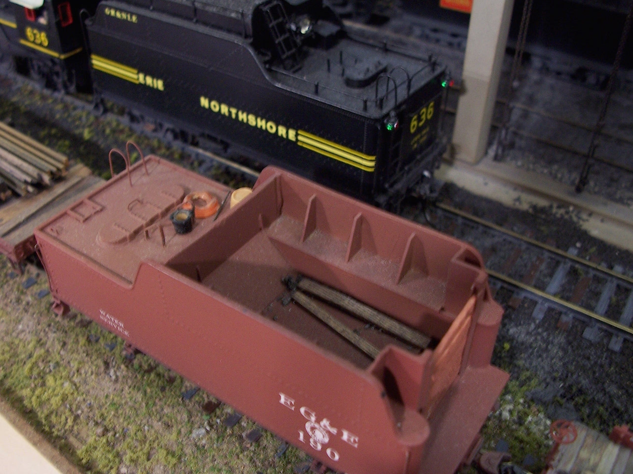

No prototype photos, although I have seen lots of tenders re-purposed as water cars. I have one on the layout which I think is probably a Tyco. I modelled its coal bunker, but all that's there is some left-over coal and a couple of planks. Here's some just-taken photos, which show that I need to do a small repair to one of the handholds on the rear corner...the camera seems to see things much better than do my eyes.
For the Challenge ones, I'll be adding a little height and a boxcar-type roof over the coal bunkers, plus access doors on the front of the bunker....whatever's in there won't be viewable...could be tools, maybe a gasoline-powered pump., along with some hose....whatever the MoW Dept. thinks appropriate, I guess. I'm savin' them a bag of money by not actually putting anything inside.

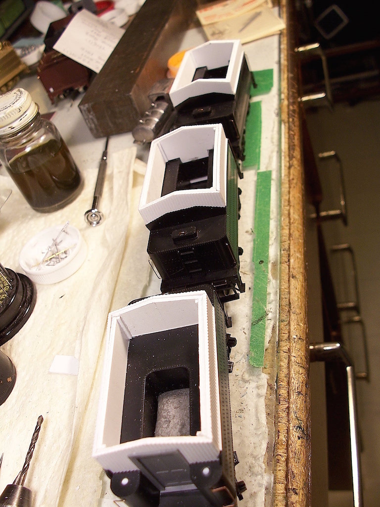

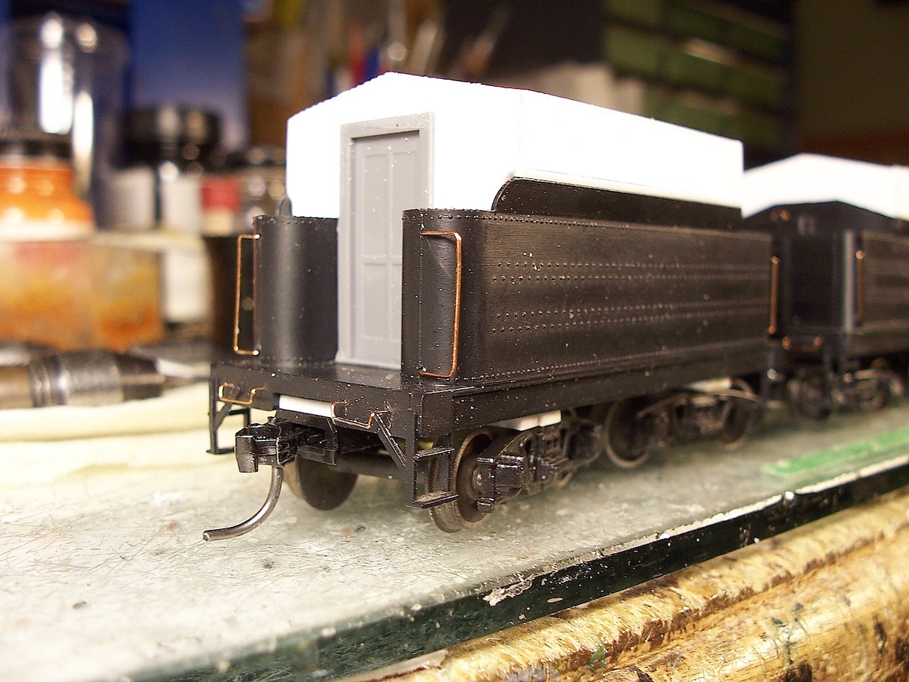

I used .060" sheet styrene to build-up the coal bunkers, as I had lots of cuttings of that material left-over from other projects. I then sheathed the outside of the extensions using some Evergreen "corrugated" siding. The doors allowing access into the former coal bunkers are from either Tichy or Grandt Line. They're non-working, so I won't have to make any details for the interior.
The next step is to build the roofs, and I'll likely be using Evergreen sheet- and strip-material to create a waterproof cover for each car.
The lead car, in the first photo, is the one that didn't have a cast metal underbody, but it looks like I'll have to modify the body shell a bit so that I can use screws to keep the plastic underbody from falling out every time the car is picked-up.

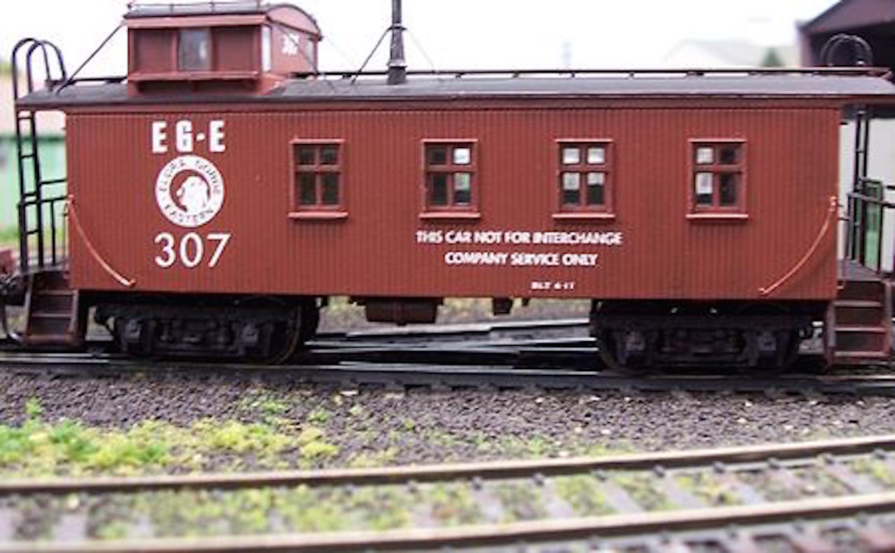

This one was given to me by another friend, and although it wasn't originally part of this Challenge, I decided to add it in, as it needed a few repairs to the ladders - one had broken away from the roof, while the other one was missing both of the curved tops. The car was, I believe, originally a CB&Q caboose, but it's now an EG&E car, also needing a little weathering....

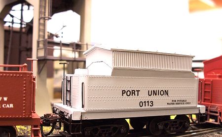

This one, painted just today, will be another EG&E water car...

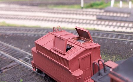

As you can see, it's a little different from the other two small tenders. All of these cars were modified in the car shop at Lowbanks, and one of the crew there suggested that while these cars could be water cars with a small tool house in the former coal bunker, as was done to the other two cars, it might be useful if the tool shed portion could also double as a covered coal bunker.
This would be useful to keep the coal (likely for use with a derrick, rather than a loco) out of the elements, especially in the winter, where unprotected coal might freeze together in one solid block simply sitting somewhere for weeks or months without being called for duty. A stoker with a shovel would make little headway with the coal frozen together.

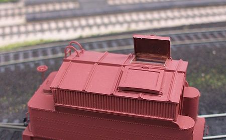

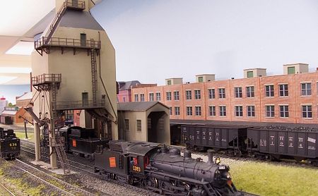

I tested the arrangement at the Mount Forest coaling tower....
...and it looks like the chute can best direct the coal into the open hatch furthest from the tower, with little to no spillage, as the hatch opening is limited (I was going to put chains on the hatches to limit their movement, but the angle iron around the opening takes care of that....
