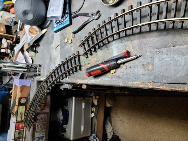

The MOW work has begun...........
12-1/2 Ft of G scale track, just laying on the floor:
Posts: 6,799
Threads: 1,141
Joined: Nov 2008
Half way through this one.....
The first few sections of track being worked on:
Then after they are put in place:

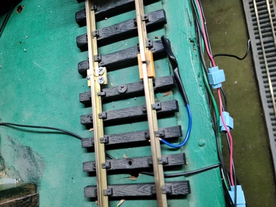

Now for all of you that think that years of experience make us knowledgeable...
I replaced all the track, checked each joiner and threw the switch.....and Nothing Happened
Looking at the wiring, I saw no issues, I even wiggled the supply connections.
That left the diode .... The blue wire after wiggling it, was fine
After trying a few more times I finally pulled on the wire and it didn't move. This was NOT good, seeing it was supposed to be where it is in the picture, between the rail and the tie.
Turns out it was trapped under the plastic.
After loosening the track, I freed the wire and stuck it back where it belongs and everything works!! Trolley service has now been restored on the MF&W RR...
