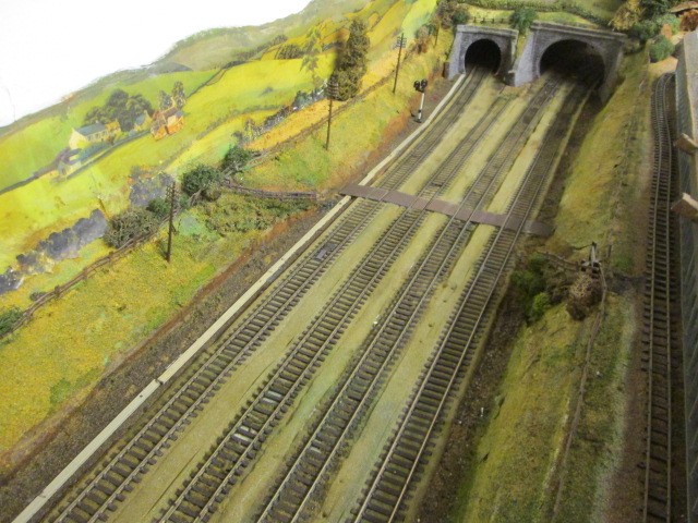

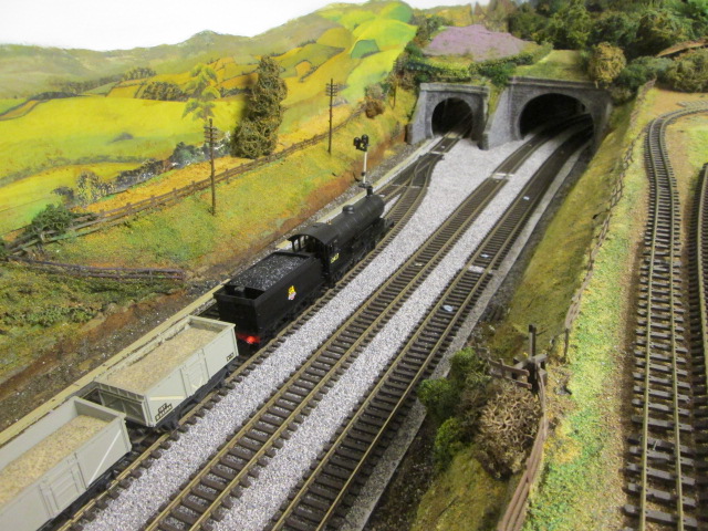

in the late 1960's my layout was built in the loft , British outline to the UK scale of 00 (1-76) , and the flexi code 100 Peco track was laid on foam underlay , now some years later the track & underlay has been lifted , all track & points got a couple of days soak in the bath tub .
Dried and cleaned track has been re-laid and now my first attempt at balasting (Woodlands)

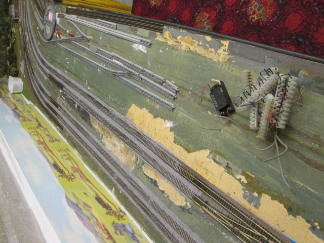

main line with foam underlay

main line with track before balasting , also this section now has water trough's (water pans) fitted ...

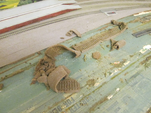

Foam underlay was susceptible to spontaneous disintegration. Both Peco and Hornby.
I set up some sectional track with undelay glued to it (for floor layouts). I still have sections with glue and blobs of foam on the bottom.
What is under the track now?

thanks guys , some answers , the back screen/drop is the old Peco and has all been replaced with same from Peco , as still in stock .
the track bed under the track is thin MDF or Ply or Hardboard with PVA and granite (Woodland) , originally laid on soft board (Sundela)
but over the years this has taken a set to the frame under the layout , and my thinking is to try and level the ground to make the track
level once more , and will be ballasted .
more ballast will be added to the track , the photos pick up the faulty area's '

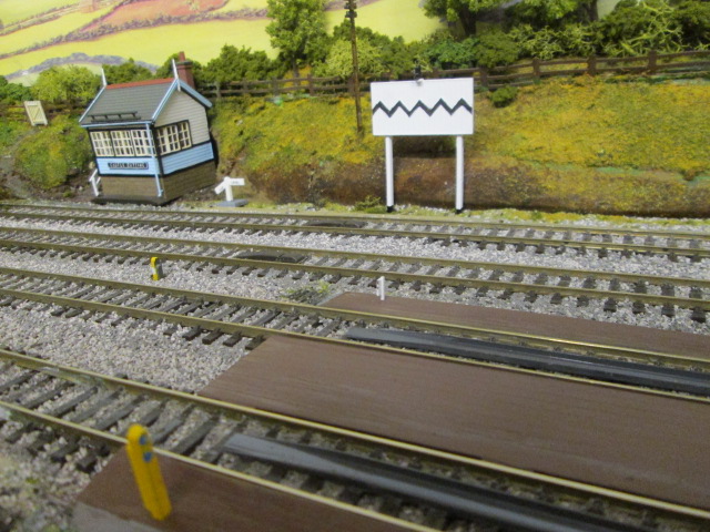

to-day's photo is the water troughs and track and notice new Peco back drop . it's clean !

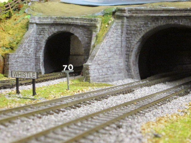

tunnel mouth - England Wales Scotland we drive on the left (nowadays)

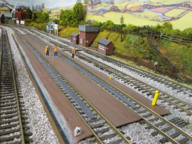

the station area , old track/foam underlay removed and track laid before balasting , the station is a mainline through junction station with 4 platforms
mainline track track is Peco code 100 , the 9mm N scale Kato track is for narrow gauge , it was to use the disused branch line from the station but plans have changed as this would prevent the re build of the loco depot in standard gauge

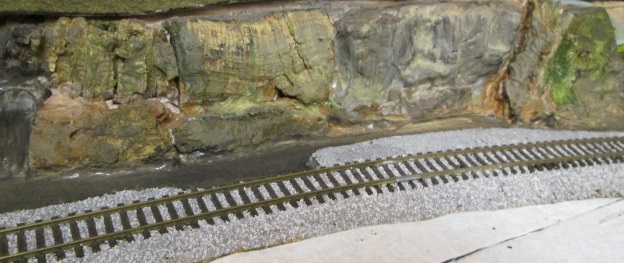

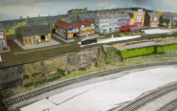

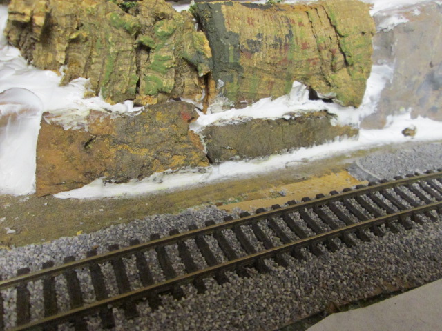

its been a long time but the layout has come on , again not many photos of the build , trying sone cork and casting rock face (Woodland ruber mold) ...
