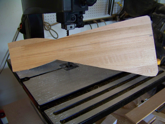

Cut the blank on the bandsaw, note the pencil line. I cut the blank in two so I could cut the tapers and basic shape with the saw.

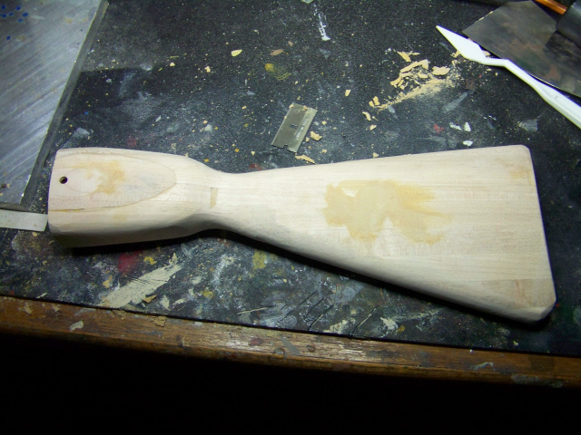

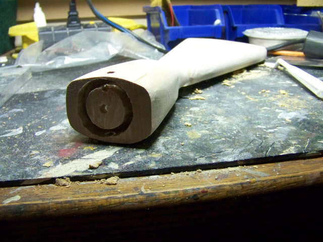

After cutting the basic shape on the bandsaw, I glued the parts back together, then sanded it smooth with a belt sander. I used a circle cutter and a Dremel tool to cut the groove that fit on the end of the gun in place of the adapter.

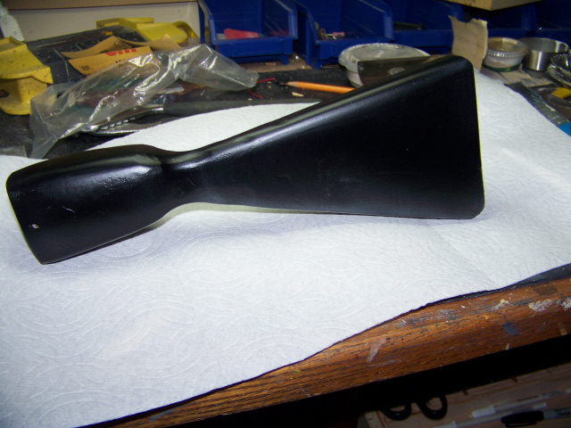

I spray painted the wood stock black to match the gun

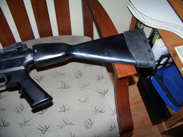

Here it is attached to the end of the gun. Added a rubber butt pad to cushion any recoil.

Thanks much Charlie. I had a 14" Craftsman band saw and a DeWalt planer along with a double-bagged dust collector. Sold them all when we moved a couple of years ago. Not smart. So right around Christmas I got a discount coupon from Harbor Freight and gave myself a Christmas present. It's the smaller 9" one, that's why I had to cut the blank in half to shape the blank. It cuts nice and is very quiet, and looks identical to the 9" Craftsman.
