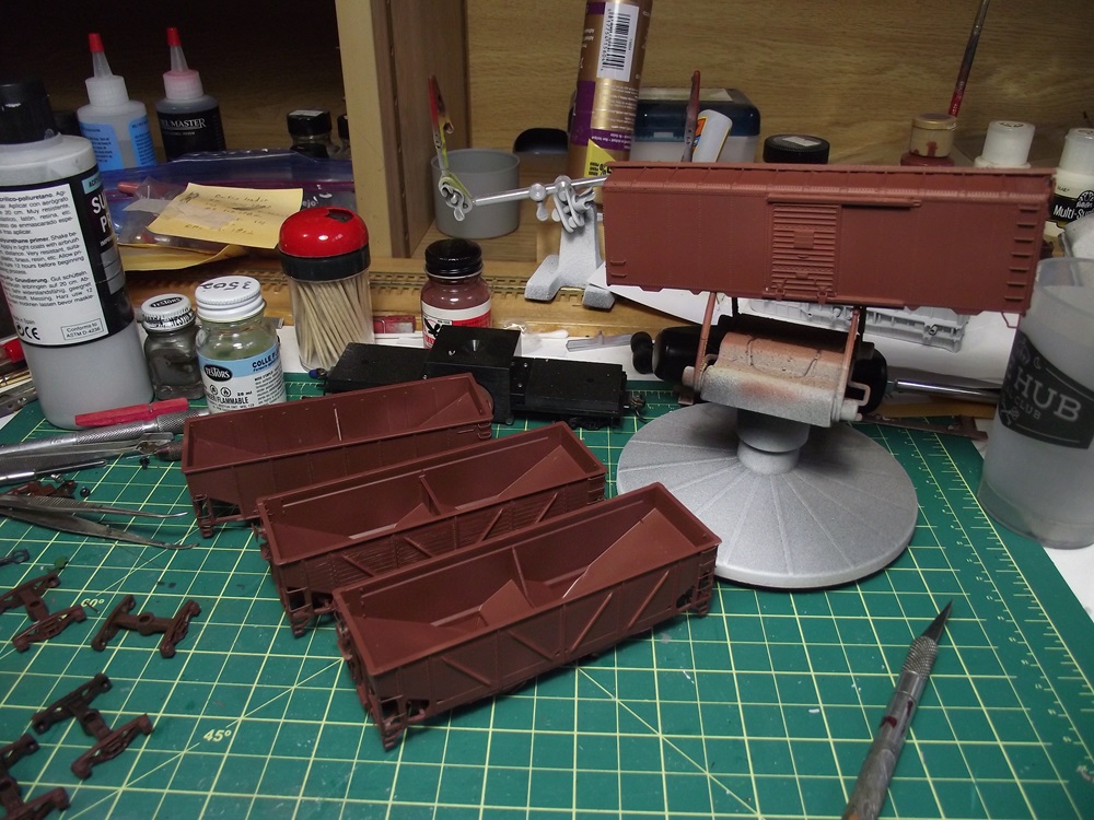

Painting!
Over the past couple days I fired up the airbrush(s) and primered and painted the four cars. I had an old Athearn BB hopper that I had primed a couple months ago and the boxcar is the top of an Aztek track cleaner car that I bought second hand and striped, detailed and repainted.
While I was at it I airbrushed the trucks for the three hoppers in boxcar red as well.
Decaling will comence shortly. I like how there is very little waiting between primer, paint, and decals when using acrylic paints

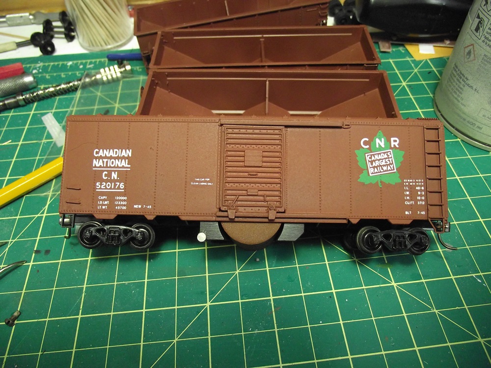

Well, I ws going to do the decaling but I found that the hopper decals that I had didn't really work with these composite hoppers. So I found some cheap ones online and they are on their way. In the meantime, I decaled the Boxcar:
I chose a dry transfer set for a car that was built in 1947 when CN briefly changed it's slogan from 'Serves all Canada' to 'Canada's largest Railway'. I guess that didn't really stick because they changed it back a year or so later.
I also took the oppertunity to weather the trucks for all four cars. I airbushed the trucks and wheelsets with grimey black, followed by a bit of rust.
