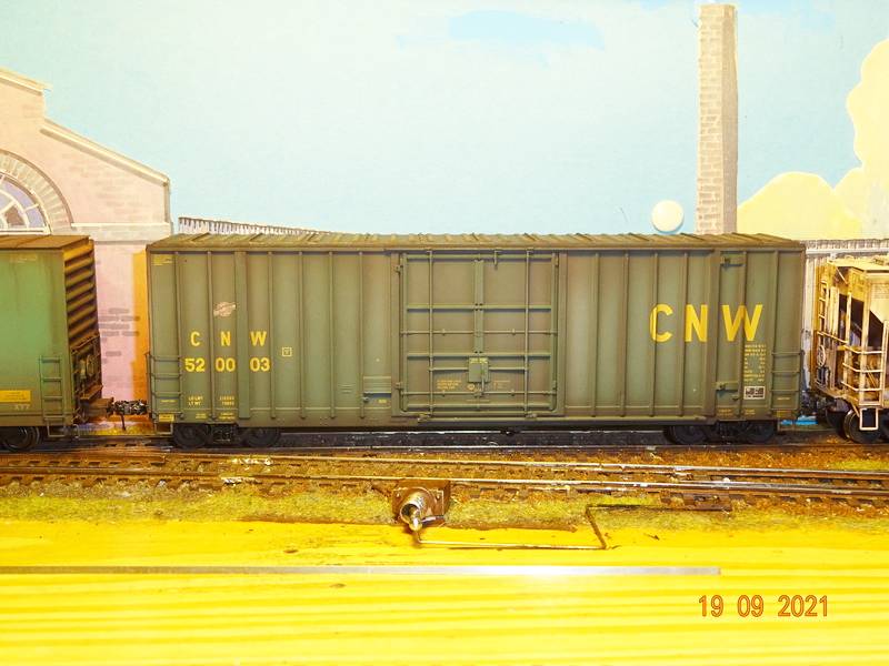

So this high cube box car from Walthers, a second hand offer for a reasonable price "buy immediately". Which i did. It was in mint condition.
As with Walthers Gold Line you have to mount the grab irons by yourself. Naturally this car also was equipped by me with a 3-point equalisation. Also i painted the shining wheels black. Kadee Scale Head whiskers #158 were mounted too.
But the brake was only rudimentary. Only brake cylinder, air reservoir and triple valve were there. No pipes and no rods. The model in the background was my pattern to rig the brake system.
The underframe was separated. The two white pieces of plastic profile are part of my 3-point suspension.
The eyelet of the brake cylinder rod was drilled out. 0.3mm bronze wire will be used for rigging.
Then started rigging.

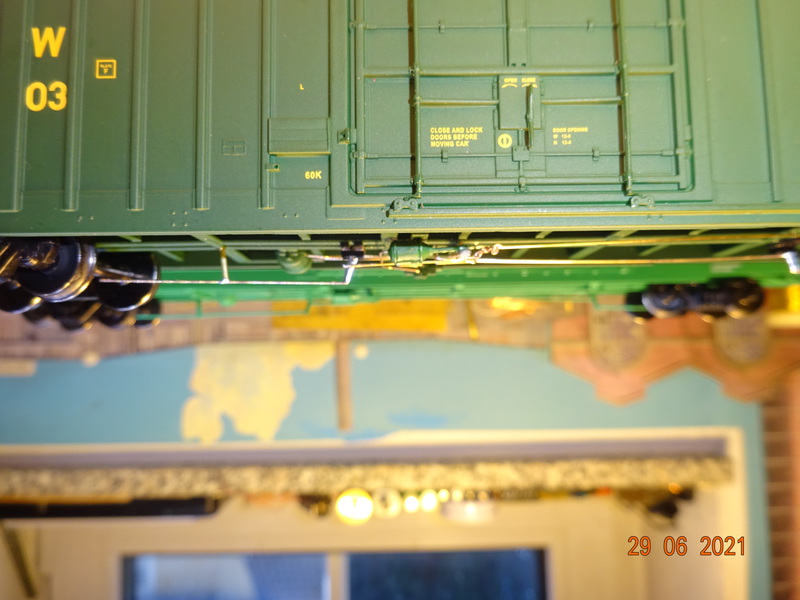

The remounted underframe with completed brake rigging. With modern cars the brake rigging deviates in some points from those out of the steam era.
So some levers are not horizontal, but instead vertical mounted. This structure made out of black plastic stripes is such an bearing for a vertical brake lever.
