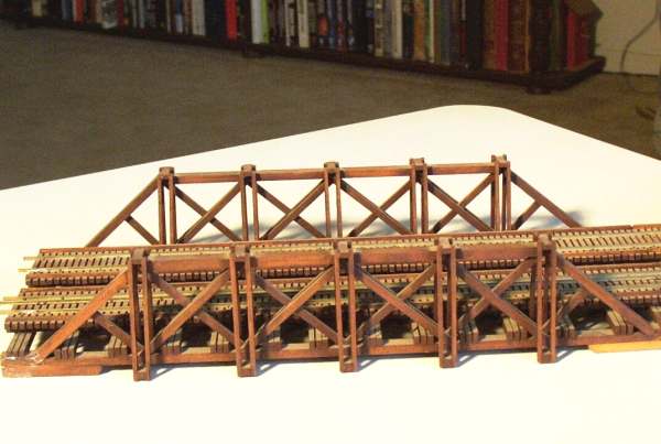

Quick update. Since I finished spiking down that spur, I've taken a step back to assess the progress made to do date. When I think about how much I've done and what I have left to do, it gets a tad overwhelming. But, one must soldier on!
I've started working on the Howe Truss Bridge. I'd like to start work on the wharf, but the simple plywood framing pieces will require the use of my table saw, which I cannot use until the weather warms up a little bit which may be a few months. I can already tell how much of a beast this thing is going to be to build. It's taken me more time to measure, plan, and figure out how I'm going to build this thing more then anything. I've started assembly on one of the segments using a simple jig I've built. It's slow going to say the least. Hopefully, I can take some progress pictures and post up something tonight. I figure once I tackle one of these beasts, the other two will be cake...right? :?
Posts: 1,797
Threads: 81

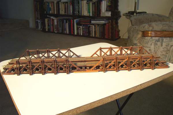

Truss segments. Two down. One to go.

Looking Good Tetters.

Good..?? That's insane..!!! How many of those cross pieces did you have to make and assemble..?? I wouldn't have gotten past the first truss.....
Great job..!!
Gus (LC&P).
Posts: 1,797
Threads: 81
Thanks guys. I still have a lot to do though.
Steamtrains Wrote:Good..?? That's insane..!!! How many of those cross pieces did you have to make and assemble..?? I wouldn't have gotten past the first truss.....
If you must know. There are 18 panels per Truss. Each panel has three cross members. 18 x 3 = 54. Times 3 Truss segments = 162.

Well...slowly but surely, things are getting done.
I finished most of the structure for my Howe Truss bridge. I stained it using a couple mixes of leather dyes diluted in alcohol and then sprayed on using my air brush. I think it turned out alright. Going to start adding the hundreds of bolts and plate detail to it over the next several days, as well as get the track for it installed.

Tremendous work!
My hat's off to you for the patience to cut and exactly place those pieces.

Of these two bridges, I built the right one 42 years ago, and the left one,27 years ago. My friend Ed Rusczcyk, helped me cut all the lumber to exact scale, on his radial arm saw, with a "cabinet maker's" blade. I then cut all the pieces to size, and assembled the bridges from a plan Ed gave me.
this is a close up of the left end.
I post these, as "credentials"........You have done an excellent job building those truss segments. It's good to see this kind of work still being done.
