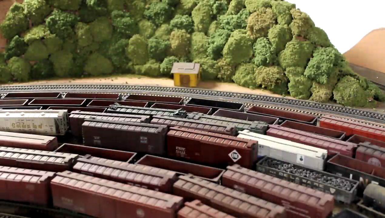

I did a video today of the my LNE 2-8-2 switching some cars around ( all the loads I just finished ). It's 33 cars weighted to the NMRA standards, the old Bowser mike slips a little in the turns but keeps em moving.
[Image: th_001-4.jpg]
And for Twilight, this vid proves the strength of this coupler mounting system you asked about.
[Image: file.php?id=8998]
