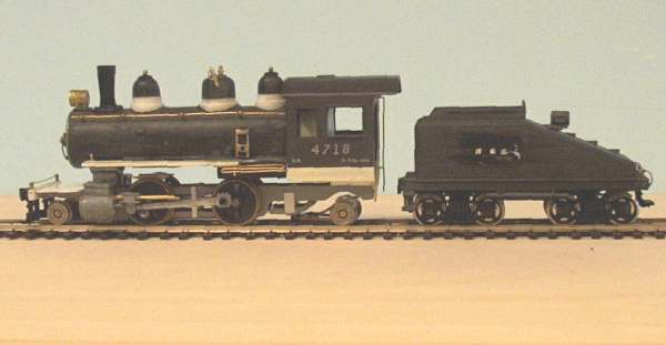

    This is where I last left this project. The only photo I've ever seen of this loco, is of Warrenton RR #4, in the February 1975 issue of Railroad Modeler. One of the reasons I've put it off for so long is that I was hoping to find other photos.

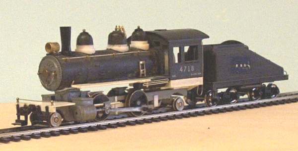

This is where I am right now. Some changes have been made. The original MDC frame developed a crack in a "bad place", and I had to build a new one using mostly ABS plastic. this next shot is a LH 3/4 front.
This shows the underside of the loco,     , and this is the tender, an old Rivarossi that will get some serious "upgrades".     This will be a slow build, as I am also working on the three new modules. Once I have all the required parts made and assembled for the Warrenton loco, I intend to add the "standard shipyard house parts". It will get a generator, not on the prototype, an angled bell mount, top/center on the smokebox front, and the new headlight mounted on the pilot deck.
I'm still working on how to gear and power it.
That is a chunky 2-4-2. Will she be for a logging road with such small drivers?

Very nice!
nkp_174 Wrote:That is a chunky 2-4-2. Will she be for a logging road with such small drivers?
The drivers are actually 51" . The Warrenton used the loco for freight and passenger service on a three mile "short line" between Warrenton, NC., and the junction with the SCL line,between Roanoke, and Raleigh, at Warren Plains. I plan on using it for the same purposes, somewhere along the SM&CH right of way. (on the dual gauge tracks of the new module set)
Chunky? Well yes, that's what has kept my interest in building this loco alive for so long. It is a unique wheel arrangement ( not that often seen ), and an interesting looking small engine.
When I figure out how to power it, I will include gearing to keep it slow and smooth. I doubt that the Warrenton ever ran it faster than 25 MPH, considering the "nature of their track", which was a mixed bag of leftovers. ( "battered, mostly 70-pound rail" )

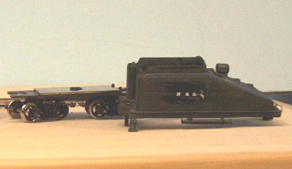

I really like that tender in your first photo - is that from MDC? I have a body for one of those and have been looking in vain for another. I wish that they'd re-issue some of their older stuff - one of their best items was the brass handrail stanchions, which were even nicer than those from Precision Scale.
Doctorwayne,
Yes, the tender in the first photo is an MDC tender, that might even be the one that originally came with the loco ( I bought it second hand, RTR ). I went with the old Rivarossi because I had it, and it more closely resembles the prototype's tender.
