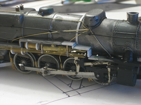

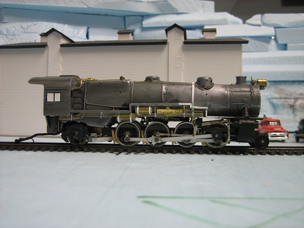

Some more progress on the Mike. The sand lines are in along with the steps on the boiler. I also reinstalled the the hand rails.
#23
Wow! This bad boy is lookin' fantastic! I love the delicate details ... all the neatly run piping and stuff ... very cool!
This is going to be something to write home about, a real beauty!
biL

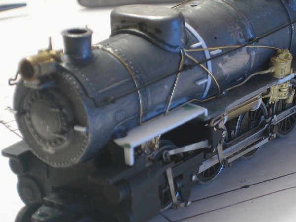

Was kind of busy the last week or so but I did manage to start on the front pilot of the mike. I cut off the cast on step over the air tank because it was way too thick and not wide enough, it just didn't look right when I compared it to the prototype photos. I also had to shorten the Long grab iron that runs across the pilot beam, it was way to high. the other modification that I did was to move the air tank closer to the boiler front , Bowser had placed to almost flush with the front edge of the pilot. [Image: 20110306083810.jpg]
I still have to replace the step over the air tank, add the air lines, add marker lights, and some how figure out a way to get a working coupler mounted in that limited space.

Looking good!
Have you considered placing a small sheet of styrene/brass between the frame and boiler to hide the worm gear? It wouldn't be visible at normal layout height regardless, but doing so would help bring that one area close to the level you've set for the rest of your detailing.
Michael
Michael
#29
Thanks everyone. I may try that Idea Mike. The track height on my layout is about 45 inches so from my viewing angle the worm is not that big of a problem. I'm kind of torn on the idea, I'm worried about trading off one unrealistic detail for another. A big flat plate under the boiler may not look that much better. I may use a trick that worked on my 4-8-0 from the End of year challenge. On that steamer I added equalising springs to the frame, that should be enough to distract your eye away from the gear,,I hope.

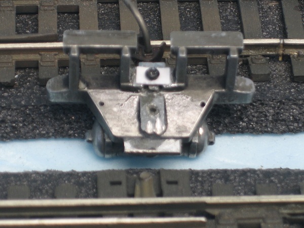

OK, here is my solution to the coupler problem. I cut the shank on a #5 off right where it normally has the mounting hole in it, drilled it out, made a corresponding hole in the pilot, and screwed it in. Thumbsup The connection is plenty strong and at the correct height. It also completely clears the frame, so now I'm happy. Now to start on adding on some details to it.
