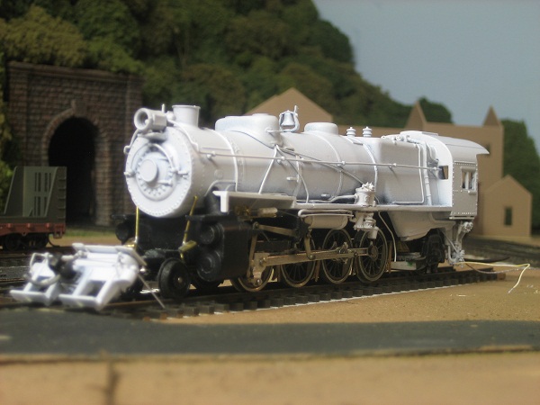

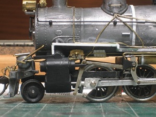

I managed to do some more work to the pilot this week. I added the foot plate over the air tank, Completed the air lines that run to/from said tank, installed the cut lever, attached the # board, glued in the brake line, and soldered the steps to the pilot. If you look closely you'll see that the bell is now in place atop the boiler. Here's a few pics to show what it looks like now.

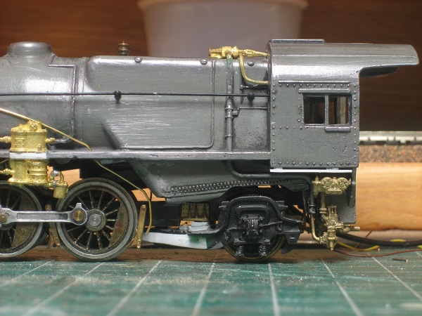

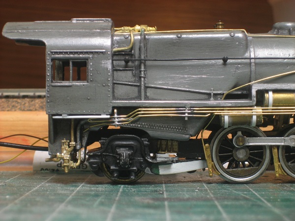

The last thing that I added to the model are the injectors. Or is it "is" the injectors. Nope They are a USRA type and not the PRR type that would be the correct ones for the mike. The correct Bowser parts are no longer available, so I used these because they are pretty close to the right parts.
At this point I'll call the boiler ready for primmer, but that will be a job for tomorrow, as long as the weather holds :? .

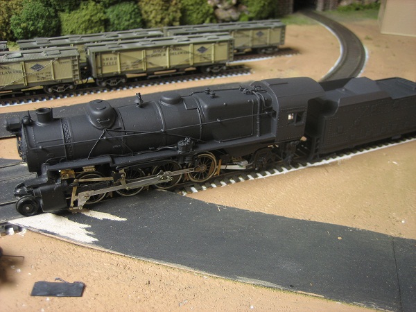

Thanks Doc.. I have experienced unintended electrical episodes like you have warned against. My fix for it is something that I will get to latter, but, it involves making the tender body and boiler the same polarity because they are both conductive, If they rub together you can end up with a short. The next step will be adding all wheel pick up to the tender. Then I make all my tender couplers insulated with a plastic coupler box like I used here. This eliminates any chance of a short between the tender and loco or loco to loco in double heading. That's all for latter, for now the L-1 sits all primmered up on the layout in Easton. All the unprimmed parts will be brush painted.

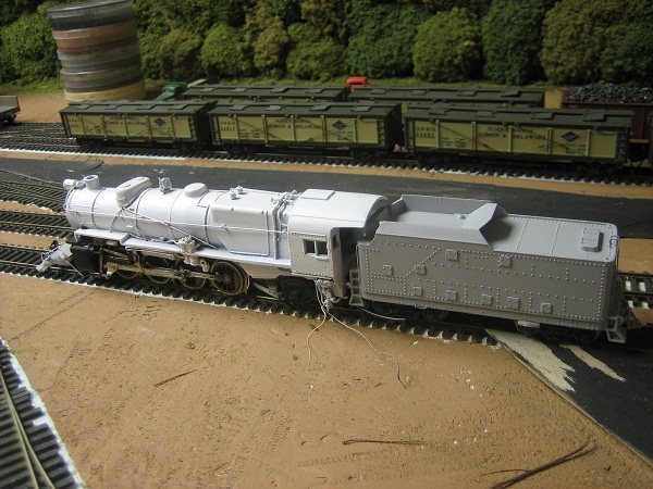

And,,, for the first time in quite some time the Mike is reunited with her tender. Once the primmer has set completely she'll get a coat of steam power black. Thumbsup
#38
Just a quick update... I applied 3 coats of engine black to the L-1, soon the undercarriage will get the same color...

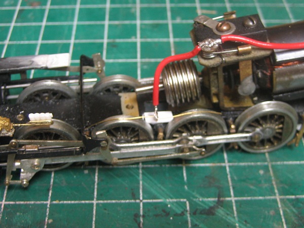

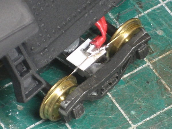

To improve the pickup and provide more reliable running I reversed the polarity of the tender so that the tender shell and boiler are electrically common. This eliminates the possibility of a short from the tender and cab touching in a sharp curve. With that done I needed to now provide pickups for the insulated (fireman's) side. Plastic was glued to each tender truck and brass wire was bent and secured with CA to each truck. Flexible wire was soldered to each wiper and pinned to the insulated contact on the motor.
I installed the same kind of pickup wire on the center drivers of the drive.

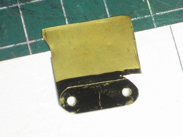

The reason for all this work is so I can shorten the draw bar to bring the tender up to a more prototypical spacing. I took some measurements and started to cut a new draw bar from brass. I use a trick I learned from a machinist when working on this kind of project, I blackened to brass stock with a permanent marker and scribed the outline of the new draw bar in it. The new piece was cut out with a set of small shears and smoothed with a set of files.
You can see here the difference between the stock and new draw bar.
