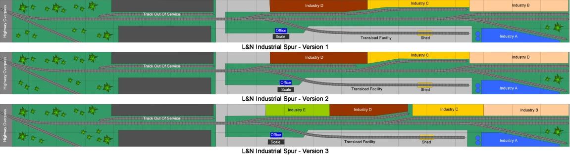

Okay - I'm hung up! Been testing out the track configuration this afternoon and already see two possible changes to the original plan and of course can't make up my mind which way to go. Here is an image that shows the variations I have in mind
I modified the plan to include a simulated connection to the "main line" and have an obvious entrance to the transload track with a drive leading to it, an office and truck scale.
The track is currently laid out as shown in Version 1, but I haven't tried out a test operating session thus far, since I can't decide if I want to make one of these possible changes:
Version 2: Separate spurs to industries C and D.
Version 3: Two long spurs (like an extended Palmetto Spur) with two industries on each spur - B, C and D, E. - OR - Just two large structures on each track.
I'm sort of wondering to myself if I'd be trying to include too many industries on a spur this length with Version 3 and also if I'd have to compress some of the structures too much. Not to mention that I still haven't decided on exactly which of my proposed industries to include!
Some of the proposed industries would be: Storage/Distribution Warehouse, Candy Plant or Bakery, Cooking Oils Distributor, Soft Drink Bottler, Meat or Produce Distributor, Beverage Distributor and of course the Transload Facility that would handle lumber and feed and/or fertilizer for off-line customers.
Your thoughts?
Ed

Ed,My vote goes to Version 2...I always did like one industry per siding since every industry I switched was on its private siding-PRR track stopped at the derail and beyond that was owned and maintain by the industry-the same applied for the C&O under Chessie..There was 2 industries embargoed on C&O's Big Sandy Sub due to their unsafe track..The switches was removed.

My vote goes for plan 2 or 3

Brakie Wrote:Ed,My vote goes to Version 2... Okie-Dokie - I agree. Does look a bit more like your "typical" modern industrial spur and allows for some potentially nice shoebox structures. It also helped when I did what I should have done in the first place - decide on what industries to include! And I did a little test run on what was shown as Version 1 in the previous posting and wasn't too thrilled with it. So here's what I'm going with:
May have to make some very slight adjustments to the length of the three spurs by the shoebox structures, allowing for the number of possible car spots and maintaining my 8 foot switching lead/staging track, but otherwise this should work just fine as shown. With all the food related industries I guess a good name for this would be "The Food Spur".
Industries will be:
Soft Drink Bottler: Corn Syrup Tanks (2 spots with room for 1 off spot)
Food Products Warehouse: Box Cars - Reefers (4 spots)
Cooking Oils Distributor: General Service Tanks (2 spots with room for 1 off spot)
Bakery (or maybe a Candy Plant): Airslide Hoppers (2 spots with room for 1 off spot)
Transload Facility: Covered Hoppers (feed/fertilizer) - Bulkhead Flats (lumber/wallboard) - Box Cars (lumber/plywood/beer/miscellaneous) - Other odds and ends that might show up now and then such as a Chain Flat of machinery or whatever. (4 or 5 possible spots)
All the industries and structures are based on prototypes that I've found.
Time to make the changes to the track and build this thing! Once I get the track re-laid and some structure mockups, I'll post some photos or maybe start a new thread. Just hope that my efforts come remotely close to what some of the other folks on here have accomplished.
BTW Larry - looking forward to seeing the track plan you've worked out for Slate Creek. Feel free to "borrow" any ideas from my ramblings and numerous track plans.
Ed

Well , it's a very interesting discussion about the project ....think I'll have to read it over again , especially Larry's stuff , to try to figure out what real operations are all about .

Hey Ed,
I agree, it looks great and VERY prototypical in my humble opinion... I think you can bank on this one and be assured that it will be really fun and realistic to opperate.
It's time to build! I haad a head start but the way I am going you can easily catch up...can't wait to see you put as much detail into the layout as you have into your plan!
Great work and always helpful!
