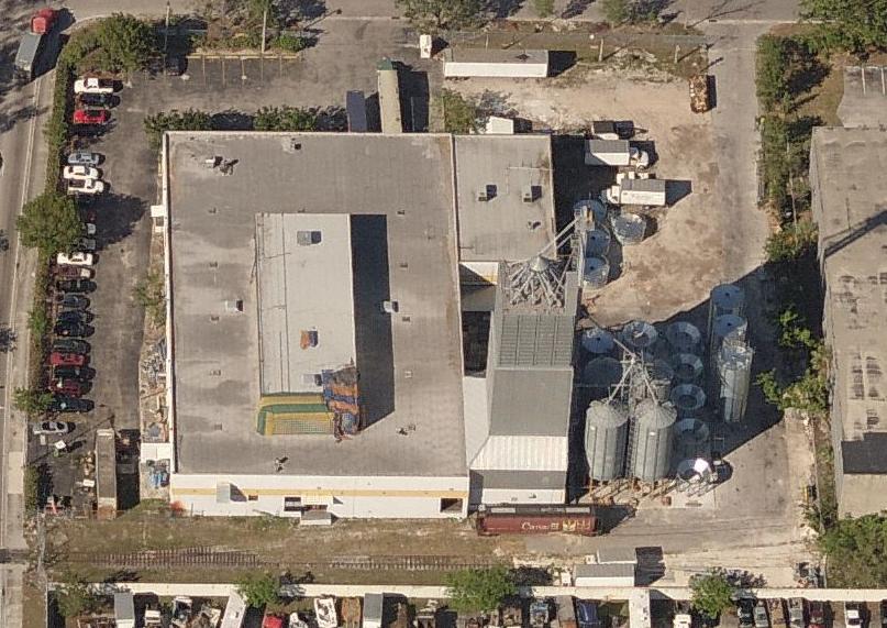

* Pet Food Plant - Based on Higgins Premium Pet Foods in Hialeah, FL - receives covered hoppers and occasional box cars of feed grains for producing pet foods.

Hi Ed,
Your latest plan looks well balanced with 3 spurs either side of the lead. The pet food plant looks interesting , do you have any links to this facility or pics? I'm currently looking at industries based in Florida for my new layout.

Mal - this should show it <!-- m --><a class="postlink" href="http://www.bing.com/maps/#Y3A9bjlmM3JkODljNHd0Jmx2bD0yMC4wMiZkaXI9MzUzLjQ1JnN0eT1i">http://www.bing.com/maps/#Y3A9bjlmM3JkO ... Q1JnN0eT1i</a><!-- m -->
Well - that didn't work! lets try this
<!-- m --><a class="postlink" href="http://g.co/maps/k3p88">http://g.co/maps/k3p88</a><!-- m --> That one seems to work!

Mal;
Jack beat me to the Google views of Higgins but here's the Bing view http://www.bing.com/maps/?v=2&cp=n9f3n58...orm=LMLTCC for some further details. Be sure and check out the Google street views of the facility too. I like the red/yellow band around the otherwise white shoebox structure.
The Higgins http://www.higginspremium.com/ facility is what I'd call a typical modern small feed mill structure and very similar ones can be found in many parts of the country. Here's an example of another relatively new one in the Liverpool, NY area: http://www.bing.com/maps/?v=2&cp=r5qq0j8...orm=LMLTCC. Quite a few of these feed mill facilities of various sizes in my area.
I have some small RIx grain bins and other details that I plan on using to build a representation of this structure and not necessarily a model of this particular facility. In fact, mine may end up just being generic feed mill, as there are a couple of industrial spurs close by that have or had such facilities on them.
I'll probably just have a compressed version of the shoebox structure with one rail door/dock, the mixing tower and a couple of grain bins laid out in a similar configuration to what you see in the views. Of course Walther's now has more appropriate bins available for such a facility.     What appealed to me about this was that it was a bit different and is "model railroad" size as it can only spot one or two covered hoppers at a time, but also has a couple of doors where box cars can be spotted for possibly shipping out the finished product. In older Bing views that I captured, you can see a covered hopper spotted by the facility:     Looks like in this view, they are still in the process of adding grain bins to the facility, so the Higgins facility is a relatively new structure.

That looks very interesting. You can do lots of piping as the prototype has lots of them on top of the tall tower. There is also a very tall elevator right to the tall tower. The Walters grain elevator may have the right hight and will make it a real landmark.
Do you have plans how to do the top third of the tower building? The surface has a very special structure.
faraway Wrote:Do you have plans how to do the top third of the tower building? The surface has a very special structure.
Reinhard;
To make the top of the mixing tower, I'd probably use some O scale scribed siding for the horizontal look and then just cement suitable sized square material for the vertical bracing. The section below that would be done with some corrugated metal siding material. The Walther's grain conveyor leg kit would be perfect (15 3/4 inches tall):     Along with their Support Trusses For Guywires & Piping (if you really want it to be detailed):     Those kits along with the Wet/Dry grain bins would give you a very nice model of a feed mill operation. Of course we're talking some money here to get all those kits and detail parts. I'll probably just use some of the other grain handling details that I've accumulated over the past few years, but we'll see. Feed mills come in all shapes and sizes and are often misidentified as being grain elevators - not the same thing.
