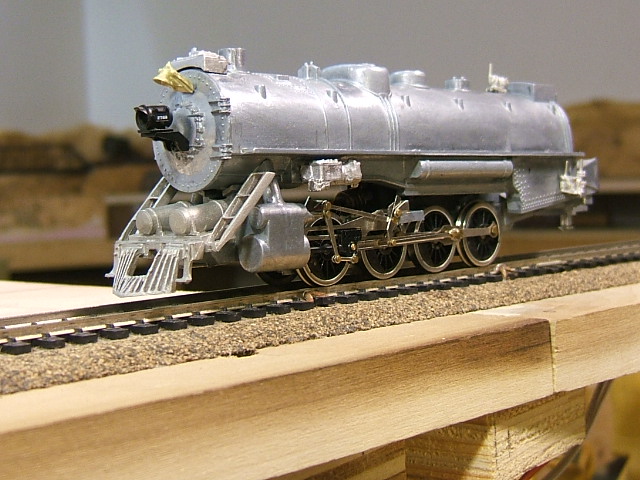

Russ and Wayne...Thanks for the heads-up on weight & balance. I had that in mind when I was planning the "milling" operation. The stock boiler seems to have the greatest concentration of mass forward of the driving wheels (2nd. set of drivers-front to back). That front end is nearly all solid with the exception of a couple of openings for the light bulb and the screw that fixes the boiler to the frame at the front. In any event, I started my attempt at removing weight in this area. And that's as far as I got....Started....
I spent close to 20 minutes trying to drill a hole into this mass of material. I'm using a brand new set of titanium-coated drills, and managed to cut about 1/4" into the boiler. That zamac is HARD..!! My idea was to "honeycomb" this area by drilling into it, but that idea has to be shelved....I don't know what I'm going to do in order to drill holes for the mounting pins of a couple of the details...
Anybody have any ideas/methods to do this..??
Gus (LC&P).

Gus!
Try a drop of oil on the tip of the drill. If this works frequently oil the drill tip. And avoid to drill with high speeds. Thus can melt the zamac, depending on its alloy and the melted zamac will clog the channels of the drill. A drill with clogged channels won't drill, it just turns "in his own juice".
Also frequently clean the channels.
Yes in those day zinc alloy was really zinc alloy, hard, durable and heavy.
Today it is an aluminium alloy with some zinc in it. The reason of the "lightweight" of todays locos.
Lutz

Hey guys..!! Thanks for all the tips. I finally chucked my titanium "coated" drills, and reverted to my old, trusty drill set. They did the job quite nicely. So the super-dooper drills will be used for drilling wood only...
After drilling out most of the front-end weight, I managed to remove only 35 gr. of weight from the boiler. The greatest portion of the weight comes from the overall wall thickness which is almost 1/4" thick. And there's no way I'm going to try to thin those down. I'd need a professional milling machine to do that, and I don't think I want to start down that road...
The weight I removed did make a small difference in the noise department, but is still quite loud when run on ballasted track. I'll just have to live with it.... Eek

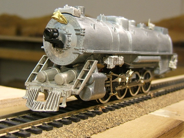

Just a quick update so's you'll know I haven't been "bumming" on this project.... Goldth
I've finished pre-installing all the goodies this baby is going to have, (there's a compressor that will go on the firebox, but I busted the mounting pin Curse , so that will be "surface mounted")....I'll move next to do the piping and painting. I got a bunch of other "goodies" ( about $50 worth, plus shipping)...to dress up the engine some more (hoses, number boards and a couple of other things for the tender), that won't go on until she's finished....
Question....Is there some kind of piping going to the generator...?
Stay tuned, there's more to come...
Gus (LC&P).

There's usually a steam line running to the generator and an electrical line running back to the cab - The former is often hidden under the boiler jacket and lagging, and the latter may be under the jacket. There is an exhaust pipe for the spent steam, although on most castings it's fairly short. I re-drill some of mine and use a length of wire to extend it above the cab roof.
[Image: 10112007_015.jpg]
For your air pump with the broken mounting pin, simply cut off the "stump", then drill for a suitably-sized wire to create a new pin. Depending on how you plan to fasten the pump onto the loco, use ca, epoxy, or solder to secure the new pin into the pump.
#45
Thanks for the info, Doc. I was thinking of doing that with the CW pump, to install a more realistic pipe leading down and back towards the tender. I'll do the same with the generator to clear the cab.
I failed to mention in my previous post :oops: that Doctor W. has provided me with a wealth of information on the piping required for the FWH and other associated functions.... Thumbsup
