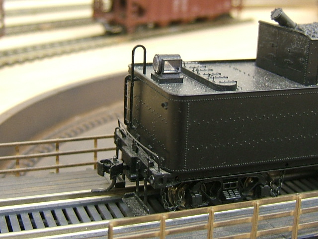

#49
Here I am again....Need some help.. :oops:
I've lost count of the hours I've spent on the net looking for a "workable" back-up light to place on the tender, and have yet to find one. This is a "must-have"...
I've looked in all the "name brand" sites, and some not too well known, but have drawn a blank... Wallbang
Anyone have any ideas..??
Gus (LC&P).
#50
Can you point to a picture of the backup light you're looking for? Or maybe a description? I'd say check the usual sources of details like Bowser, or see if your LHS has a Precision Scale Catalog (unless you want to pay $20 for your own copy). If Precision Scale doesn't have it, then good chance nobody does, or some obscure, out of business detail parts manuf. made it at one time in which case ebay may be the best chance you have.

A photo of the one you want would help - I have a Precision Scale catalogue and also one from Cal-Scale and I'm sure we can find what you need. As for illuminating it, you're probably on your own, at least from my vantage point. Wink Goldth

OK...Here's a pic of the light on my P2K 0-8-0. This is the kind of light I'm looking for. This one has "side-lights", which I really don't need. If the light can be "upgraded" to take a LED or bulb, that's all I need. Thanks for your help.... Thumbsup
Gus (LC&P).
#55
Cal-Scale offers several similar ones, including HL-202, -203, -207, and -210, while PSC shows 3493, 3189, 31291, 31290, 31920, 31919, 32380, and 32482.
If you'd like, I can e-mail scans of the catalogue pages, as there are many others from which to choose. I've listed only ones which are fairly plain, but there are lots of others with visors, various numberboards, or unusual styles. Don't forget that many roads used what we would normally think of as headlights.
Some of the PSC ones come pre-cored and with bulbs, too.
I believe I also have one of those which you show in the photo above.
