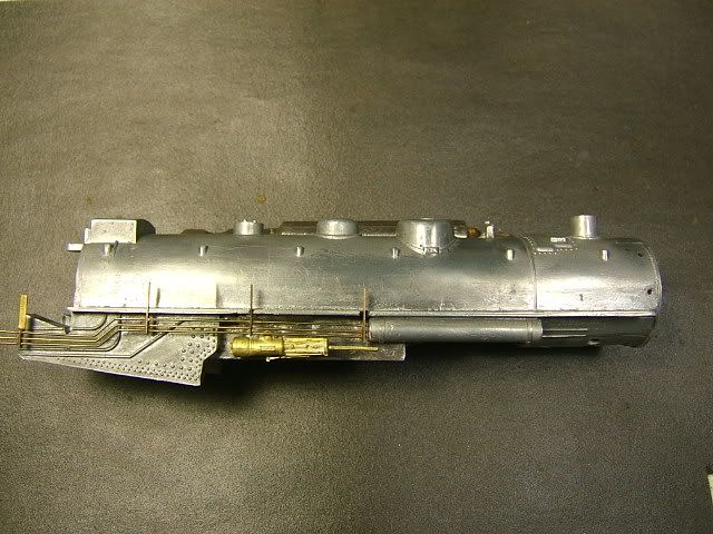

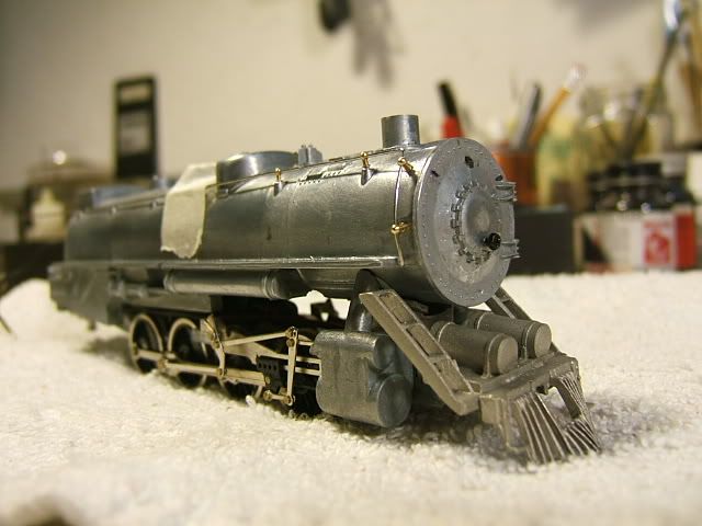

I did the handrails last weekend..Only took me a day and a half to get them right....But I did....
[Image: DSCF2946.jpg]
There's a small glitch here...The handrails rub up against the sand dome, so I'll have to put in a little "crook" to clear the dome and the pipes coming out of it... Curse
And last night I spent about three hours grinding off the cast-in reverse mechanism, and placed the brass one I got in yesterday's mail...
[Image: DSCF2953.jpg]
Question...Now that I removed the reverser, there's a good bunch of "bare" iron where it used to be. Should I trim that back a little..?? Or leave it in place to lessen the "see-through" syndrome these locos are famous for..??
Next up...the turret and placement of piping that I also got in the mail....Getting there.... 2285_

By MRR Cyclopedia vol 1 did you mean the Locomotive Cyclopedia Vol 1 Steam from Kalmbach? If so are there pics of your locomotive prototype in there? If not, do you have a pic of the prototype? If so you might check to see if the sheet is behind the reverser or if it is see through and model it accordingly. A lot of steam engines were very "see through" between the top of the drivers and the bottom of the boiler.
#70
The excess material left where the power reverse was removed could be cut away in a profile following what would be the lower part of the boiler, but chances are it will only reveal parts of the model's drive train - the front of the motor or the side of the gearbox. As Russ notes, many real locos had a lot of "daylight" between the boiler and the running gear, an often difficult situation to reproduce with our models.

Russ & DocW....The see-through "syndrome" refers, of course, to seeing the drive train inside, which does detract from the over-all effect we strive to achieve.
For now, I think I'll leave it as it is....

I'd be tempted to remove the "sheet metal" in front of the reverser and below the air tank. But You may want to temporarily mount it on the chassis before you decide.
