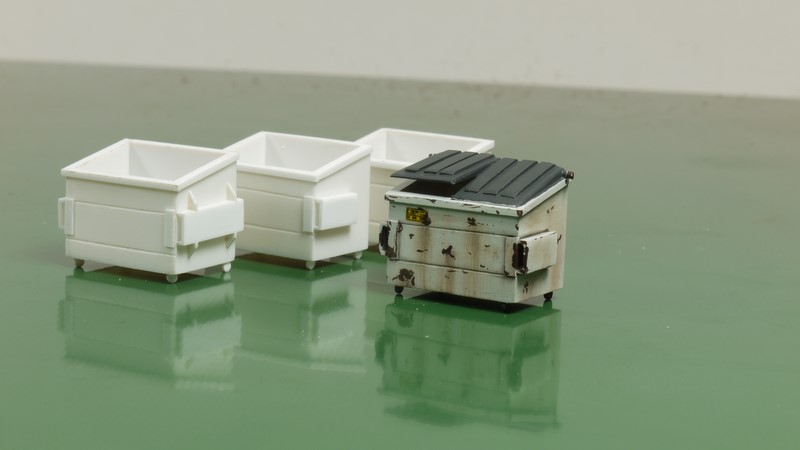

I made my lifting pockets from Evergreen I-Beam - one side sanded down. I have two sizes in stock, too small and too large. I did choose too large 35

Speaking of painting and weathering... I ran into a problem. I can't get a clear colour seperation line between the lid and the dumpster. To avoid masking on the tiny model I decided to cast the body and the lids as seperate pieces and glue them together after painting. Still one mold, but two pieces to cast at the same time.

Gary S Wrote:That is a nice paint job! There is no doubt you are the dumpster-meister!
I can't get over how good yours turned out.
ThanKs for your kind words!

Really? I have one - you have 26. No, wait, its probably 38 right now?

Sumpter250 Wrote:Those are some very nice castings.......I think you've done some of that ( casting ) before, or that is some of the greatest beginner's luck I've ever seen !!
Ummm... sort of misunderstanding. I am still building the master, no casting made yet. What you see by now is glued together from styrene.
