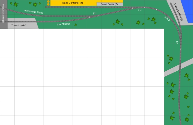

Here is the current track-plan:
[Image: LIRYFINAL.jpg?t=1319078919]
I am not to sure about the upper right area of the layout, I can't seem to get the spur going into Lowes Lumber look right, I am going to try curving it to see if it looks better.

Or you can make the lumber industry a foreground industry for visual interest (maybe with parts of the industry "in the aisle"), and let the mainline curve behind it in the corner.
Concept sketch:
[Image: justin-corner.jpg]
Many options here :-)
Smile,
Stein

Justin, if you move the turnout for the paper company back 12 inches and use the beginning of the storage track for the Lowes, you won't need the right leg of the layout. For 13 feet of layout, I could build an empire.
Mike Kieran

Okay, I have the lumber spur figured out, it looks pretty nice now.

your east wing does not add anything, I would go for something like this:
[Image: 13X9BRAKIE03.jpg]
While John Armstrong was probably very aware of realising as much fun as possible in his plans, it seems
hot to have as few spurs as possible today.
Smile
Paul
Paulus_jas, as drawn, your runround loop is unnecessary as all your spurs are "push in" - unless your ISL company rules insists on departing loco leading (much more fun to have a shoving platform to get in the way and make life awkward!) - however - if you put a righthand turnout into the bottom track of the runround at about the half-way point, and a diamond into the "car storage" track you could add a spur runnung into the Lumber (Lowes?)from the main area, through the trees and across the road, rotate the building 90 degrees and lose the track into it from the fiddle yard - in fact for those who don't have room for the fiddle yard leg, you'd get a good single-shelf switcher Layout. Also , if your fiddle track is full of off spot cars for the industry there, you can't switch the lumber company
Just a thought
Jack
Hi Justin or better Jack,
one spur is facing the other direction.
This why the passing and storage track are handy, the cars can be parked here temporarily, while switching the Lumber CO.
BTW without the additions you could not use that track for off-spot cars at all, since the engine is always at the wrong side of the cars.
The most easy way to switch my version would start with the engine on the long leg, picking up cars from the fiddle track. Switching the industry adjacent to the fiddle track first, then run around the consist and switch the other industries. The passing siding add some extra parking space. Before pushing outgoing cars on the fiddle track a second runaround move has to be made.
I like the idea by Stein to have the train going around the Lumber Co; it is adding visual distance between the two legs. The curve is almost 6 feet long, so the lead has a rather adequate length.
Smile
Paul

Paulus_jas, you are absolutely right - I'm blind as a bat! Humble apologies! 35
Paulus, I was also thinking that it was a shame to not do anything with the shelf on the right. A runaround and a storage track can form a mini yard and provide service to other customers at facing point turnouts. If I had Justin's footprint, the layout would be an industrial park with 22 inch minimum radius curves.
The plan is genius.
Mike Kieran
