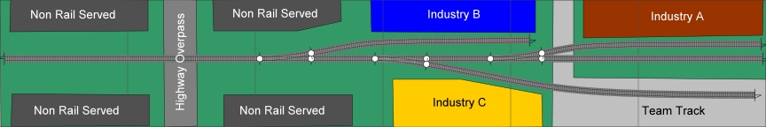

Here's what I'd do with an N Scale version of the Palmetto Spur in your space:
The simple looking track plan is very deceptive and provides quite a bit of prototype operation in a small space. Just a matter of selecting Industries (A - B) that would have car spots for specific commodities. Plenty of ideas can found on The-Gauge.
I also added a third industry on the long lead to the team track area, which could be any number of things - a fenced in tank car unloading facility comes to mind. The team track of course could handle several different commodities for your off-line customers. There is actually enough room between the Industry B and team track turnouts to add a fourth separate track for Industry C if you wanted. And of course we have at least one street crossing to block while switching.
Also put in several non-rail served structures to give it that concrete canyon look and the highway overpass you mentioned. Having tried out an extended version of the Palmetto Spur myself, I can tell you that there is more to it then meets the eye.
Would be nice if you could add a removable staging track on the left side of the plan, if you can find the room and that would allow you to lengthen the tracks for industries A and B a little.
Ed

Ed,The Palmetto is basically what I'm looking for..
There's plenty of room at the industries,I can add scenery and maybe squeeze in a service road.

Guys,I'll use the Palmetto Spur as a guide since the plan is already spoken for but,it will be very similar to Ed's reverse Palmetto Spur plan with some personal tweaks.
As of now I have all the needed Peco switches and half the needed Micro Engineering flex track.The reason I'm behind is because I decided against using C80 (looked to large for industrial track) and I changed mid steam to C55-thankfully I can use the C80 flex that I ordered at the N Scale club.
Here's a plan I did based on my old "Pine Street Industrial" ISL that I built in '95.It was a fun to operate layout that gave me about 3 years of operation enjoyment..I sold this layout in '98.
Larry

Mike came up with a very interesting variation of the Palmetto Spur in HO scale for you (posted on another thread). Since you're modeling in N scale, you should be able to expand this plan quite a bit and it sure looks to have a lot of operating potential.
Ed
