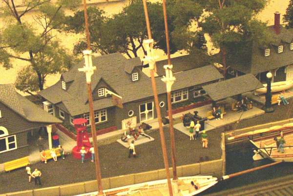

Goldth Goldth I have a couple of "rattlers", because of "CA failure" :o :o
I've used RTV, and may try clear Siliconized Acrylic caulk. The metal/plastic bond could be better if the adhesive remained slightly flexible. The plastic "washers" also have a tendency to break, and release the weight. Wallbang
The red "bell buoy" in this picture, is a heavy, metal casting. The Siliconized Acrylic Caulk, held it securely in place, for the trailer ride to and from "Trainfest", in Milwaukee, Wi. . ( that's about a 120 mile round trip, on less than smooth roads ).
It should work for car weights Wink Smile
