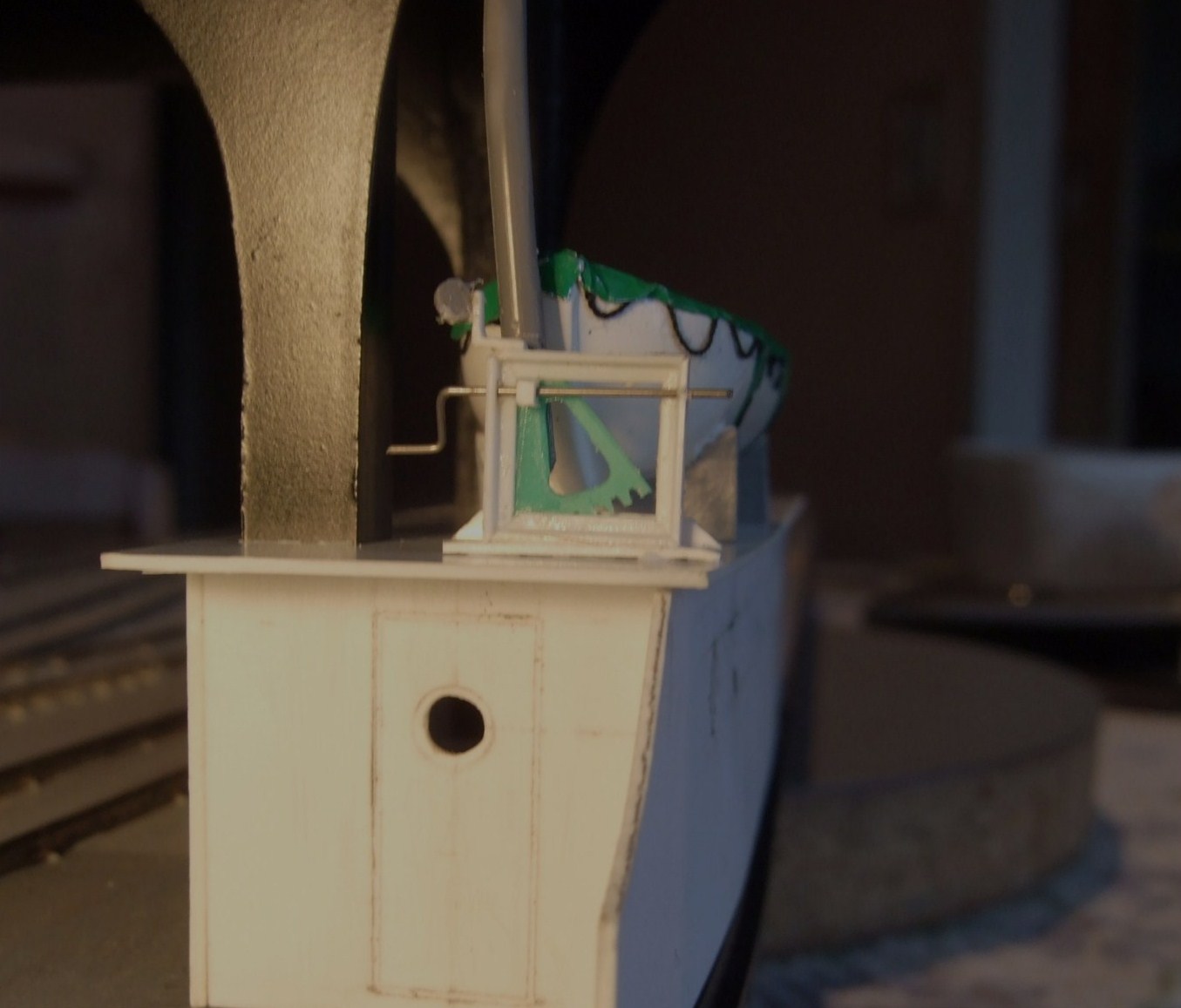

This also involves the placement of the lifeboats on the cabin roof and as I had mentioned on page 2, eighteen months ago, I was, for ease of making and fitting, going to model radial davits. However your collective consciousness has pricked my own and as a result, also after close scrutiny of the photos, I think that a type of quadrantal davit was used, so.....
......while it needs tidying up; I’m actually quite happy with the result. Now I just have to complete five more. 357

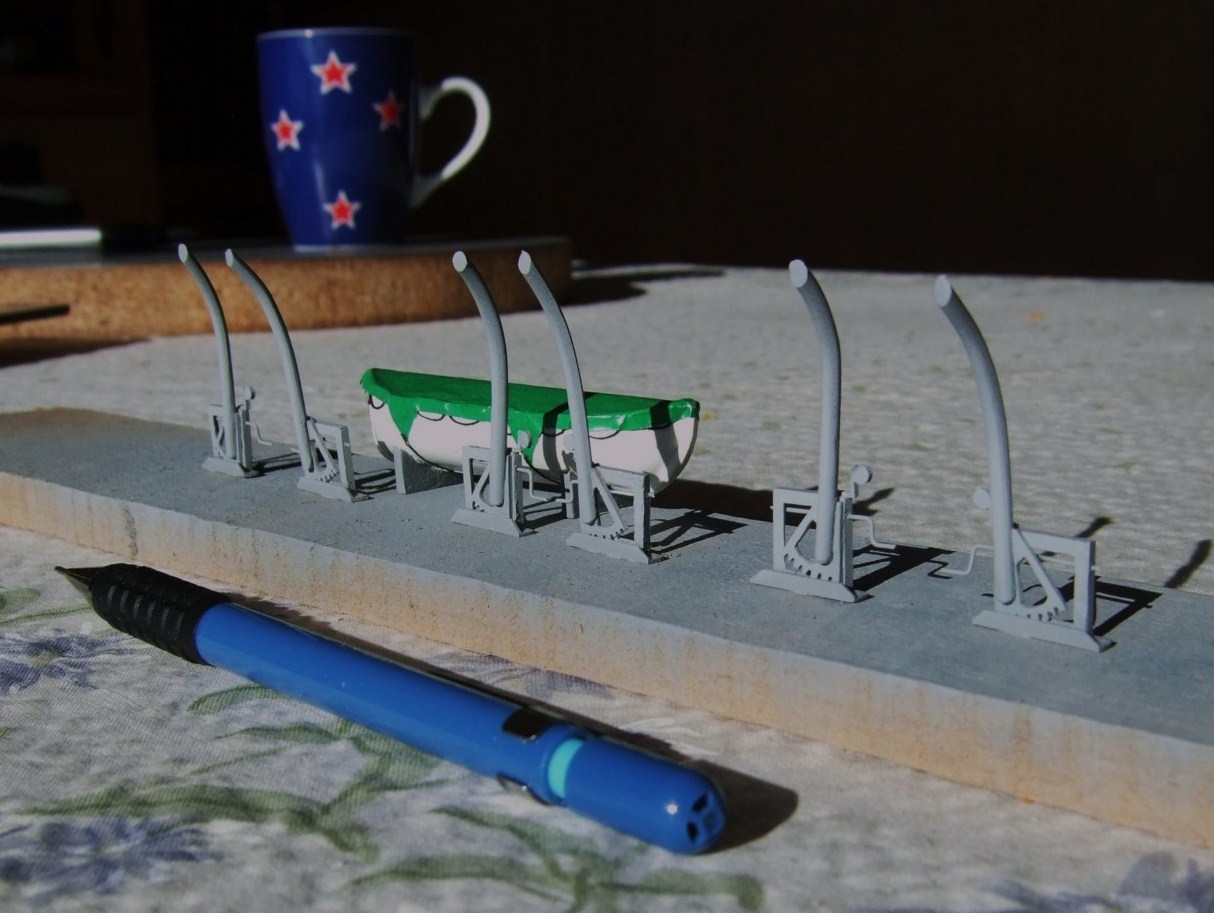

Well it stopped raining in the paint shop.
I find it’s all very well to scratchbuild one item, actually it’s not;  the idea how to make the item may not immediately come to mind and then sometimes I try hard to complicate the build and also over engineer the process. Case in point these davits, I only want them to “look about right” not actually work and have to support the weight of a life boat. Usually I draw a picture to make sure the dimensions not only look about right but that the item will fit in its allocated space and ties in with the surrounds. Having done that, I still find that while building the item it’s often a case of “suck it and see”.
Having made the one item and decided it does “look about right”, and that’s not always a given, Wallbang   the real challenge is to then duplicate accurately the rest.
I can see the differences but as long as I stick to the “Three Foot Rule”(with one eye closed)  i’m pretty happy with these.
Thanks for looking, Cheers, the Bear. Smile
They look more than acceptable to my eyes. Nicely done. Thumbsup Thumbsup
Thanks Wayne, I’m still mulling over how to simulate the blocks and tackle, so will change direction. It’s not that I don’t have enough other tasks to proceed with on this build.
Cheers, the Bear. Big Grin

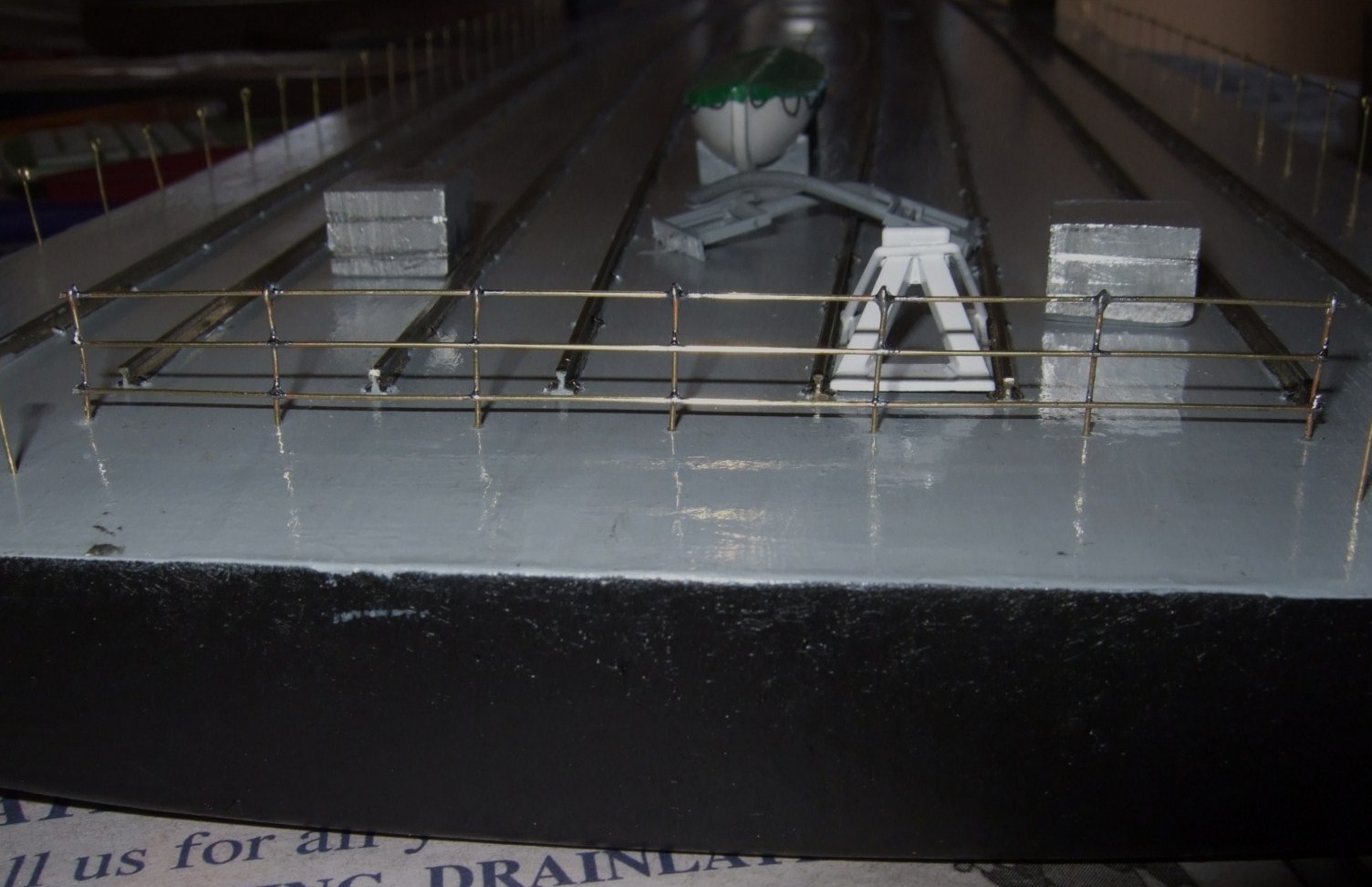

Instead I have started the railing, “One small step for Bear.......
