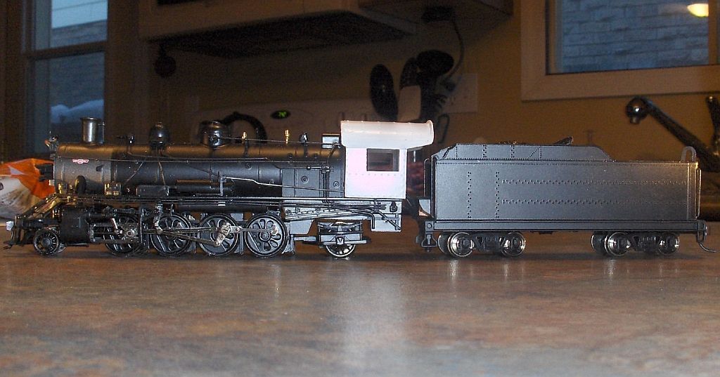

Posting this across a couple of forums hoping to get some quick and good advice:
Okay so I have been playing with a scratchbuilt cab on a Bachmann Mike to do a freelanced back date on it. I have now made 2 attempts to apply an .015 wrap of styrene that I studiously embossed with rivets. The initial application looks good but after a few minutes the solvent cement starts to attack the .015 causing wrinkles and bubbles. Second attempt I used less solvent but with the same result. I was using Testors liquid cement as in my experience it tends to be the least potent of the ones I have worked with (plastructs and ambroid being the other liquids I generally use).
I have now had to re-sand the roof of my cab twice and I am not sure if my nerves or the cab roof will take another failed application. I know some of you apply styrene wraps to scratch built tenders with success so what am I doing wrong? the cab took a few hours of messing to get the roof line right and it looks amazing except for the missing rivet details.....
I do not want to give up on this!
HELP! Wallbang 35

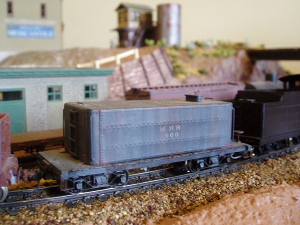

I have done the same, and have had the same issues. I don't remember what thickness styrene I used, but I recall using testors liquid cement (in the square bottle), putting a few drops on, and then spreading it out to a thin layer before applying the overlay. In some cases, it did not hold the overlay real tight and I had to re-glue the corners, using small drops of glue applied with a straight pin. The trick I found to keep it from warping is to use the glue sparingly, and spread it thin before applying the overlay. It still warped some, and like you I had to redo some areas. The styrene does not take rivets nearly as well as thin brass, so next time i do something like this, I may do a brass overlay and secure it to the body with CA or some kind of contact cement. In the water car below, the overlay is all styrene, except the corners, which are brass.

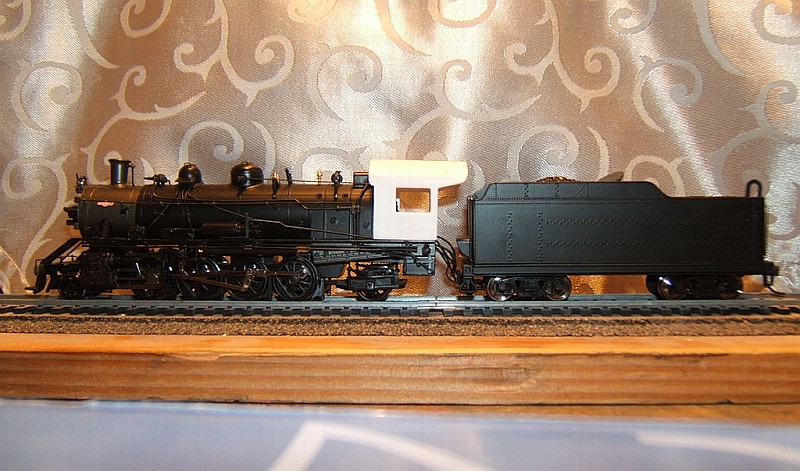

Success!! It would seem I was using too much cement. I was advised to use a soft paintbrush rather than the brush in the testors bottle and it worked! I was able to apply the roof wrap and then got all ambitious and applied the laminations to the sides of the cab as well and then the smoke deflector. Didnt have time to set up proper lighting but here is the progress shot. Now I just have to frame up the windows and add some trim
