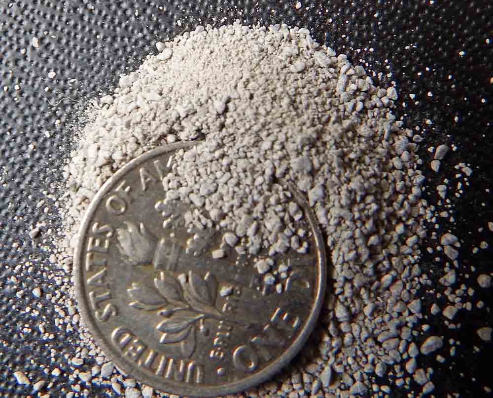

There was enough here, once screened and dried, to do my layout (over 1000 feet of HO, and I donated some to 5 other people. The larger size that wouldn't go through the screen, was donated for a large Lionel display put on by some friends, and I still have about 10 pounds of HO, and about 100 pounds of fine ( that went through the splatter cover screen) that would be quite nice for N.

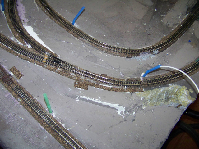

Started to wire, and just thought I'd pass on something I've been doing for a while now. I'm drilling through a couple of layers of foam and two sides of a hollow-core door, and found an easy way to get the wires through, using straws. I don't know if this is a common way to get the wires from one side to the other, so it may not be unique, but here it is anyway.
I drill a 1/4" hole through everything then push the straw through the hole. I then push the wire through and tag the end. The wires will eventually go to terminal strips. I'm using solid wire, so it's easy this way. I did use stranded wire at one time and found it was easier to push the wire through the straw first before putting it in the hole. This all saves lots of frustration and frayed wire ends. Once the wire is cut to length, I just pulled the straws back out, leaving the wires in place. I was even able to color-code the wires using different colored straws.

I use doorbell wire is it comes red and white together for .06 cents a foot (.03 per wire) and it is solid not stranded so it is very stiff, When you straighten it it will go thru a 1/4" hole thru those layers with no problem but if you use stranded wire then the straw is a good work around.

(06-18-2019, 06:31 AM)Tyson Rayles Wrote: I use doorbell wire is it comes red and white together for .06 cents a foot (.03 per wire) and it is solid not stranded so it is very stiff, When you straighten it it will go thru a 1/4" hole thru those layers with no problem but if you use stranded wire then the straw is a good work around.
I've used stranded in the past, but I've got a 1,000' roll of #22 solid security wire (red/black). You're right, I probably didn't have to use the straws this time, but I think it made things go a bit faster anyway. I like the solid wire, easier to solder to the rails. I used to have a long drill bit with a hole in the end. Security system installers use it to drill a hole and fish the wire back out at the same time. After several moves, it, like a few of my other tools, have disappeared. Not to worry, I'm not doing much in the way of security installing anymore and I have straws to help wire my layout...

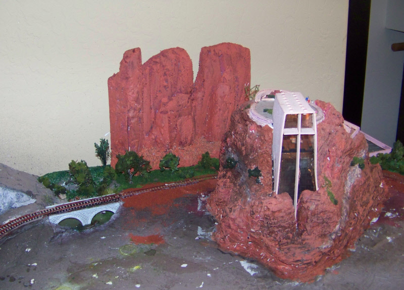

Great progress Days. Great color on the rock spires too. I too keep forgetting the progress pictures so I don't have much to post on my layout, but work is continuing.
