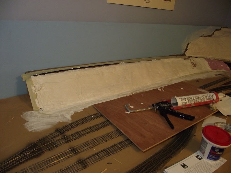

I did glue and staple the scenery forms in by the future town of meadows. Since I was using 1/8" plywood (also know as door skin) I was able to form it around the curves of the upper decking. now you can see the dimensions that I can work with to plan the townsite.

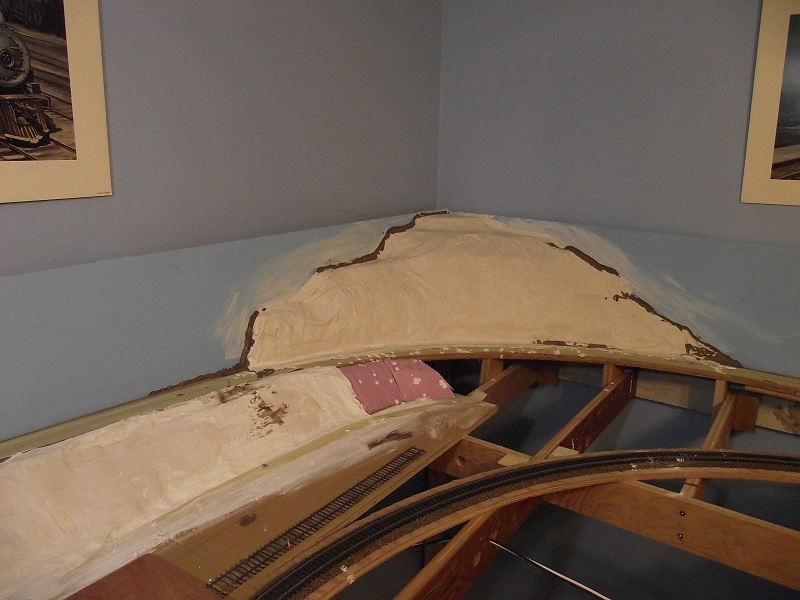

And I got the hardshell down on my corner mountain. It was a bit of a stretch to lean over and lay down hydrocal-soaked paper towels without making a mess (I failed on the mess part) but I need to get this part done and sceniced before I can proceed with any other scenery. The brown 'goo' around the edges is some mocha colored caulking that I used to seal the gaps between the hardshell and the backdrop. When its all dried I'll paint it in the same base tan before adding adding rock castings and ground cover.
While I was at it, I completed the hardshell on this slope as well. I'm learning these technics all over again since the last scenery of this type that I did was over 10 years ago.

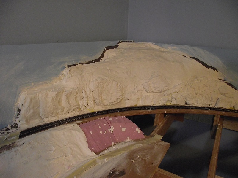

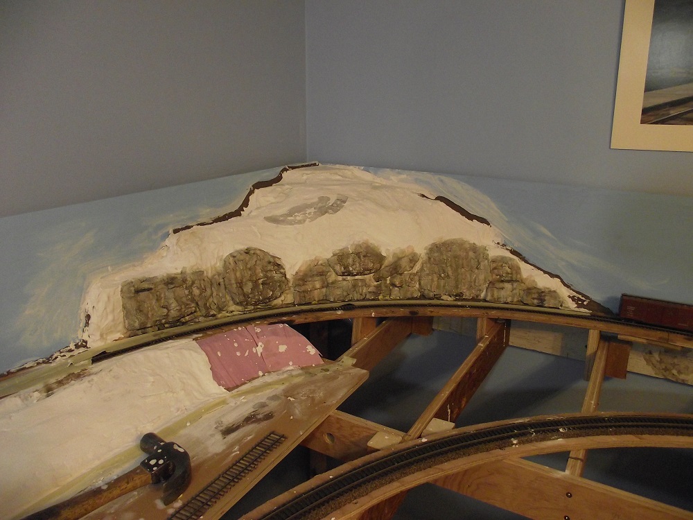

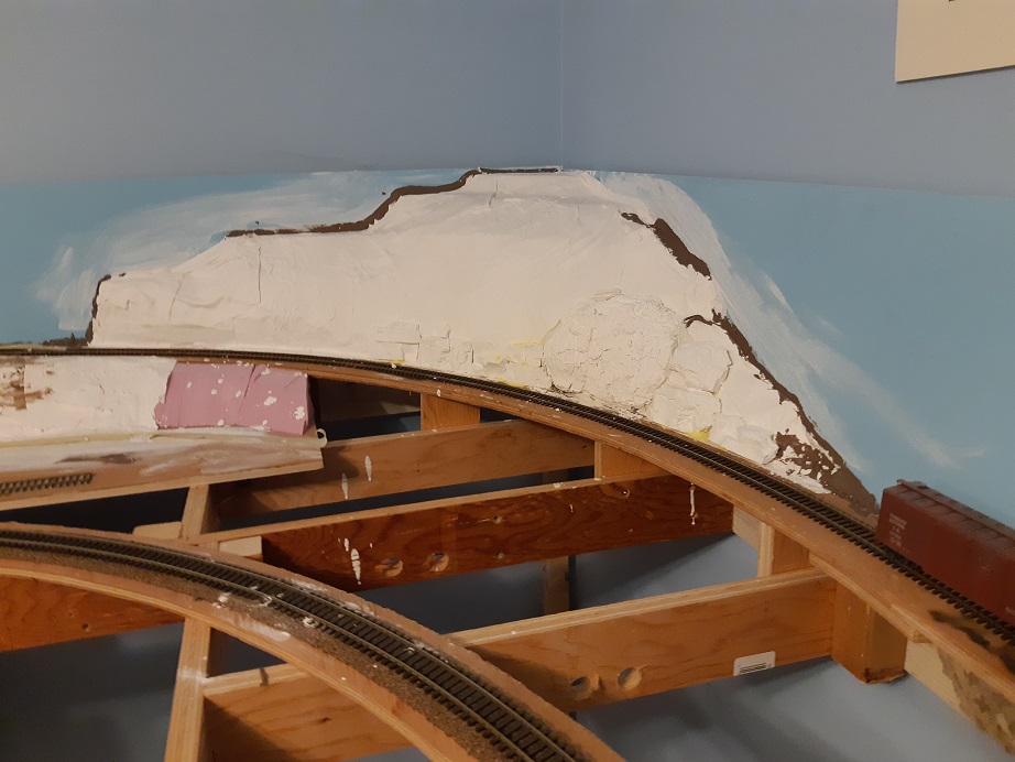

I started to add the rock castings when I found that I had made the mountainside too close to the track and had to pull half the mountain down to trim it back on one side. Then I re-hardshelled the area before I add the rock castings.
During this time I ran out of Hydrocal so I went to a nearby building supply dealer and picked up a 50lb. bag. That should be enough for the entire layout, plus some. I did have a strange thing happen when the first hardshell use of the new bag turned a light gray instead of white, my next application was white.

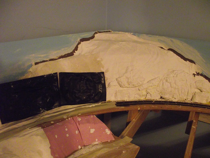

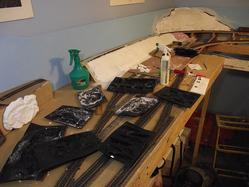

And this morning I mixed up some more plaster and blended in the castings to the mountain. Tomorrow I hope to start staining/coloring the rockwork. Any holes/gaps between the casting are going to be filled with bushes and other vegetation.
And these are the rock molds that I used, sorry for the mess. A member of our club passed away about 6 months ago and we inherited his scenery supplies which included almost 20 WS rock molds.

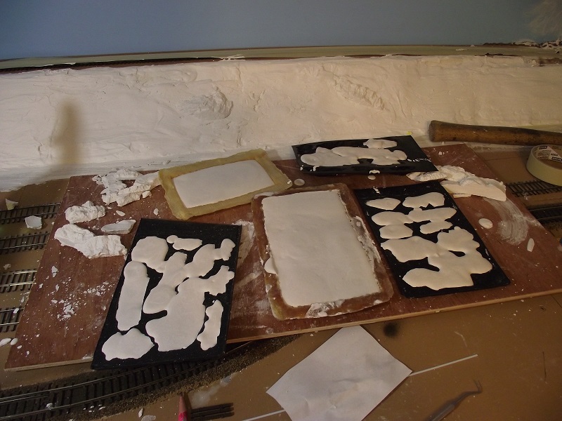

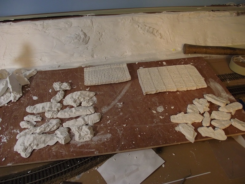

While I was using the hydrocal I made a few extra castings of surface rocks and outcroppings that I'll use in other places as I go along. I also cast a couple retaining walls.
I like the timber retaining wall casting. I've been casting a couple of them at a time so I can later cut them up to use them in future areas.
The one place I do plan to use them soon is the section between the town of Meadows and the stamp mill. I think the three should do it. I'll stain the rocks between the timbers like the rockwork I just completed and then stain the timbers with a stronger solution of raw umber.

That second photo looks like 5:00AM at the bakery...get 'em while they're hot, folks!

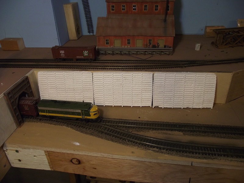

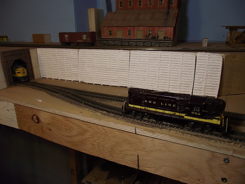

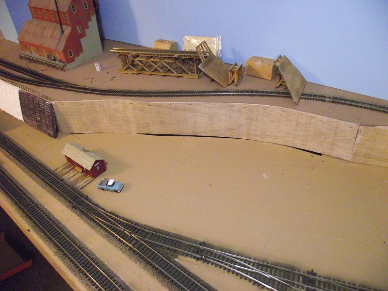

Thanks guys. I've since painted the mountainside and will be adding ground cover in the next couple days. In the meantime, I've started to look at the other end of the layout, where the retaining wall is going up.
I took some of the retaining wall castings to work and cut/trimmed them with our chop saw. I wasn't sure how the cast hydrocal would cut with an aluminum cutting blade. Either it would cut through like butter or the casting would explode. Fortunately it was the former, not the latter but it did create allot of fine dust when cut.

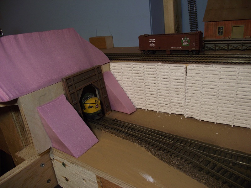

I've also been wondering what to do with the tunnel portal an it's surroundings. I don't want to make things square and awkward looking.
This is what I've come up with. A slope on either side of the portal, but not long enough to block the turnout. I was thinking of tunnel abutments on either side of the portal and the slope running into the retaining wall. Above, the slope would continue to form a hill that the upper track would have a 'cut' through it.

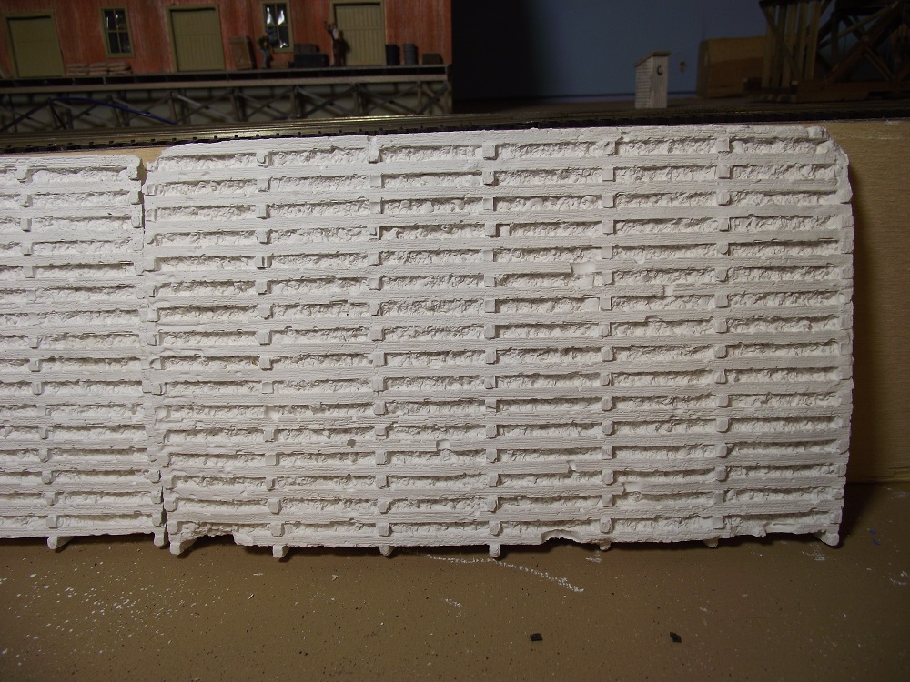

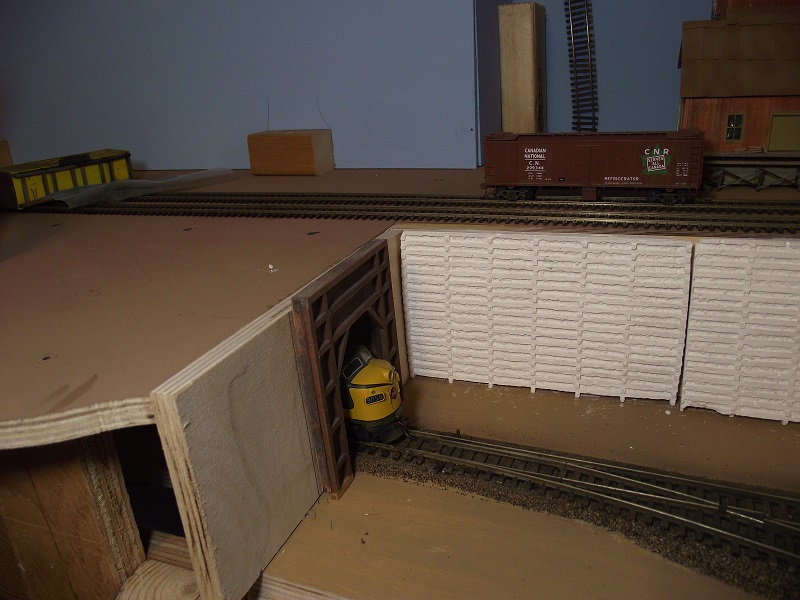

Still playing around with the retaining wall castings and the tunnel portal.
I scratchbuilt an abutment for the tunnel out of some 1/8" plywood and 1/8" square stripwood. I painted it with some burnt umber to simulate treated timber. My current plan is to create a narrow slope between the abutment and the cast retaining wall.
Speaking of the retaining wall castings, I've noticed that the ends have a slight curve or bowing to them. I'm going to cast a couple more and then cut the ends flat and square using the saw at work for a better fit.
