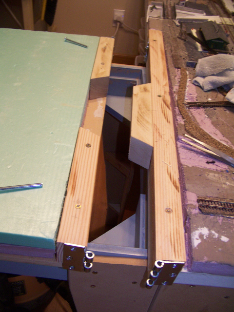

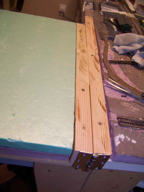

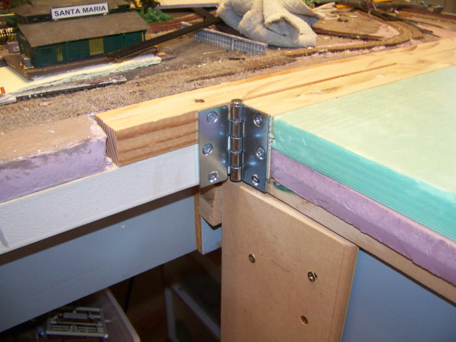

We have a solution, but first, a side story. Years and years ago I was building a display booth for a trade show in LA. The union rules there would allow me to assemble my booth if it took one man less than 1/2 hour, otherwise I would have to hire some very expense labor. My thought was to build some boxes and to join them with some flat panels using removable pin door hinges. It worked fine to the dismay of the union supervisor who wanted me to take it down and prove I could assemble it in less than a half hour.
Now with that out of the way, I decided that my first design would not work because there would always be some wiggle room with the pins, so, remembering my experience with the booth, I changed the plan as follows: I cut the edge board into three pieces at 30 degrees for horizontal alignment. The MDF slips under the center board to keep it aligned vertically. Two hinges keeps everything locked together securely and prevents misalignment. I can now separate the two and lift either section up to get to the wiring and everything goes back into alignment afterwards.

Nice solution. Looks solid.

Don,
this is a really solid connection
Lutz

Yeah, that's what I need, now to add the track and check it out.

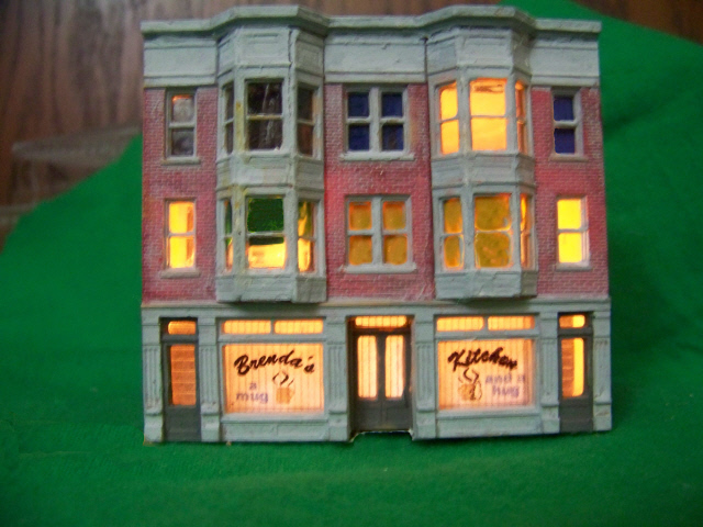

We had a wee little incident in downtown Santa Maria. Seems as though the firehouse burned to the ground while the firemen were off having their weekly picnic over at Pat’s bar and grill. When they went to rebuild, they found that the town didn’t own the land it sat on and so they had to move next to the train station. Being el-Cheapo’s, the town council used the old blueprints from the one that burned down and built an identical one, so if it looks familiar, you know why.
Now that there is an empty lot on Main St., the real owner, Dewey Cheetum, was located and moved quickly to fill the spot with an older 3-story Victorian. Brenda’s Kitchen moved into the first floor store giving the town a second restaurant plus a bunch of decrepit, unfinished and overpriced apartments. Was everyone happy? Not a chance.... The firemen have to go farther now for their picnics, Dewey is upset looking for renters, but the cops are overjoyed, having coffee and donuts right next door.
Just a few shots before the building was moved to its new location:
Just so you know, but I think the interior of Brenda’s is highly detailed, booths, tables, chairs, coffee and soda machines and even cups, plates, napkins and silverware. It’s just that because the sun hits the front windows early in the morning, the new owners added window blinds (really did happen), blocking the view of the interior. You would be able to see the kitchen details by opening the back door, but, alas, that too can't happen. It could be all there, I'm just not sure....

Hello Don,
Brenda's Kitchen,
some menu specialities:
- Leberknödel out of Rosenheim
- Coffee as black as a night could be (this is no dishwater!)
And i think the men of the fire departement (and the town council too) were very glad, that their fire engine was not a victim of the fire.
Lutz

Those are some good-looking structures, Don!

Thanks guys, Lutz, fortunately, they were using that fire truck to get to their "picnic" so they could park in the fire zone. I'm not saying that was right, but it was legal....

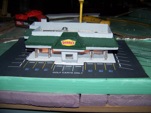

Got some progress, took me a few weeks to get Denny's back together. No, not 24/7, just glue and clamp something, then wait. Touch up or repaint something, then wait.... Go back and glue or paint something else, and wait. I thought it was in bad shape from being moved around, until I started working on it and it basically fell apart.
Anyway, this is what it looks like now and where it will eventually wind up. It is temporally in place, as is the wiring just to see if it still lights and fits. Still needs a bit more work and some paint touch up, but it's close to being finished. And yes, all the signs and interior does light although it's hard to see from these photos.

Yes Don,
a from basics up renovated diner
Lutz
