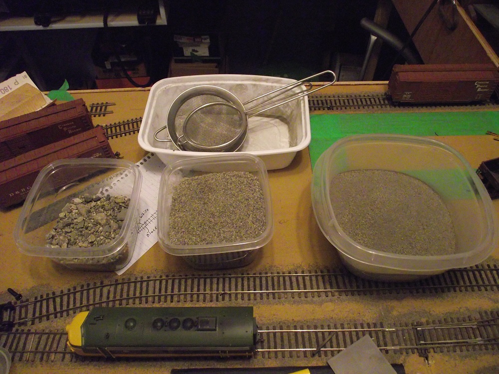

I also bought a second kitchen strainer and now I have three grades of ballast:
Well more like two. the largest are more like large rock and boulders in HO scale, the next two are more the sizes I'm after. The medium is a bit smaller that the Woodland scenics medium which is what I'm aiming for. The fine would be more for sprinkling in on the edges after the initial ballasting. The fine is almost too fine and fairly dusty. I'm wondering what it will do when soaked with glue. I'm going to experiment a bit before committing to using it on the layout.

I also experimented a bit with the sifted roadbed that I pick up a few weeks ago:
I ballasted a sample track using the fine on the left and the medium on the right, Gluing them both in with the mod-podge scenic cement.  I then compared them to some unglued medium ballast. Initially both the fine and medium ballast darked considerably but the medium lightened to its original shade when dry. The fine just looks like mud so I won't use it.
Not quite sure about the medium stuff, I was looking for a branchline type ballast with a cheaper grade look to it. Opinions?
I think that the chunkier stuff looks better. Way back when I did N scale, I used some "fine" ballast and it looked just like Polyfilla -- no texture at all.

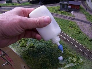

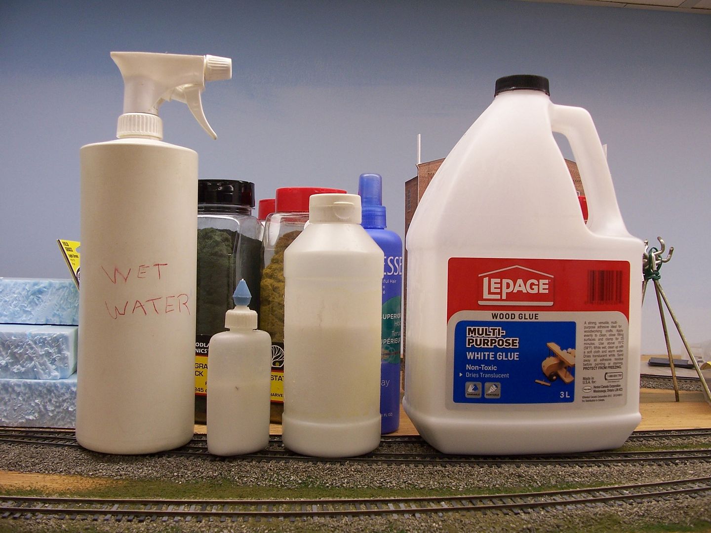

To affix the groomed ballast in place, add a few drops of dish detergent into a sprayer filled water (if your water is overly hard, use distilled water, which is available in most grocery stores in gallon jugs.  (A cheaper alternative is to use water collected in the bucket of your dehumidifier - (be sure to clean the bucket thoroughly before turning the dehumidifier back on).
Don't be too stingy with the water...I usually spray upward first, so as to not allow the spray to move the ballast.  Once it has been dampened, you can spray the ballast more directly.
To affix the ballast in-place, I use ordinary LePages white glue, mixed about 50/50 with water....
Depending on how deep the ballast is spread, it may take quite some time for the glue to set (I had some alongside the track that was almost an inch deep, and it took almost a week to fully harden.)  For track on roadbed or directly atop the layout's surface, the ballast should be firmly in-place by the following day.  Once the glue has set and is completely dry, do make sure to clean the tops of the rails, as any glue on them will interfere with electrical contact.
