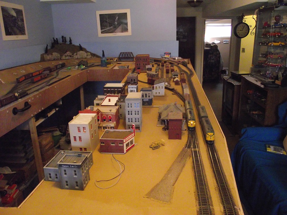

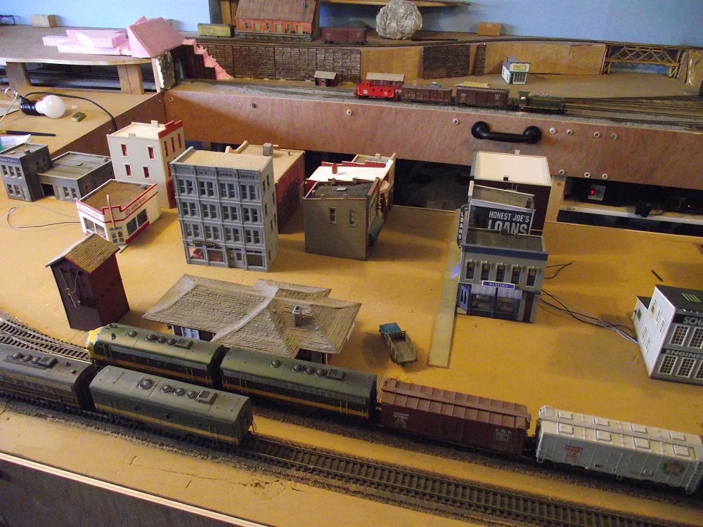

After completing Schaake's Machine shop, I decided it was time to start figuring out the layout of the town of Blackwater. I pulled all my buildings from my earlier layout and a few others that I collected and started to arrange them.

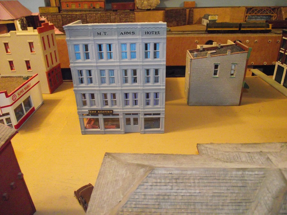

What I'm thinking of is a main street that parallels the  track and runs past the station. Across from the station is the M. T Arms Hotel with two streets running from the station of either side.
The Hotel is from the previous layout but I cut the original building down width-wise to accommodate it in it's original spot.    I'm planning on replacing it with the same kit, without modifying it.
The road will run past the corner cafe' with the blue trim, to The Machine shop and to the local Gern plant. The Gern Plant was a modified DPm Scissor's Cutting Co. I have a second kit that I will either add to this one or replace it.
I was also going to have  the road continue around the back of the Machine shop and cross the track to the other industries but I think I'll make the road access to that area off-layout.
The triangular building is a Furniture shop from the previous layout that I scratchbuilt. It looks like it will fit nicely between the two tracks. At the back you can see where I'm halfway through tracklaying the last siding, just need to start spiking some rail.

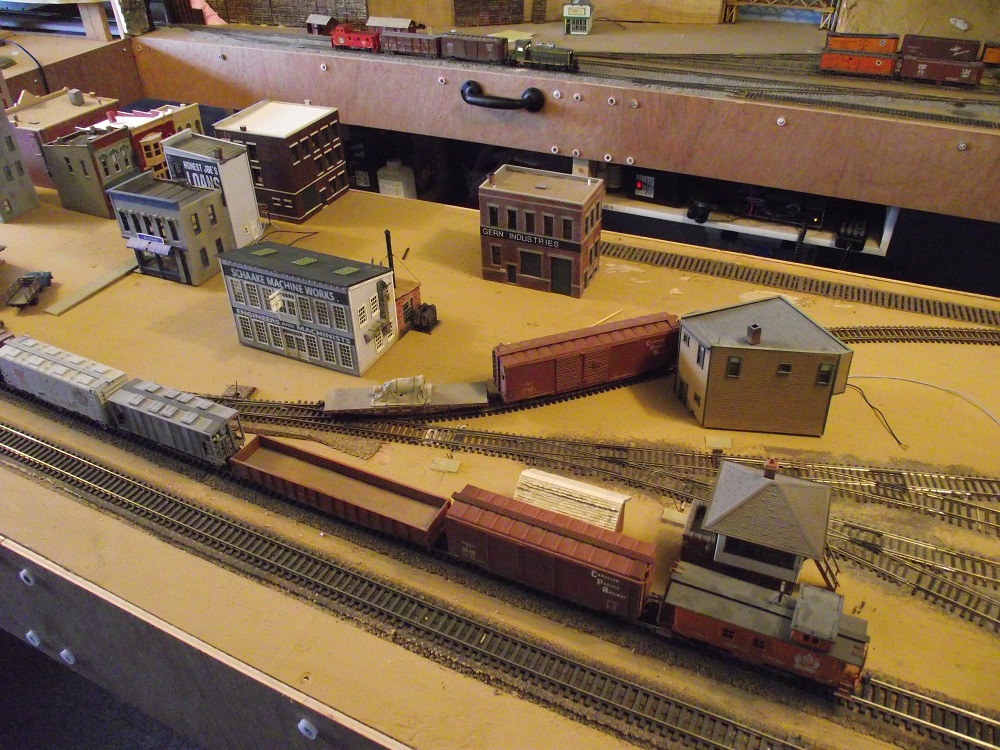

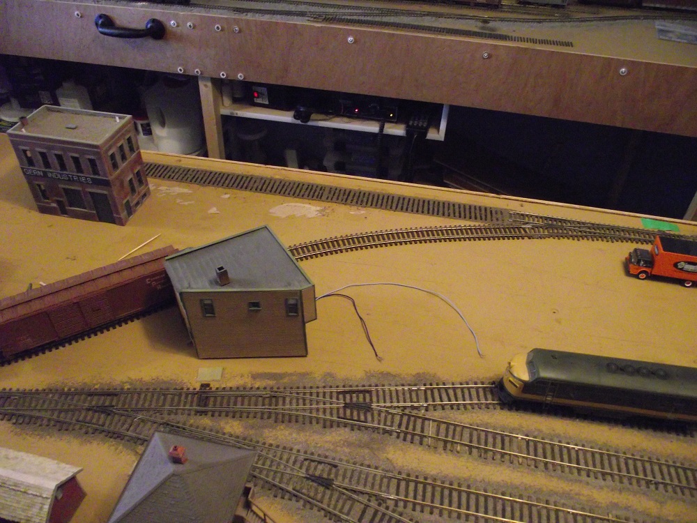

I finished laying the last section of the city industrial track:
It seems as though every time I start handlaying again  I misplace the drill bit that I use to pre-drill the spikes. This time I got a extra bit and left it in the container with the spikes. (I may not be fast but I'm slow)
This was originally going to be a team track but it will be the Gern distributor's track instead.

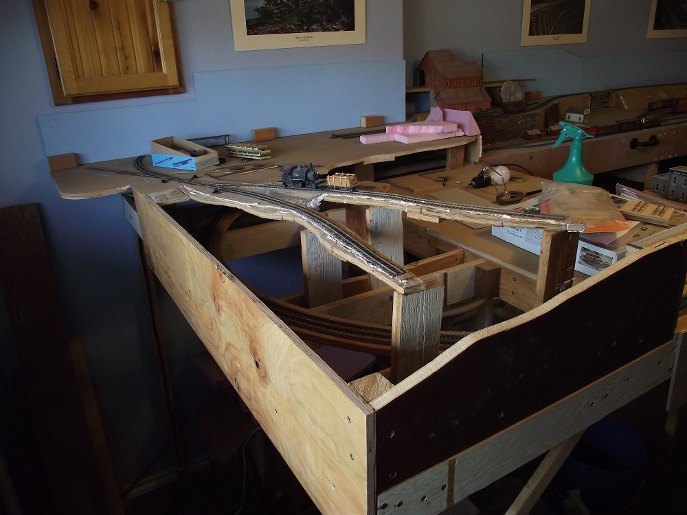

After that bit of tracklaying, I turned back to the Narrow gauge logging line. With the outside perimeter boards in place, I extended the one track 7" to the edge of the layout. This will give me a it more room as well as an option for extending the layout in the future (every inch counts) I'll be spiking the rail down in the next day or so. After that I plan to add the fascia to the outside so I will be able to mount by control panel the wire the Logging branch back up. When I built this into the previous layout, it was straight DC. I don't find it necessary to wire it into the rest of the layout's DCC system.

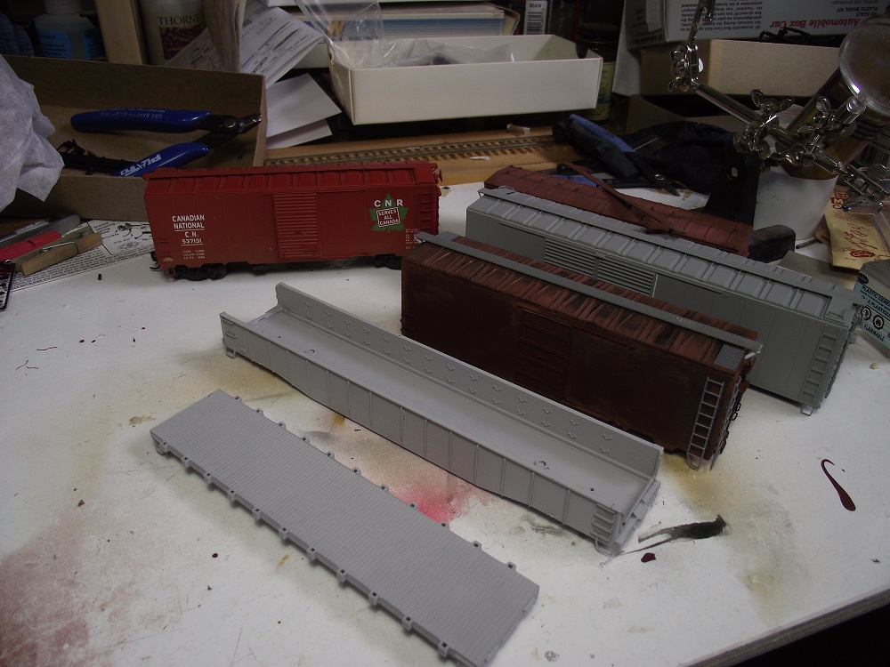

The turntable project is delayed for just a bit while I'm waiting to see what I left behind at the sellers place. I should get over there later this week. In the meantime I've been working of some rolling stock projects:

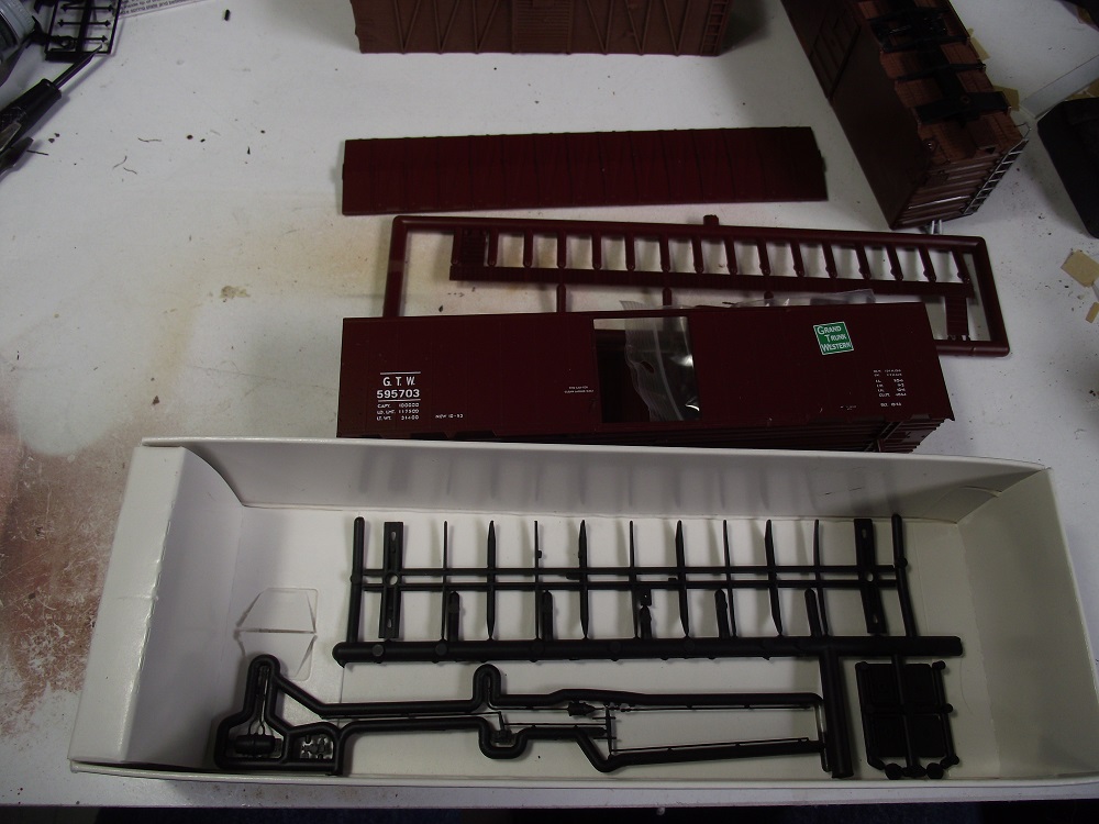

Starting from the front I'm working on a Walthers work flat in CN, a Proto2000 gondola in PGE, a front Range boxcar in CN, a Proto2000 50' DD boxcar in CP, an Acurail boxcar in CP, and I believe a branchline 40' boxcar already lettered in CN.
And a Branchline 50' boxcar in Grand Trunk.
I'm doing a whole batch because they will almost all be in boxcar red/ Freight car brown and it's easier to paint them all at the same time.
