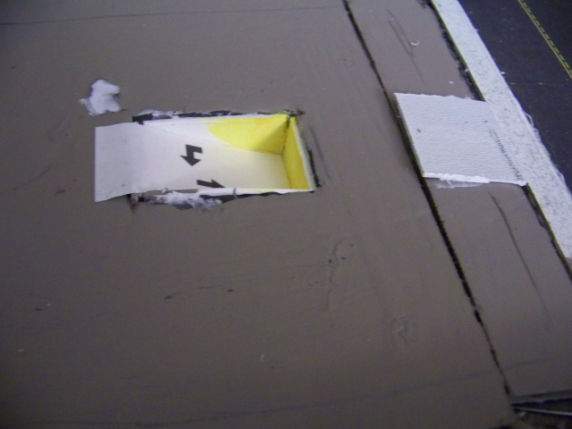

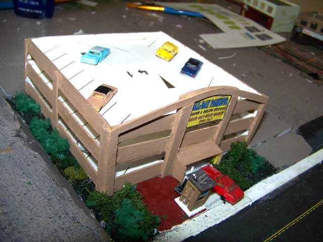

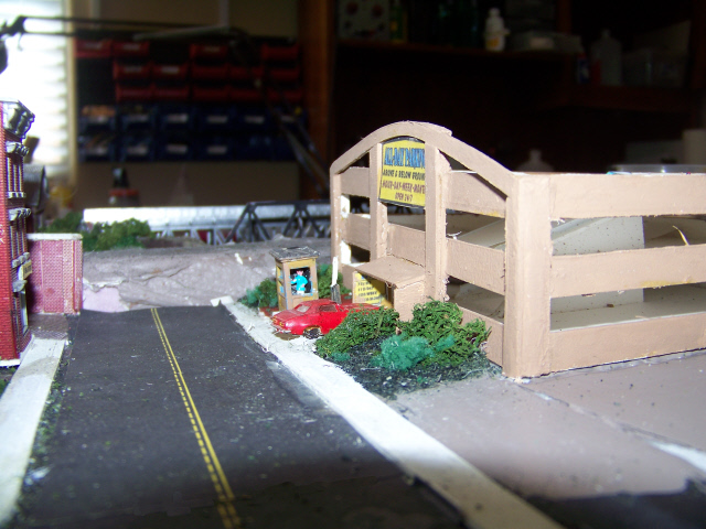

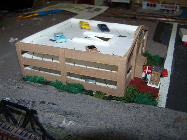

Got the parking garage painted and planted. Just a couple of big mistakes cost me a lot of time. First, I should have used balsa instead of plastic. The plastic I used was easy to cut and shape, but too difficult to sand and water-based paint doesn't adhere well. Second problem was that I ran out of model glue and used a substitute. "drys fast and clear" it says on the package, what it didn't say is that it doesn't dry hard. It stayed gummy and pulled like taffy, making getting rid of any squeeze-out a super tedious process.
Anyway, here's the results of my efforts. And the underground ramp I built was all for nought since it is not visible from any angle by humans. Well, I know it's there and I guess that's what counts....
Somehow I thought that I posted a shot of the lower ramp leading to three more levels of parking. Here it is before the building went up;
