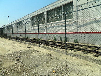

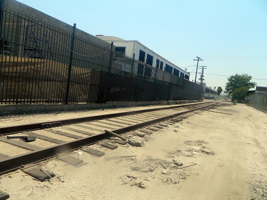

Pictures of your new industries reminds me of the LAJ ballast. We didn't walk down the east end of LAJ's Upper Alley Switch Lead (S&W Fine Foods is on west end). The first image shows no ballast at all on a spur track! In second image it looks more like ballast on the lead is an afterthought since there's so little of it. Also there's no roadbed on either.
