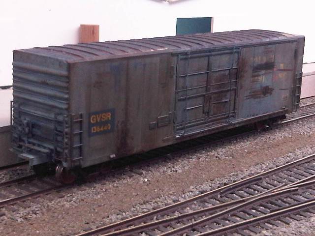

One more piece of rolling stock done...loads more to go... have done no structure or scenery for a while now but have been enjoying the od session which I have not done much of!!
The layout is looking good and the weathering job is great!

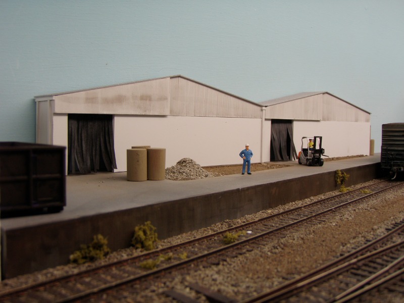

Inland Container (Biglerville, PA Facility) has a recycling area where waste papre is loaded into box cars, and if you have a look at the plant on Bing Maps/Google Earth you will see this old "shed" style unit right along the track side....this also often doubles as the place for the Caustic Soda tanks to off load...thanks ED (FCIN)
Here is the prototype:
And here is my attempt... Please note I still intend to add the details like poles, rubbish, old containers etc. This was built up this afternoon and I am happy with how it turned out considering how out of practice I am...
Hope you enjoy the pics.... Need to try get motivated to do more on the layout but have been very focussed on work... Hope I can muster some new stuff for you guys in a few weeks!!
Please comment...if you want...

Great job Cal! As usual, your structure mockup's look better than a Walther's kit! You've done a really nice job of capturing the look of the Inland Container "lower dock" area - in fact, the entire Inland facility. Very inspiring and perhaps will get me motivated to work on my own layout some more. Haven't touched it for over three weeks now!
Ed
Everything looks great, as always.
One detail I haven't seen modeled before and really love - those rubber curtains over the doors to keep the heat in while allowing the forklift to move in and out. Excellent work!

Stein, in Norway they might use those curtains to keep heat in, but in Southern Cali they use the curtains in refrigerated warehouses to keep the heat out!
Russ Bellinis Wrote:
steinjr Wrote:Everything looks great, as always.
Smile,
Stein
That would also work :-)
The industries modeled could be anywhere from Florida or Southern California to Minnesota (where it gets a lot colder than in Norway in the wintertime, and a lot warmer than Norway in the summer time).
