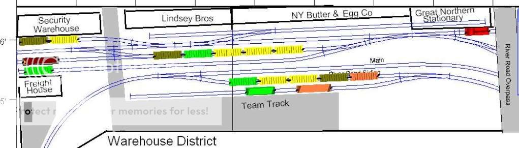

Overall track plan looks like this now:

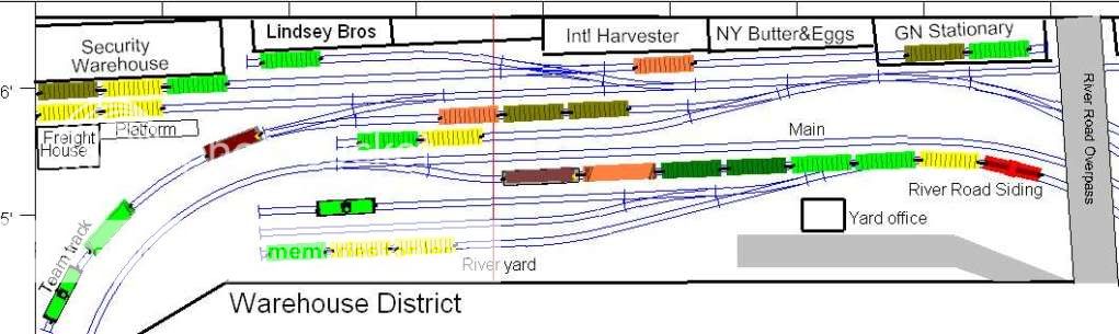

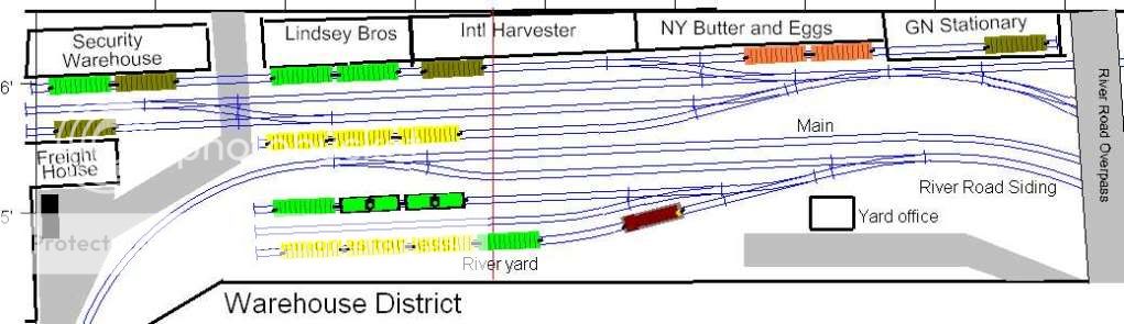

Here is four alternate track plans for the warehouse district:

As for the plans, well, without spending too much time doing virtual switching, it's hard to say which is best. Looks like 6 of one half dozen of another to me.
A couple general questions/considerations.
First, the double slip on plan J. I know we modelers use them as a device to compress space & reduce the # of turnouts, but would the prototype have used one in an industrial district like that? I'm not saying that should stop you from using it, but from the modeling perspective it may not be as reliable as the regular turnouts it would replace. And having to reach across the layout to fiddle with a turnout, well, it better be bullet proof when you install it.
Second, how does this area balance the traffic levels from staging (and other yards/storage tracks)? I like to think less is more, but sometimes more is more interesting. How much paperwork do you want to do (car cards/waybills) and will including or removing an industry or two change that? I'd be tempted to replace Robinson Bros. or NY Butter & Egg with the back side of a tenement or an abandoned/condemned warehouse, something with some scenic potential.

Stein - I lke number 4 mainly because you don't have to interupt business at other industries, in order to pull cars out to get others in! Happier customers!!

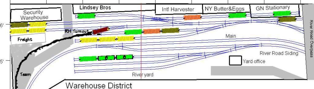

What about removing the left hand turnout near the loco, and replacing it with a right hand? then you could curve the tailtrack currently feeding the freight house round, move the freight house into the clear area (or make it into a triangular building), and continue that track to the road/yard area and use it as a team track. Say if you don't follow what I'm suggesting, I've copied the track plan and drawn it in - sorry for the rather wiggly track!

What about removing the left hand turnout near the loco, and replacing it with a right hand? then you could curve the tailtrack currently feeding the freight house round, move the freight house into the clear area (or make it into a triangular building), and continue that track to the road/yard area and use it as a team track. Say if you don't follow what I'm suggesting, I've copied the track plan and drawn it in - sorry for the rather wiggly track![ATTACHMENT NOT FOUND]
Hmmm - that would work too. I misunderstood you a little - I thought you mean to have the tracks above the freight house be a team track (and a second track for unloading stuff into the Security warehouse when things are busy), something along these lines:
I was so fixated on the back row that I forgot to consider doing something more interesting with the freight house. Much better to use that area more efficiently and curving track down that way!
Mmm - actually - a better idea to let the team track run down there, and preserve the "canyon" look hiding the end of the tracks between the buildings at the far upper left corner of the layout - I can extend the loading area for the freight house without making access too bad by having a platform in front of the rightmost part of the freight house track. Something like this:
I'll go play a bit with tracks to see what I can do with a building along the wall behind the team track and room for trucks by the team track.
Thank you for getting me going again!

Yes - either way would work, but - as you say - the second version keeps the "canyon effect". Sorry for the poor amendment to your drawing - if I'd had the XTrkCad file it would have been more like yours!
I have to admit that a team track makes a very useful "any Industry, any Freight car" place to put a car without having the industry physically on the layout. The other thing that would work in there would be a grounded container, fitted with an electricity supply from a pole, with a pump facility in it, and hoses that connect directly to tanker trucks and rail trucks - then you could run a couple of tank cars in there and have your "Fuel dealer" somewhere "off-layout". There were some photos, about 18 months back in RMC, of just such a thing

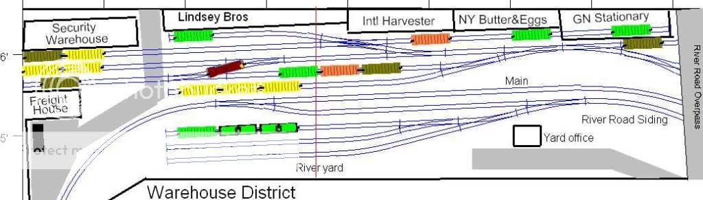

Got the new track configuration laid out for the warehouse district today. Turned out I had an error in my drawing - the module boundary was further to the right than I had on my drawing. Must have done a calculation error when going from centimeters to inches hock:
Lucky mistake, though - turns out I have more room on along the rearmost track than I had though. So I dropped the slip and replaced it with a normal right turnout.
So now the track plan looks like this:

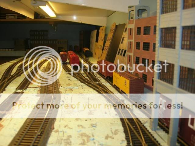

Some pictures showing the track configuration in the warehouse district:
Left end:
Further right:
Seen from the extreme right end of the warehouse district (from the River Road overpass):

Hey, hey! tucking that team track in there really does work out well
Posts: 1,049
Threads: 45
shortliner Wrote:Hey, hey! tucking that team track in there really does work out well
Yes, I rather think it will work. Thank you very much for that idea!
Also, I'd like to thank Galen for reminding me again that the double slip was fairly untypical for the type of place I was modeling.
I knew it, and had eliminated it before, but I was sorely tempted to add it again - I am glad I was able to find room for a regular right turnout (and enough straight track between the two turnouts for one of my small switchers or a 40' car).
Galen - I never replied to your question about planned traffic. I am tempted to have different railroads serve different customers, with each train moving around cuts of around 7-8 cars, with one railroad serving the barge terminal, one serving the warehouses, and one serving the mill.
