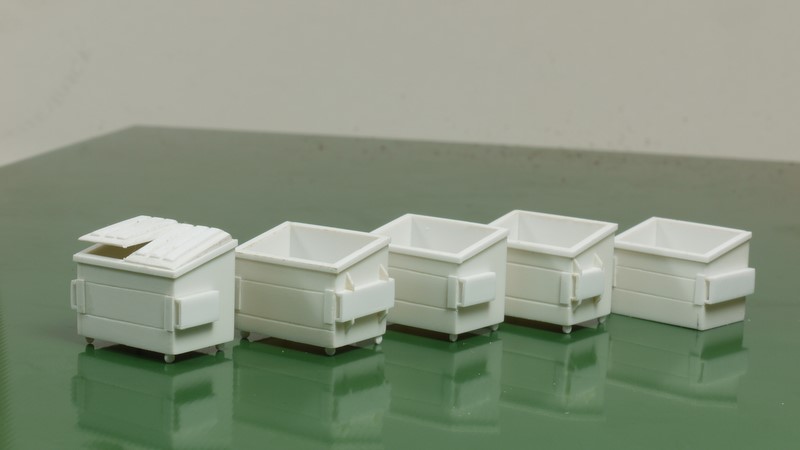

Posts: 161
Threads: 6
Joined: Dec 2010
Gary S Wrote:Casting parts is something that I really need to try. I just don't know anything about it, and have been too lazy to research it. :oops:
Ok, I just decided to get you started
I'll demonstrate how to cast a closed dumpster with most details attached. With a little bit of cheating this will be a one piece mold - which is best at the beginning.
I made a handful of dumpsters (4 cubic-yard) myself. The one at the far right (without wheels) will be the one I will cast. Need to attach a lid of course. Unfortunately, I can't meet your pace. It will take me a few days to get the setup done.
Jens
Posts: 3,683
Threads: 118
:o Woah! :o
Now those are some dumpsters! I am very very impressed, and they obviously make all my efforts look crude! Again, I am most impressed!
I definitely respect that kind of modeling, and realize that my mass production isn't even close to that standard. But most times, I am happy enough with my creations, and having to populate 170 feet of layout shelves encourages me to take shortcuts. As always, I invoke the 3 foot rule on my creations!
Definitely looking forward to your casting tutorial. Thank you for offering to do it.
Again, thanks for showing us your dumpsters. Those are fantastic, and they make me realize what can be done, and perhaps I should slow down and take more effort to keep things straight and square.
