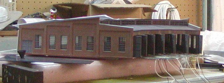

I'm posting a few pics of the roundhouse so far. This one was taken from an angle and distance that will be the best view of the interior once it is in place on the layout. You can actually see in better than I thought from the front. I just have paper where the roof will be to block the light, so when the actual roof is in place, it should be darker yet. I'm thinking a couple carts with tools and parts kept between the columns where they are not in the way when not in use would be appropriate. Not sure what else but will be happy if anyone can offer info. The rear walls on the left three stalls are just sub walls waiting for delivery of styrene cinder block sheet to laminate onto them. I have Tichy windows that fit the openings. The installation of these painted walls should darken the interior further. I'm not sure about adding lighting, then the interior detailing will be more important and I'm thinking less is better at this point, having little info.

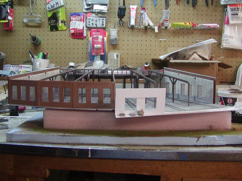

This is a pic of the other side, again it was taken from the approximate angle and distance which would offer the best view once in place on the layout. If I were to move to my left, my view would be impeded by the corp. office bldg. The rear of this wall will be extended out 3" with the cinder block extension.

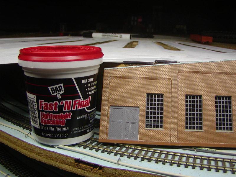

I don't know if this will work but I thought I'd give it a shot. I've never been able to psot a pic of brick and mortar, it always distorts when reduced enough to post here. So, I trimmed a original 1600x1200 pic to show just a small section of it, without any reduction in size, if that makes sense. Let's see if it posts clearly. This motar was done with lightweight spackle. it goes on easy, rubs off easily, and I think looks great, and goes very quickly. Much better than the multiple coats of thinned paint I've used in the past.

jglfan Wrote:I don't know if this will work but I thought I'd give it a shot. I've never been able to psot a pic of brick and mortar, it always distorts when reduced enough to post here. So, I trimmed a original 1600x1200 pic to show just a small section of it, without any reduction in size, if that makes sense. Let's see if it posts clearly. This motar was done with lightweight spackle. it goes on easy, rubs off easily, and I think looks great, and goes very quickly. Much better than the multiple coats of thinned paint I've used in the past.

Hmm...spackle. Never thought of that, GREAT idea!

Thanks for the kind words Tom. The kit is by Walthers, their # 3041. I can't wait for that cinder block sheet so I can finish the roundhouse. I like modifying kits to make them a bit different, and I needed longer stalls for some of my larger steam locos. Sounds like there isn't a lot of interior details to worry about. Fine by me, I've got lots of work to do on the scene anyway! Here is the spackle I used, in the past I had tried the vinyl type spackle and that didn't work so well. The wall section in the pic is the one my small pic above came from.

Speaking of spackle, I started using that awhile ago, and I really like the look of it. Much better than washes IMHO.

[quote="j Here is the spackle I used, in the past I had tried the vinyl type spackle and that didn't work so well. The wall section in the pic is the one my small pic above came from.
[/quote]
I think I may have tried a vinyl spackle in the past. I wasn't too happy with the results and it photographed shiny! I'll try the kind you use!
Thanks for the tip!
