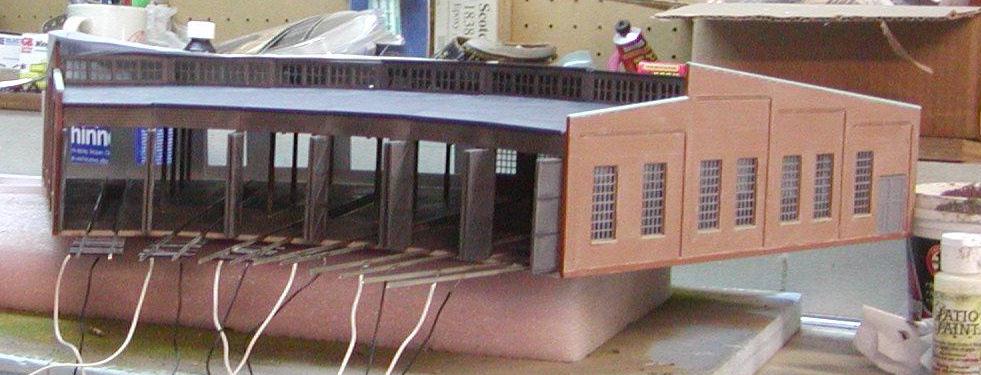

Hi Matt,
I missed this thread until now, I was working on a Walthers Roundhouse at the same time. They do make more than one, is yours the same as mine (pic below)? If so, you have the interior roof braces you need, as I also bought two kits to get six stalls. I'd love to see some photos of your roundhouse. Don't worry about those times when you can't motivate yourself to work on models, happens to me all the time, just today in fact! Usually when it comes to a point in the construction of a model where there is something tedious, or needs research. Or I'm not happy with the result I got and don't feel like doing it over. Like today! I actually went outside and worked on a stone retaining wall rather than model. And I enjoyed it way more! Oh, I didn't paint my floor sections, I just weathered them.
Take care, Gary

Gary,
It is the same one. Yours is looking great! I hope mine comes out nearly as nice. I did end up buying the second kit. As soon as I have something worth taking pictures of, they will be posted. I am knee deep in the 1:1 world as of late, which leaves little time for modeling.
