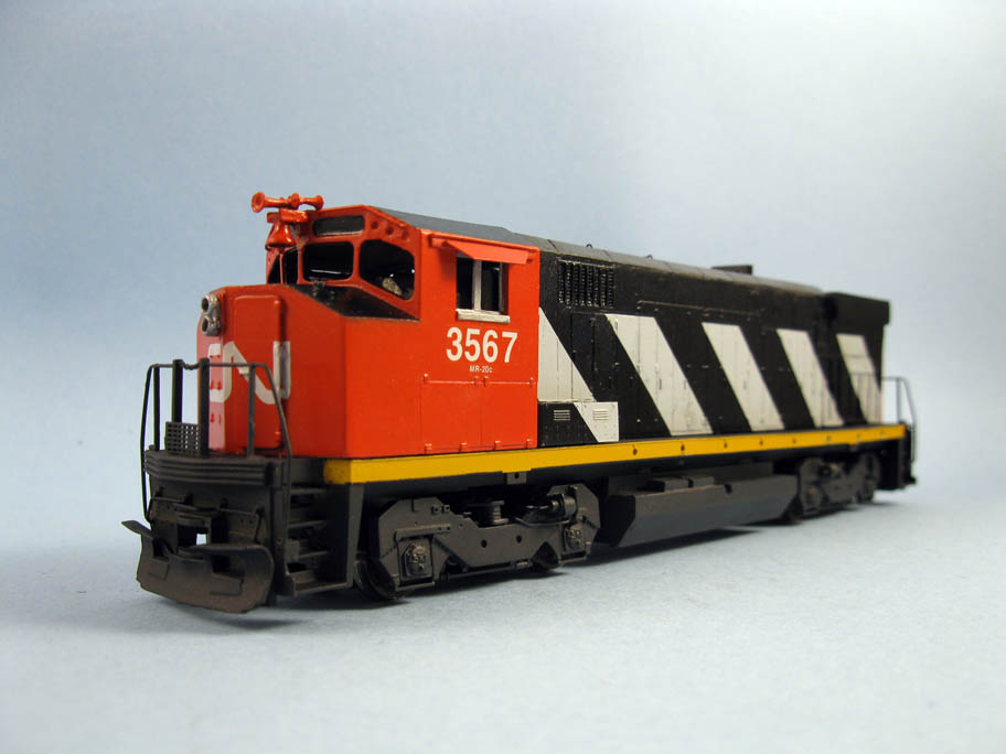

Some update. the unit is painted and about 90% decalled. I'm still trying to figure out how I'll assemble it, but it should be to hard to find out.
I'm not sure if it really looks like a M420, but at least, it looks like a MLW product! 357 Let's call it a perfect model for the 3 feet rule!
BTW, the roadnumber represent the unit that was wrecked in Charlevoix back in 1993 after hitting a rock slide and diving in the St. Lawrence river. Let's hope it won't happen (yet) on the layout!
[Image: IMG_0455b.jpg]
[Image: IMG_0453b.jpg]
[Image: IMG_0452b.jpg]
[Image: IMG_0454b.jpg]
