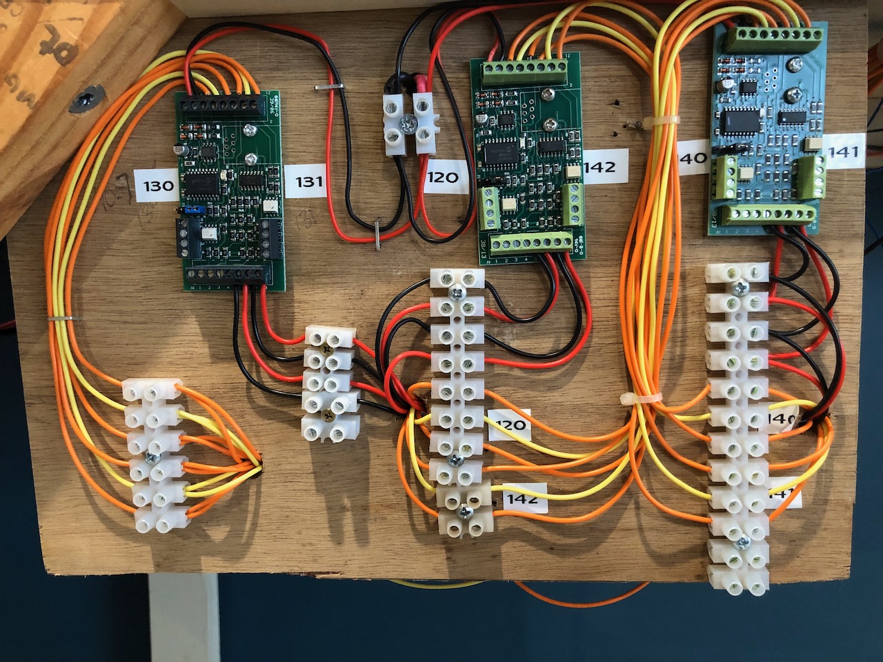

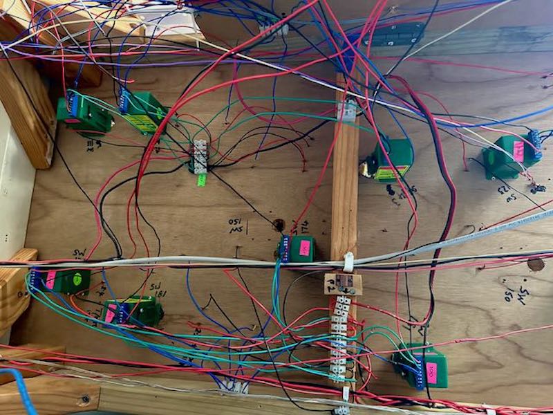

I use tortoise for DCC turnout control.
Below is a group of Wabitts that send messages to the Tortoises. Nothing unusual for DCC
Plus 2 current detection modules to detect what section of the RR is occupied
I started like most with a circle on the floor and a 12 car battery, (yep, a car battery inside  ) with a screw inserted into the casing 3/4 of the way along to make the connection to the Hornby line @ 9v. Most likely about 1955.
Life got in the way about 8 yrs later. Then Grandchildren came along, I bought a train set for them one Christmas and helped them put it together.
It stayed with us, and was brought out each visit, then they found other things to do and I stole their Christmas present.
And from a straight DC circuit train set it just got bigger than Ben Hur in a very short time. Maybe going on 15/16 yrs now it is what it is.
From DC to DCC and decoders in trains and then to Computer control, learning all the time. Mostly from sites like this and good ol' Google, because the nearest reasonable size town is 200km (120miles) away, so interaction and advice was hard to come by.
I have let a bit of magic smoke out of a few things along the way, but mostly all has been OK and the mistakes not too expensive.
When people see the wire mess under my baseboard they have a fit, but it is just progressive wiring as you know, and any modeller will tell you. One thing/wire after another.
Below are 3 "wabitts" .... each control 2 turnouts. for future reference I have put the turnout identification number next to the side which controls that turnout.
Same wiring for a hand throttle.
The yellow & orange wires go to temp. on/off switches to also control said turnouts.

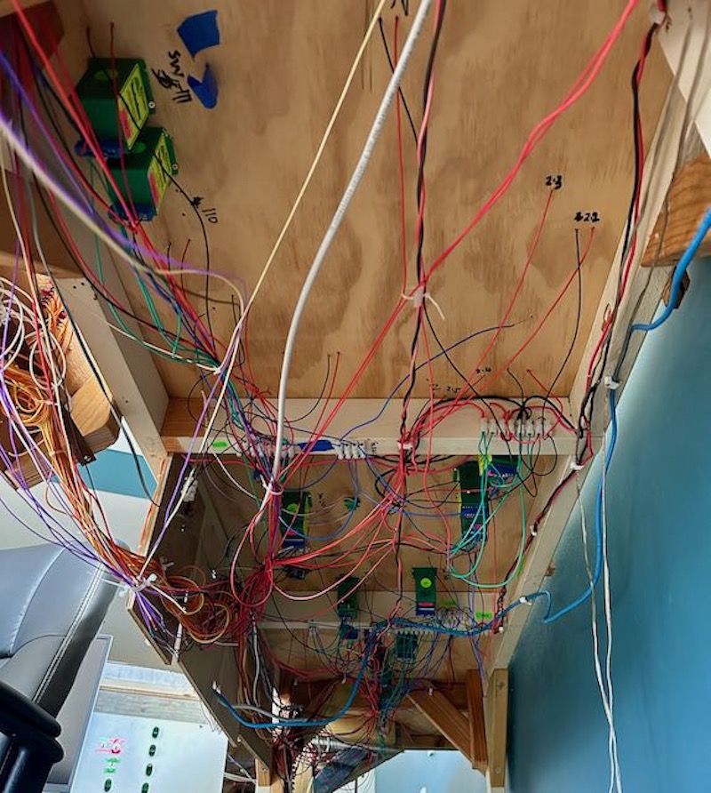

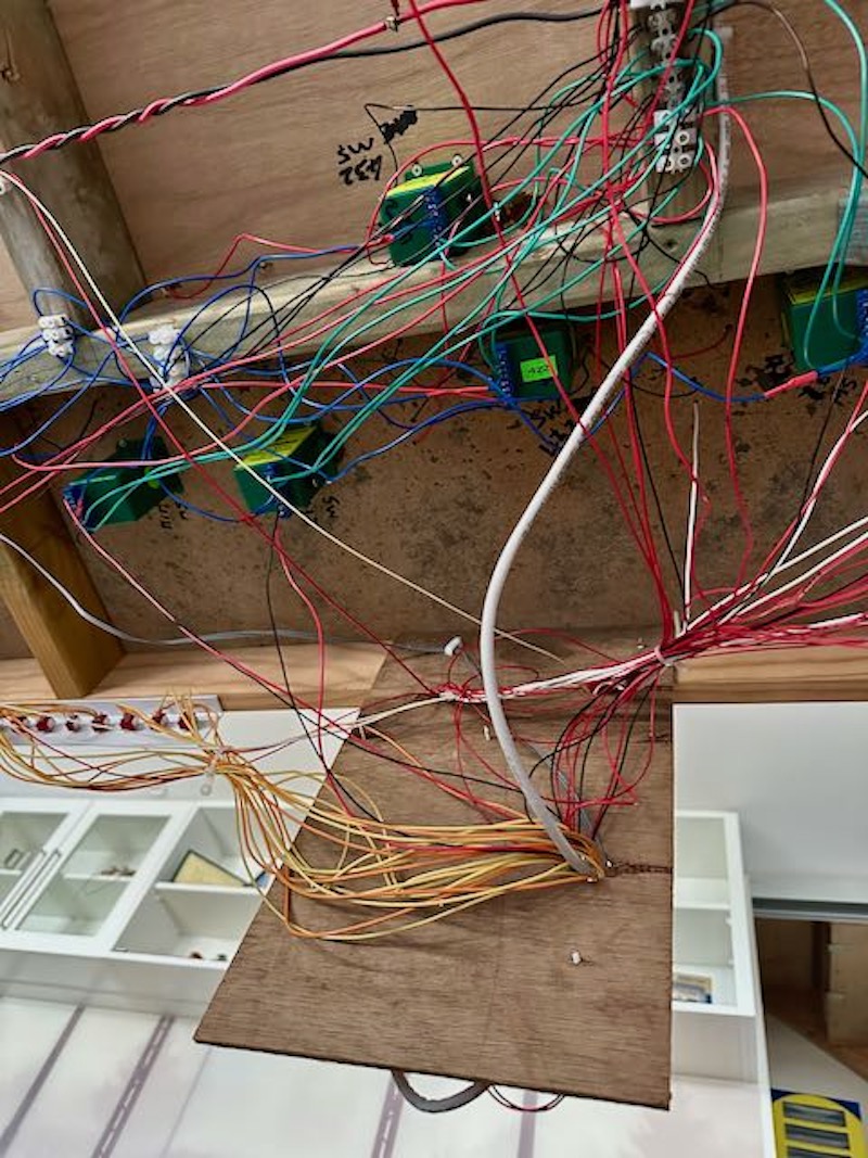

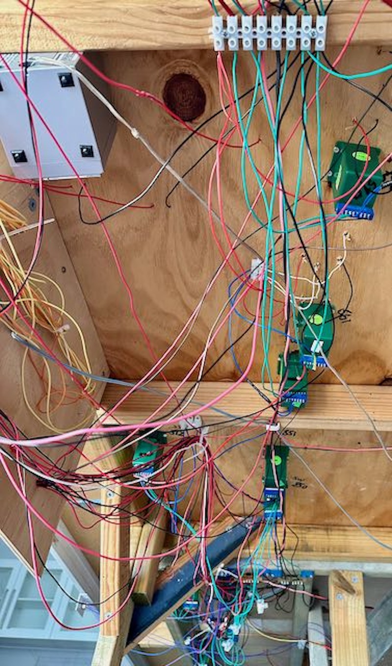

I see yours and raise you ...
Counterpunching 1,2 and 3
Besides being sloppy, the only excuse I can give is that at least I can trace any wire if need be, and when all is ok I will cable tie them into bundles of sorts. I also hear that you can get cross-talk (false indications) if wires are too tightly bundled.
That is wiring for all digital or computer controlled sound, turnouts, lights, signals, reverse loops, turntable, block detection.

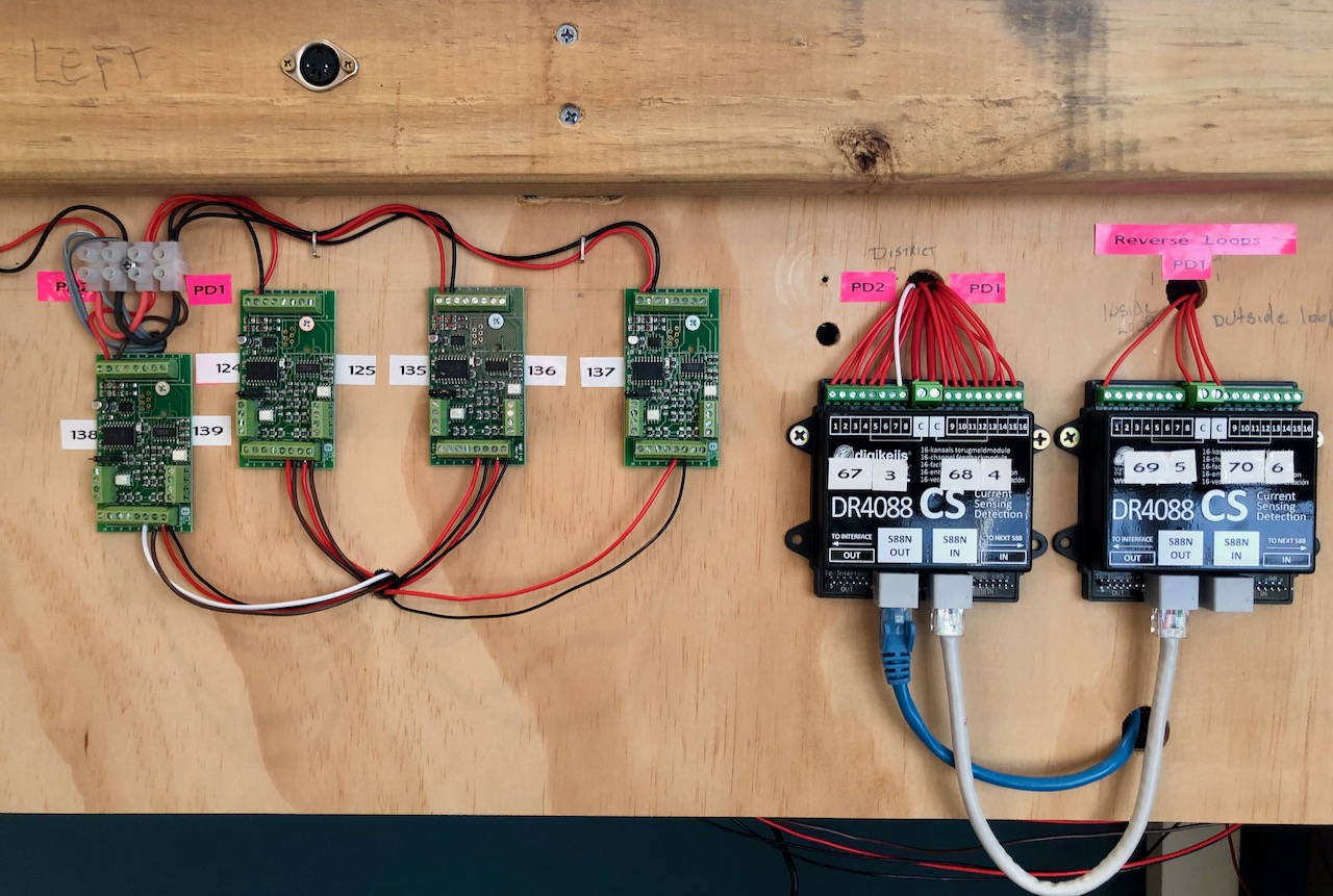

If you have a DCC controlled RR with electrically controlled turnouts then the only other thing required to run your trains by computer with a Digikeijs 5000 controller (or any other DCC controller) is to divide the layout into Blocks, or sections, using insulated rail joiners. It is preferable to have these sections or Blocks as long as your longest train although not mandatory.
One of your BUS wires makes a deviation to go through the Feedback module.
Then wire in detection and feedback modules of choice (A DR4088 gives feedback from 16 Blocks and about $60 US)
This will have no impact on running trains with your DCC system if you don't have it connected to a computer.
Most of my "Blocks" are the section of rail between two turnouts, so as long as the same side of the rail is isolated (you only need to isolate one rail) that the detection module is connected to then that's all that needs to be done. See 1st diagram
The computer needs this information to see where your loco is. These modules work on current detection, so if something is drawing current on that section be it loco or lighted carriage then the Computer knows about it.
