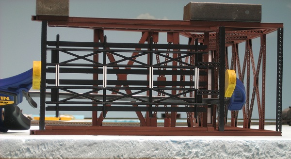

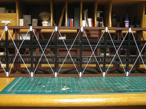

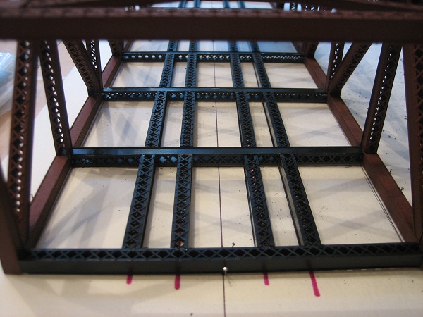

I resumed work on the bridge (DH draw) yesterday. I started adding the bottom to the bridge. My first idea was to use brass stock for the decking for strength, but after my load test ( up to 6 pounds ) I realised that It's not necessary and would just add extra weight. So I went back to the Central Vally girders that the rest of the structure is built from. To insure a good glue bond, I sanded some of the primmer away where the new parts met the old ones.     this shows all the cross braces in place on the lift section.

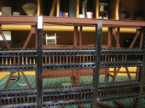

In this one I have started on the tower section that will cross over the PRR trackage.     It's two bottom sections of the through truss bridge that I used earlier on the tower spliced together. when these two are dry, I'll get to some more bracing.

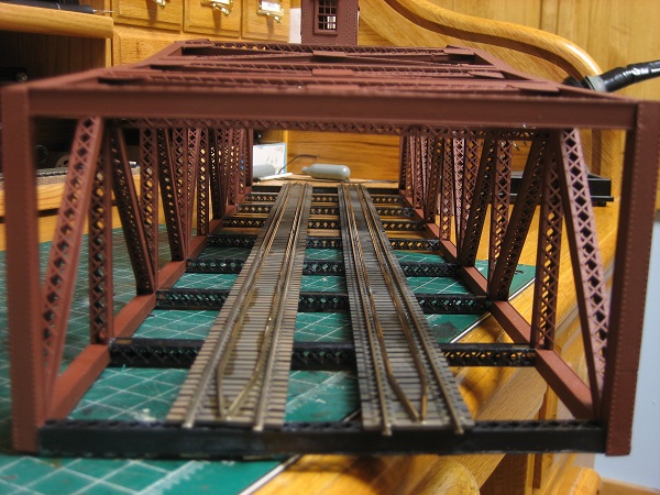

First off, I measured, measured, and remeasured where my tracks were going to be located and then measured yet once again, (just to be sure). Once I was satisfied with the location of the mains I drew them out on the Foam board that I had used earlier. This gives me a good visual reference to where they are in relation to the center line of the bridge, In this case, the lift section.With a few pins I tacked down the movable section to the board and added girders to support the ties and track.
Each one was carefully cut, filed and glued in with CA to insure the tightest fit possible.( I really want to avoid having A heavy mike or train master splashing down into the river.

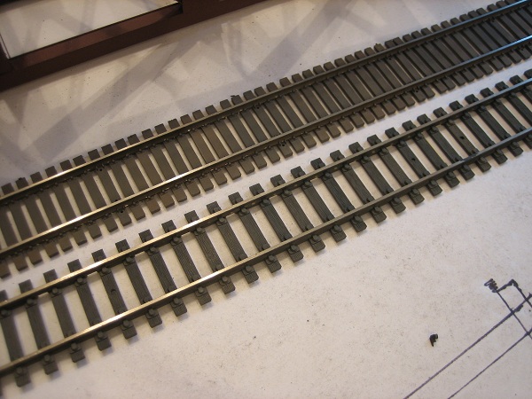

While that dries I went to work on the track...In general, the track that crosses bridges has a closer tie spacing than other track. My solution was to flip the track over and cut out the tabs between the ties on some flex track and slide them closer together. This pic shows the finished product compared to a standard section of track.

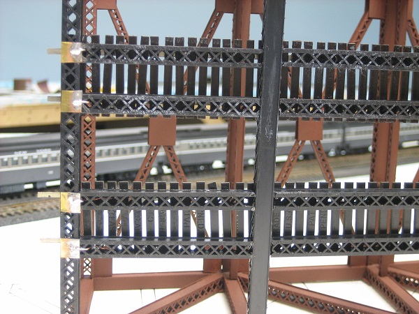

With that finished, the track was centered and secured to the bridge with more CA. Because this section will be movable I needed a way to get power to the rails. Feeders were soldered to the rails and then soldered to brass shims glued to the under side of the bridge with,,, yet more CA. When the bridge is in the closed position they will make contact with some other live contacts to complete the circuit. This was done at both ends to insure good power to the lift section.
As I said before the thought of some locomotive crashing into the river below is something that I want to avoid. To add a little bit of extra insurance I added some extra bracing to the bottom of the bridge. The joints where the frame meets the sides of the bridge are the weakest link in the build. In order to add some strength here I cleaned off the primmer to allow for a solid bond and glued a strip of plastic across the seam using a strong solvent cement. Each seam got the same treatment.     This pic shows a before and after of this step, this should add plenty of strength to the lift section.

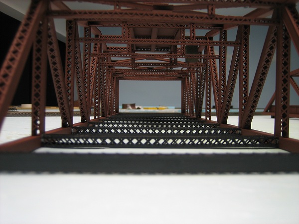

The last detail that I wanted to add to the underside of the bridge was some thinner cross bracing. I used this image of the CNJ's Newark Bay Drawbridge as a guide.<!-- m --><a class="postlink" href="http://lcweb2.loc.gov/cgi-bin/displayPhoto.pl?path=/pnp/habshaer/nj/nj0800/nj0876/photos&topImages=112212pr.jpg&topLinks=112212pv.jpg,112212pu.tif&title=10.%20%20DETAIL%20VIEW%20OF%20FLOOR%20SYSTEM%20FOR%20210'%209'%20LIFT%20SPAN%20%3cbr%3eHAER%20NJ,7-NEARK,16-10&displayProfile=0">http://lcweb2.loc.gov/cgi-bin/displayPh ... yProfile=0</a><!-- m --> I didn't want to put too much detail into it as it can only be seen when the bridge is raised, and even then, it's still not too visible.

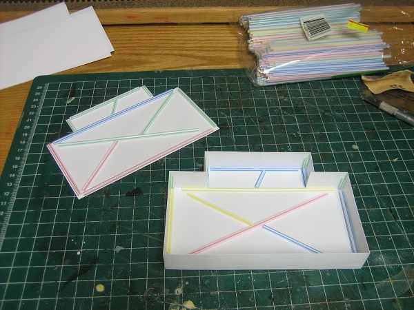

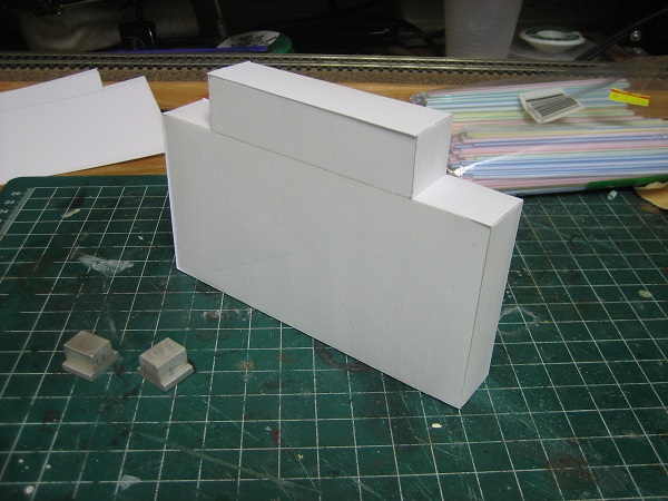

after that I started on the counter weights. Once again I went to the library of congress web page for Ideas. I used the same prototype for inspiration, <!-- m --><a class="postlink" href="http://lcweb2.loc.gov/cgi-bin/displayPhoto.pl?path=/pnp/habshaer/nj/nj0800/nj0876/photos&topImages=112217pr.jpg&topLinks=112217pv.jpg,112217pu.tif&title=15.%20%20DETAIL%20VIEW%20OF%20MAIN%20AND%20AUXILIARY%20COUNTERWEIGHTS%20FOR%20299'%20LIFT%20SPANS%20%3cbr%3eHAER%20NJ,7-NEARK,16-15&displayProfile=0">http://lcweb2.loc.gov/cgi-bin/displayPh ... yProfile=0</a><!-- m --> I did change the look a little but you can still see the similarities.     They were cut from some .015 styrene and braced with plastic straws on the inside.
Here is the almost finished product of one of the main counterweights. I added the small aluminum blocks on the left to the inside of the weights. This added some heft to the otherwise light box. I felt it would help to keep the "wire rope" stretched when they're installed.

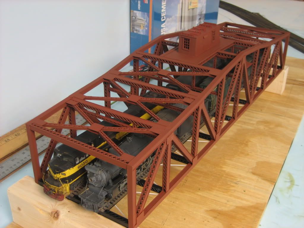

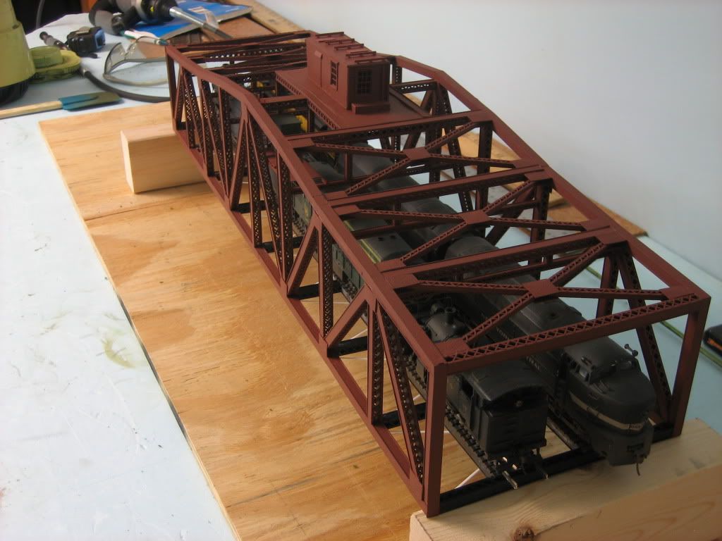

I did my final load test today. I supported the lift section from the ends, just like it will be when installed. To simulate a good load I piled as many of my heaviest loco on the rails as I could fit.[Image: 051.jpg]
[Image: 053.jpg]
[Image: 052.jpg]

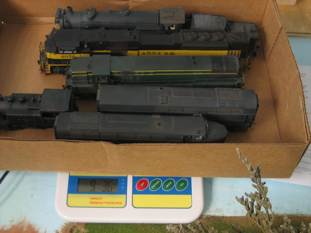

[Image: 054.jpg] The grand total came to ..........9 pounds, 3.6 ounces. I'm no longer worried about the load carrying capacity of the bridge..

E-paw....Do a flex test by placing your heaviest loco right at the center of the span and measure the distance from the bottom of the girders to your base at this point. Compare this measurement to the distance with no load on the bridge measured at the same point. Even a small deflection can cause electrical pick-up problems...

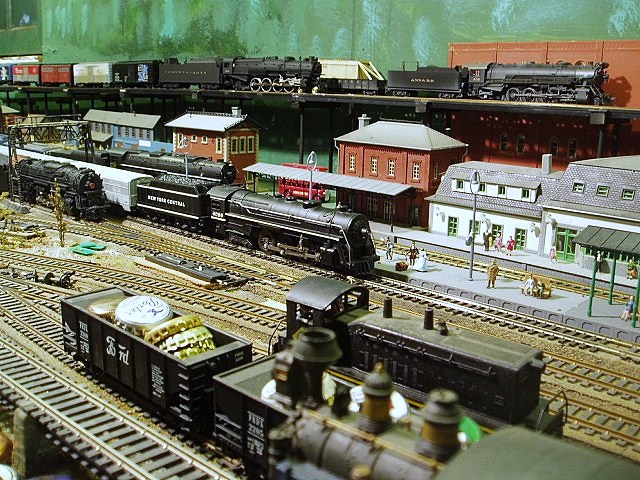

steve ; Do you remember us running 2 Penn-Line decapods doubleheaded on the basement elevated track and the way that track would flex. That put a load limit on the upper lines. I never did strengthen that section.
* Something you will recognize. A ANNA Mountain fully detailed on the elevated lines, with a Bowser Mountain on the second track.
