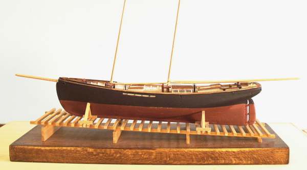

Here are some of the ships/boats that are on the old module set:

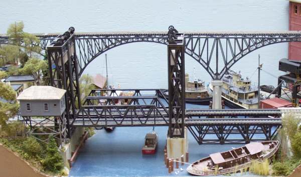

Sumpter250 Wrote:and last, a zoom in on the rolling lift bridge....this one an old Heljan kit (one of many, as the tool went from one company to another)

The boats are beautiful, there is no doubt ... but my question has to do with the lowly Heljan Rolling Lift Bridge. :o :oops:
I have the AHM version of this kit (at least it appears from where I sit to be the same kit) and I was just wondering if you have installed it in a fixed, stationary position, as a manually repositionable bridge, which may be moved to the open position for photography, or if you went "all the way" ( 8-) ) and used the honky little motor that was available to make the bridge truely operational. Initially I had assumed that it was a fixed, stationary bridge, but not wanting to be too presumptuous, I thought I would ask.

I tried to get the photo to show up, but....
If the thread is to have any educational benefit, some discussion should be included, about alternatives.
I had originally intended on having the rolling lift operate, and then thought about all the fingers touching it, and probably moving it just enough to have rolling stock crash to the floor.
It's removable ( spans a module boundary ),and could have still been, and been operational, but is now rail-joinered in, to keep it from being moved while in use.
On a home layout I'd have it operate.
Wood truss and steel rolling lift......I'd call the combination.......improbable.
There may very well be a situation where that combination exists, but it would be a rare case at best. Bringing the rails out on a wood trestle, ending at the stone abutment that supports one of the standing ends of the lift bridge, is plausible for the specific scene, but deck, or through, girder bridges might have been a more commonly used method.
The location of your railroad, is probably the most controlling factor in what engineering would be used.

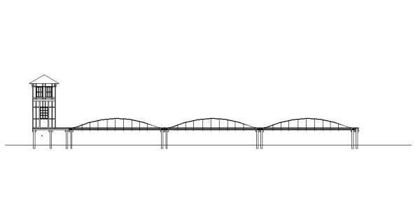

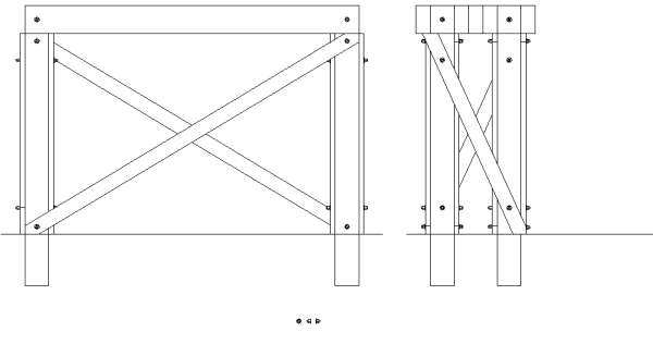

As things are progressing, I began thinking that there's too much "stonework" already, so I decided to set the "Eureka bridges" on pilings, instead of stone abutments. This is what I'll build.....there will be four sets. The distance from the waterline to the top of the bent is 8' ( scale ). The actual distance from the waterline to the bottom of each pile, is 1/4". I can drill through the 1/4" plywood "water", and glue "stops" on the underside, that way I don't have to worry about the depth of each hole. The bents will then be glued in, and the bridges set.
The piers may seem light, but it is, after all, a walk bridge, and won't be carrying that much weight.

This is the scale drawing, converted to jpg format. The view from above will be used to set the holes for the pilings of the bridge bents, both on the modules, and for a building jig.
Now the "design work" is done, time to build bridges!

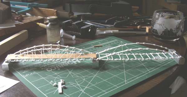

Progress on the second of three walk bridges:
Here are the first build ( still unpainted ), and where the second build is now.
The vertical hangers, and the angular bracing are next, then the deck.
After that is done, the third bridge, the wood piling bents, roofing and details on the bridgetender's shack, paint, weathering, and installation on the modules.
