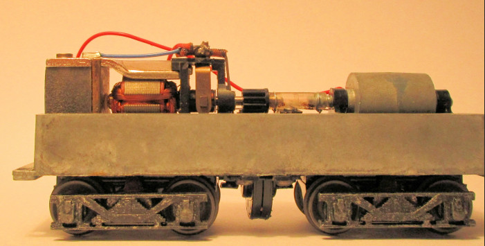

What sort of drive does the box cab originally use? If it is like a blue box Athearn drive, you might be able to just replace the open frame motor with a can motor.

Russ Bellinis Wrote:What sort of drive does the box cab originally use? If it is like a blue box Athearn drive, you might be able to just replace the open frame motor with a can motor.
The original drive is via a vertical multi-stage gear train, and then via Jackshafts to each bogie - it makes the most dreadful grinding noise, amplified by the bodyshell - much better to do as Reinhard has done and use a GE 44-tonner chassis, or as I did, by fitting a modified Bachmann Underground Ernie chassis.

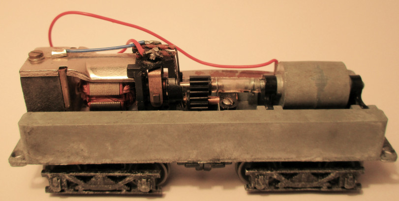

I went a bit more radical with the repowering of my boxcab/ climax:
[Image: 002_zpsx5xi7uqh.jpg]
I converted it to a band/pulley drive. I machined the chassis flat and replaced the motor with one out of a VCR. I removed all the gears out of the tower and made the large bull gear into a pulley by chucking it on a friend's unimat lathe. The rest of the drive is original but with the main gears gone, plus the tension on the bull gear to keep it from rattling, the drive is considerably quieter, more like an athearn blue box growl.
