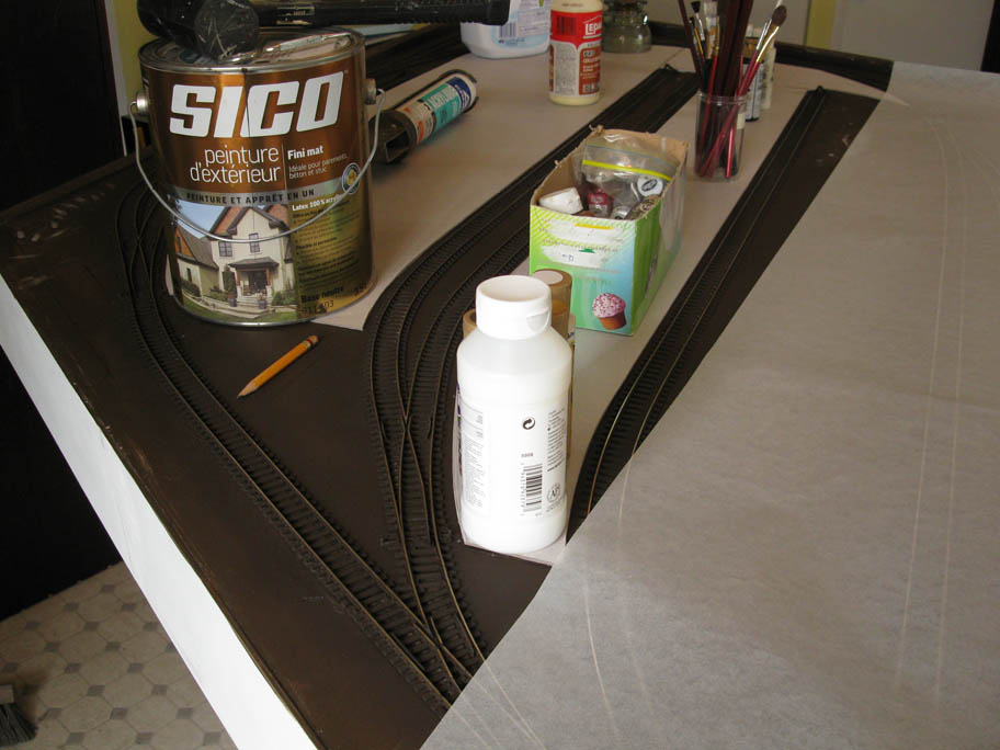

Today I started to lay track at 7AM and ended at 7PM, including about 1 hour break for lunch & diner. I'm starting to think Reinhard is a superhuman! How does he have such a constant and intense modeling output mesmerize me!
Track was glued with latex caulk. It went surprising fast. I'm glad to have bought a long aluminium straight edge. So far, it's been my best purchase of the year. Can't believe I lived without one for such a long time.

In some spot, mainly near the carfloat apron, I used 5-minutes epoxy because radius is very very tight. Small brass pins were inserted into the concrete wall to make sure rails would stay aligned.

I'm quite proud of the final result. It took me about 5 years to "complete" this project since my first attempt was kindly published by the late Carl Arendt, but I'm glad I started over. The actual layout is probably among the most accurate rendition of this small terminal and it's fun to see it taking shape. I did some operation and was happy to find out my trusty Atlas S2 was able to navigate the very tight radius, some less than 12 inches.

I took some minutes to test and operate the layout. I can already say it will be a very fun small layout to operate. Next step is to spray paint the track before moving to scenery.

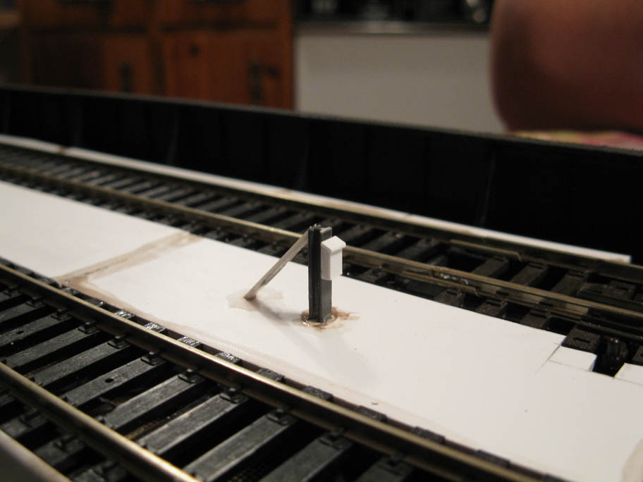

Today, I cut and installed the concrete pads. These were made with 2mm cardboard. Quite thick, but cutting was far easier than I expected. It took me all day to prepare them. Next steps is to add the concrete curbs per prototype and paint them. It's going to be tiresome... but once done, the most annoying model railroading activities will be behind me as I'll venture in real scenery works, which I rarely do.

A cut-to-lenght piece of MDF plinth was used to make the concrete abutment supporting the bridge hinges. Fun how the most unlikely materials end up having a second life.
