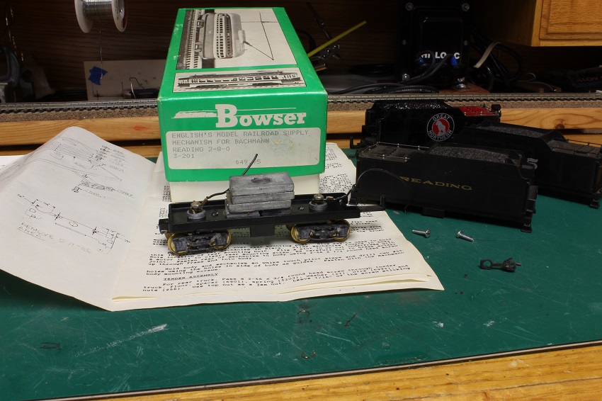

So, for this weeks TT I am starting a project that I have been wanting to do for a while. Not long ago I picked up a Bowser repower kit for a Bachmann Reading 2-8-0 from Flea-Bay. It's one that someone had already started ,,poorly that is. It's a good thing that over the last few years I have been collecting a bunch of downer engines for this project, as I will need the extra parts.
I will cover the build of this tender in this thread.

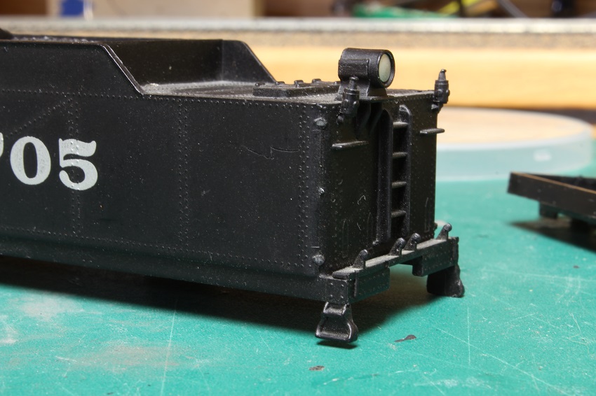

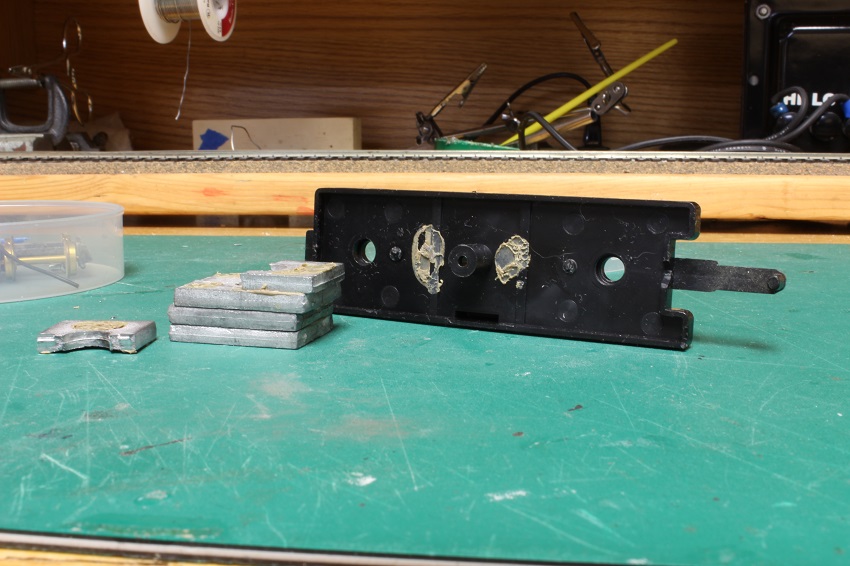

And so it begins. The started tender is disassembled and given a once over to see what can be used and what will be replaced. It looks like the molded on details will be removed along with silly draw bar system that they used. I think that I will also replace the weight, and add directional lighting to this tender. The fake coal load will have to go too.
I went with the tender marked with the number 705 as it was in the best shape. I will smooth out the flash that was under the grabs that I removed. I also cut away the molded on cut lever, I hope to reuse the supports. I am trying to figure out a way to remove that ladder without doing any damage to the tender body.
I don't know what this person used as glue but it has never fully hardened and the weights are broken and held together with it at all sorts of angles.

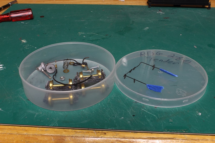

I store all the small loose parts in these containers, they are from rolls of 3M electrical tape that I mark with the projects name. As an electrician, I have dozens of them handing around.

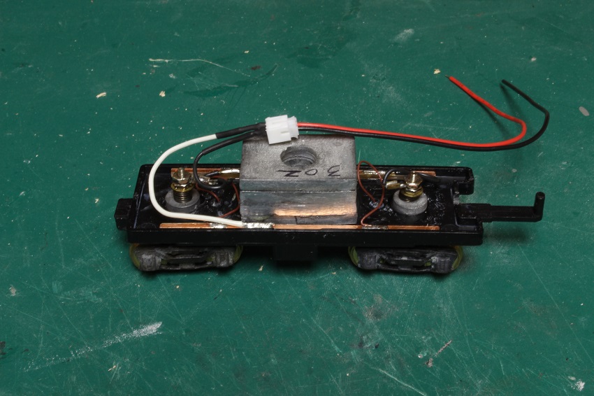

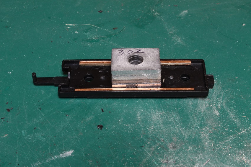

I did a little more work to the frame, weight, and tucks.

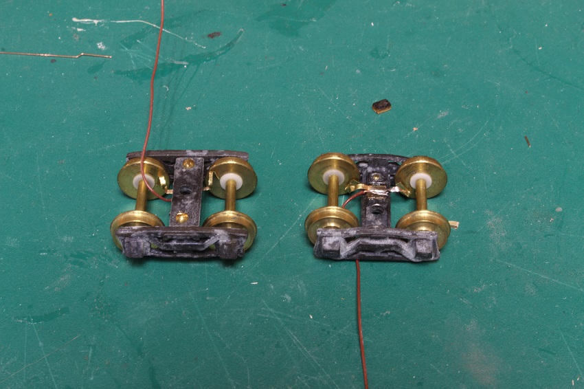

We now have all wheel pick up on this tender.
I separated all the sections of the weight, cleaned off the old chewing gum like glue, and reattached them with CA so that they were as straight and even as possible. I also added two strips of PC board to act as buss bars to solder the pickup, lighting, and engine feed wires to. The PC board should help to stiffen up the frame.

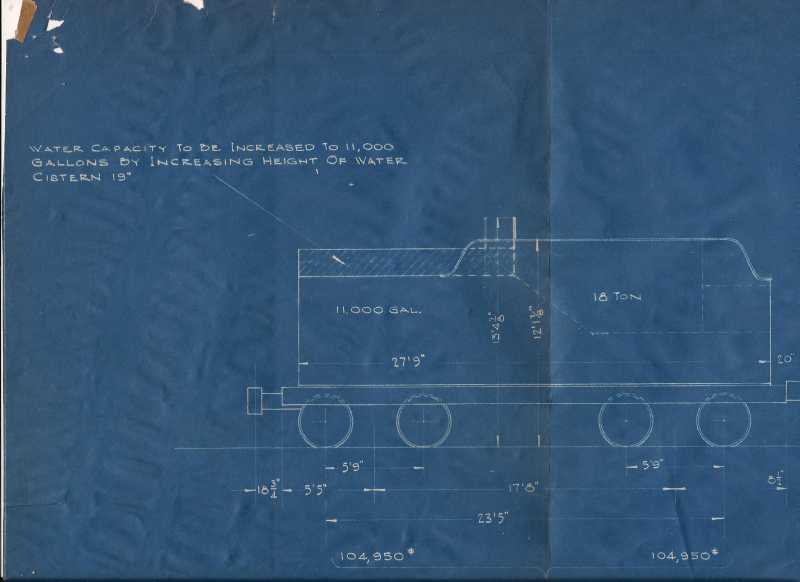

Today I have a few more pics from the workbench of the Reading tender. But first I have something from the ARHS Yahoo group that was sent to me. It's a scan of a Reading blue print showing a modification done to the I-10 tenders that were surplus after they were converted to T-1's. These tenders ended up going to the RDG's M class 2-8-2's
I have now soldered up the rest of the pickup system and installed the trucks as seen here.

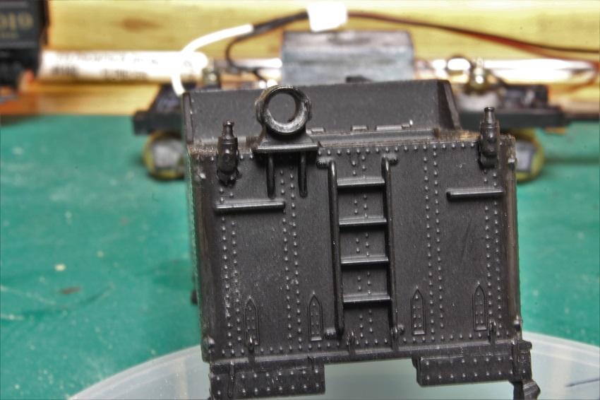

The backup light was drilled out for the installation of a LED lamp. All those molded on rear grabs and ladder will have to go, but I'm worried about breaking off a step or two as I work. Hmmm, what to do ?

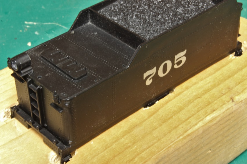

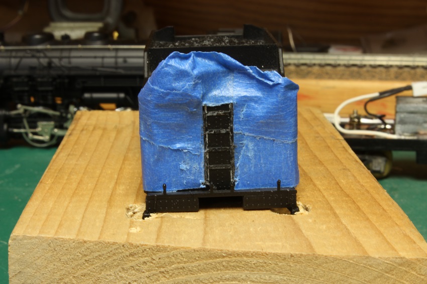

Here is my solution for detail damage control. I drilled out some holes in a scrap 2x4 that the steps and toolbox can fit into. Now the body rests on the block of wood and not on the breakable details.
With some masking tape guarding against a misfortunate slip of the knife I can now carve away.
