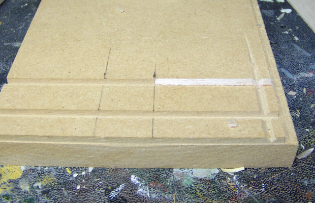

Thanks guys, what could be more simple than  a groove. I like it because the MDF doesn't want to cut along with the wood stick. The stick has a tendency to flair up on the ends, but they'll get cut to size anyway.

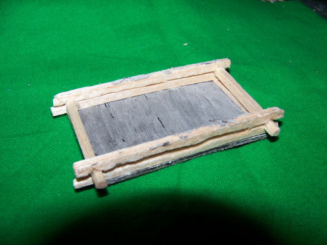

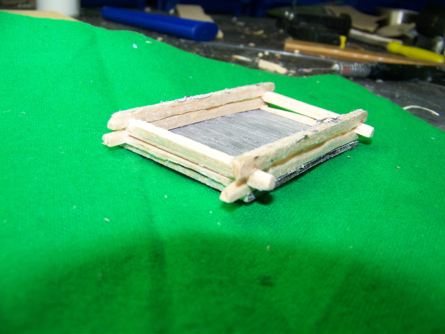

Hokie, dokie, I surrender. I've made about four different cutting jigs for my stick logs and none of them work because of the inconsistencies of the sticks (thickness, bends). That, plus the tendencies to split rather than cut clean has driven me two steps closer to hitting the bottle. I have a different plan now for those sticks, so Jim, they will not go unused, think Piece en Piece, (a no-notch cabin building technique).
My new plan for the cabin logs is to go with balsa wood. I made a cutting jig in about 20 minutes that I can cut the logs to length and get consistent V notches at the ends without anything splitting or breaking off. The downside is that I will have to stack the logs as they did back in the old days, one log at a time, but I think that will be fun.
So, here's what I'm going to use to notch and size the logs, then stack them. The male part of the notch is cut with an Xacto knife. So, lets see if I can make progress this time.

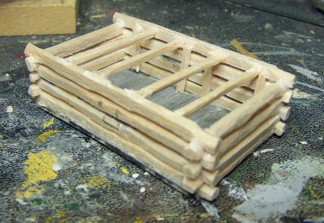

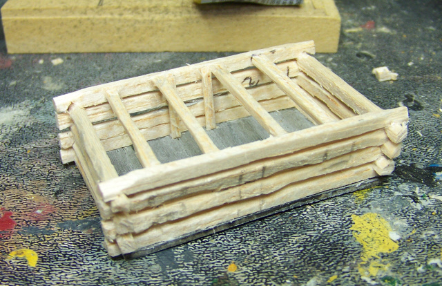

Here's some shots of my first full course plus the inside first floor.
#40
Got the first floor done, put in the beams for the attic floor, but then decided I should go for a two-story. According to the "Barnwood Builders", I should have a Summer Beam running long wise to support the second floor, but since it won't be seen, I surely don't need it. Not all log cabins have a Summer Beam anyway, this one doesn't... Nope Unlike how the pioneers did things, the door and windows will be cut in later. Since this is my first log cabin, I'm going to take the easy way.

I glued backup strips behind the window and door edges so the logs will stay in place. I have a #15 Xacto blade which has a very narrow saw edge that will cut them out. I need to find the right door and windows before I start cutting. That is going to be the nervous part.
