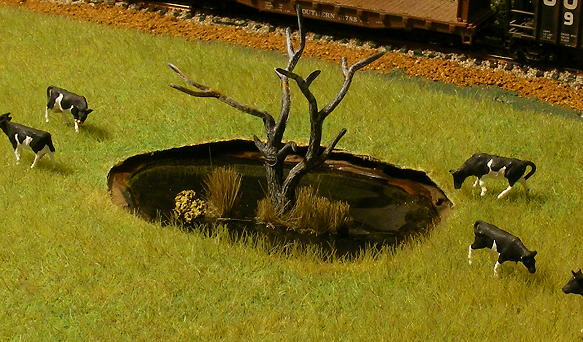

Well I added a dead tree and some reeds/bushes and we had some rain which greened up the pasture some. The pasture still isn't glued down and I will have to blend the edge of it with the edge of the water when I get that far.
The addon in the pond looks very good. I would suggest to cut back the pasture to have a brown ring of mud around the pond about the size of 1.5 cow length. The hoof of the cows destroy all kind of vegetation while drinking from the pond and a pure mud area is the result.
The dead tree, and the grasses growing in the shallow pond, are almost exactly what one would expect.
The low ground stayed wet, and the tree flourished, until time changed things and the water got deeper. The regular visitation from cows could have had a major part in the change. Most trees need water, but don't survive their roots, and/or their trunks, being constantly wet.
I would think that after time, the mud would exist in "patches" around the pond. There would be places where the cows would choose not to "stand and drink". They might, for example, be uncomfortable with their backs to the rail line,... or any possible direction that predators might approach from. ( Yes, my mind does work that way ) Wink Smile
I remember lots of these small round "ponds" out on the east end of Long Island. They were called "Scuttle Holes", and were merely depressions in the land that were lower than the water table height. They stayed full, year round.
In areas of Hills or mountains, they could simply be low areas that filled with rain run-off, no springs, or streams, connected with them.
Thanks Reinhard, right now I'm trying to figure out how to model N scale cow patties Eek . Pete here we also have "wet" springs that cause these depressions and keep water in them in all but the driest time of year.
On a side note when I first poured the pond I used gloss medium but it had too many ripples when it dried so I poured a layer of WS's realisitic water over that but it did't hide it all. After I had painted the bottom of the pond I went over it with chalks to blend in the colors. Turns out gloss medium and WS's realwater don't bond to chalk so I was able to pop the "water" right out of the pond without damage to the scenery base! 2285_ I then repoured with the WS's realwater. Another note is that either product and every other product I've ever used to do water "creeps" up the scenery so this time Thumbsup I poured the water and let it cure then added the bushes, dead tree and what have you and have no unsightly "creep" to contend with.
Looks good ! Thumbsup

Tyson Rayles Wrote:On a side note when I first poured the pond I used gloss medium but it had too many ripples when it dried so I poured a layer of WS's realisitic water over that but it did't hide it all. After I had painted the bottom of the pond I went over it with chalks to blend in the colors. Turns out gloss medium and WS's realwater don't bond to chalk so I was able to pop the "water" right out of the pond without damage to the scenery base! 2285_ I then repoured with the WS's realwater. Another note is that either product and every other product I've ever used to do water "creeps" up the scenery so this time Thumbsup I poured the water and let it cure then added the bushes, dead tree and what have you and have no unsightly "creep" to contend with.
That's a good looking pond, Thumbsup the only thing missing is a few cow patties. 357 I bought a couple of cans of two-part casting cement to use if and when I needed water. Two years later when I needed it, I found that this stuff will harden in the can even when it's sealed. :o The pond was small, so I wound up using some two-part clear epoxy since the nearest LHS is a 15 mile drive from my house and Ace Hardware is just down the street. When it dried, it left some natural ripples, which was good, Smile but like you, I did get some of that creep that I had to deal with afterwards. Sad
That "Creep", is "surface tension", and is the same thing that causes water to "bead".
I'll ask the *Dumb Question*: Has anyone found a viable surfactant for two part epoxies ?
