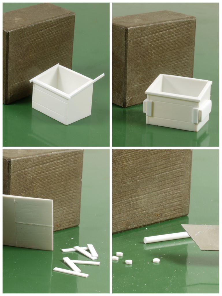

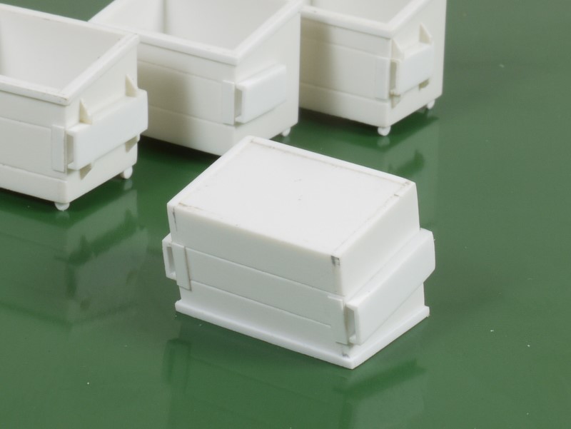

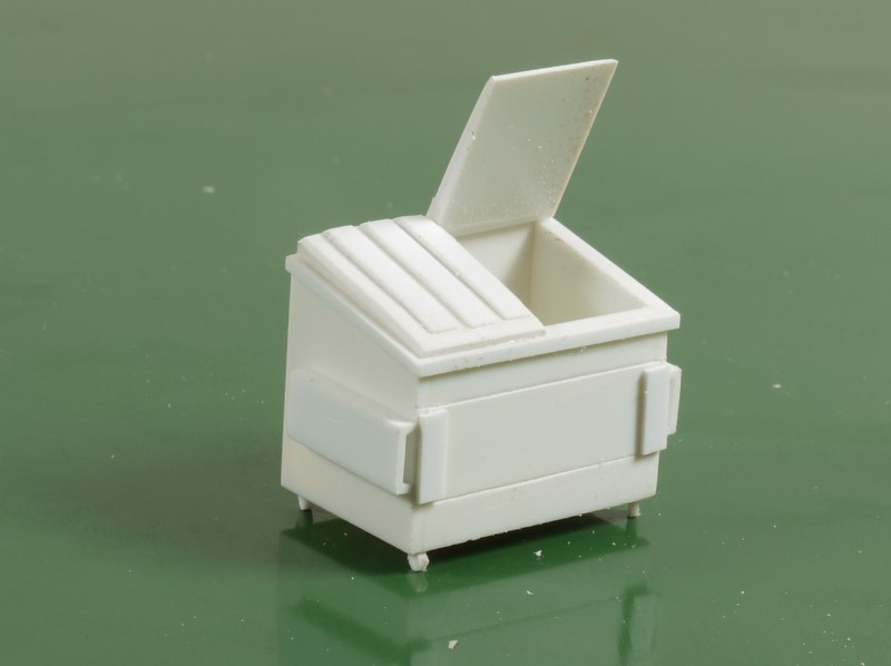

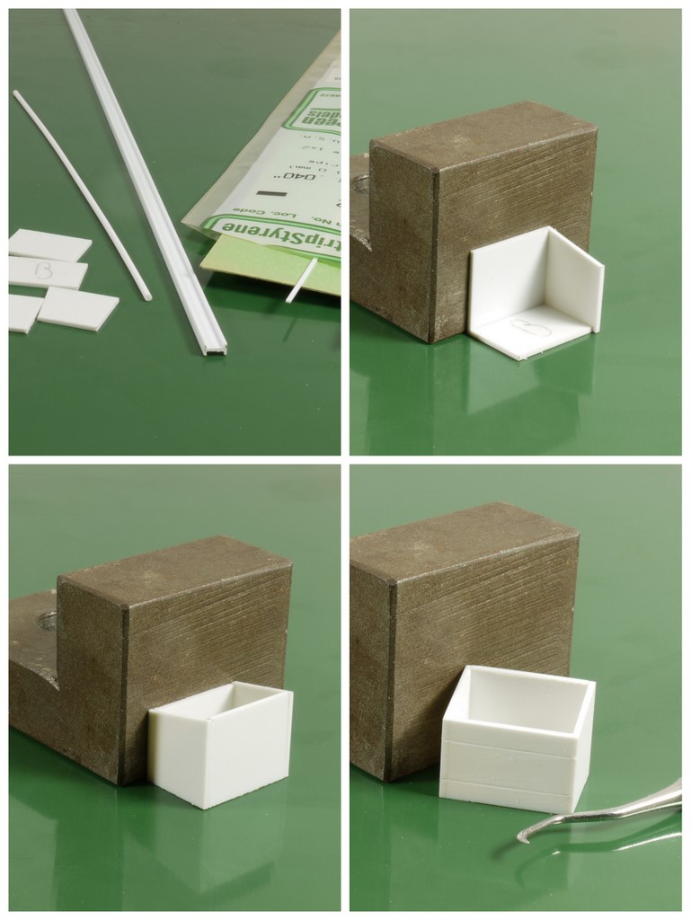

Gary S Wrote:That's the tutorial I want to see! You'll get the tutorial tonight, I just came back from work. At first I need a fresh coffee.... Quote:How do you make the joints so perfect? How do you cut the styrene so squarely? Shown below is one of the dumpsters I made on Sunday. This is what my joints look like. I cut every piece sligthly larger than needed and let them overlap a lil' bit while gueing them together. Then I use putty (grey) and sanding paper to give the model a smooth appereance. I dont think my styrene is cut extremly square. I mark the shapes on the styrene sheet with a pencil and cut it with a ordinary cutter. I don't even use a steel ruler! I just follow the line. Again, files and sanding paper does the rest. For more delicate parts or shapes I use my cnc-driven router. But I don't fire up the system for a few rectangles.

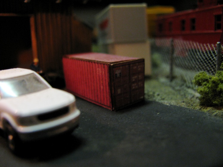

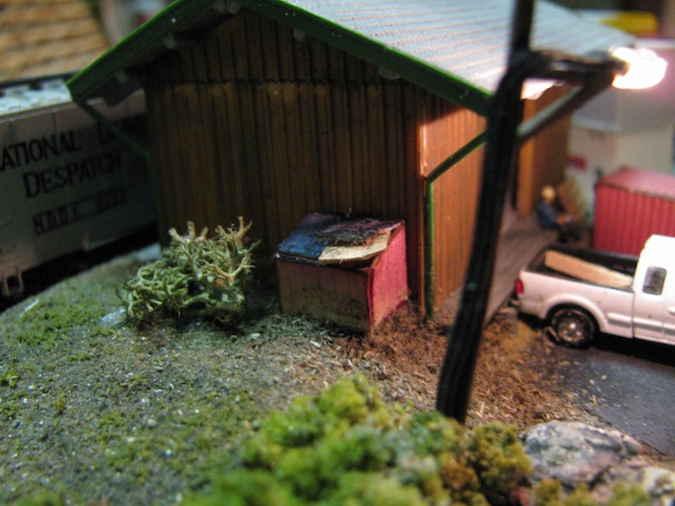

I did make a dumpster from a paper model printout scaled to n-scale as I mentioned above. Here it is (looks like the recycling company needs to pick up the contents!): And from the same sheet I also put together this container. Very fiddly cutting and folding and I didn't do that great of a job - I also realized I need to seal the paper with something so that the inkjet inks don't bleed when I use water-based scenery. Next ones will be better.
